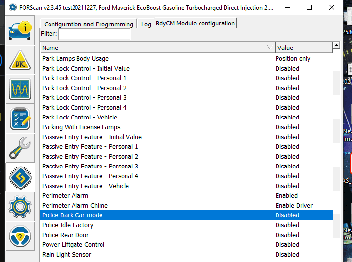

Ok, some sorta-progress. Another person on the facebook group got a beta version that has better Maverick support. I'm able to see more modules and there's some new human-readable configuration pages for the BCM and IPC.
Ford Maverick Has anyone used ForScan yet? 1640735559097
HOWEVER, the drive mode write for the ABS module still has the same problem as before.
Now that I know to not use the Forscan forums, I've sent my logs and an email to the Forscan support team. Hopefully they are able to work on a solution. In the meantime I think there's a few things I can try to mess with. Will post up anything successful.

Are you able to toggle configurations/selections from that screen, or do you still have to change the code?
I tried the "police dark mode" for fun and was able to execute a write successfully to the BCM.
However, I tried to make a couple changes in the IPC using the "easy" configurator as well as editing the values directly and both attempts failed. There's a guy on the facebook group that HAS successfully edited stuff in the IPC using this Forscan version, so I'm not sure what's going on.
