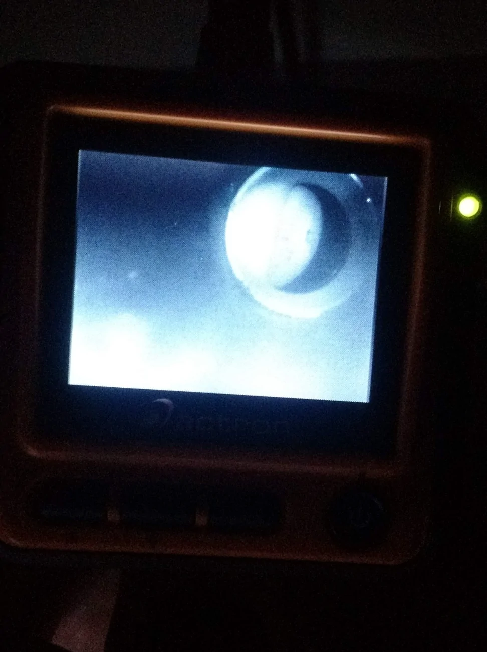

I had a similar problem like that in my Ford Windstar. Turned out to be a spider nest is my fuel filler tube. Took it to dealer and they flushed it out. Have no idea how they even got in there. If dealer would have gave me a full tank when I picked up that company vehicle they would have caught it. 😱

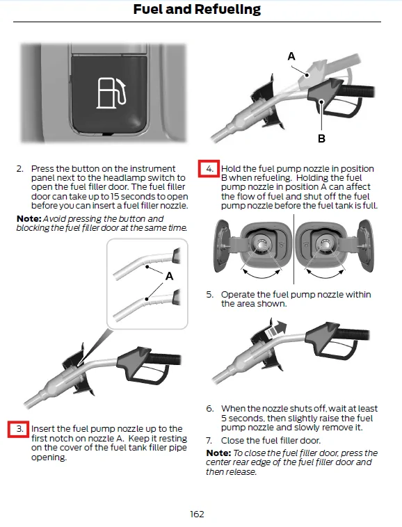

If nozzle is inserted too far the gas flow particularly at the higher speed can cause the pump to click off. Read the manual and only insert the nozzle to the bend in it. Lifting the handle too high will cause enough turbulence to click it off. Also choose the slow pumping speed when setting the speed clip.
Agree, as the manual instruction shows this in Post #7.
