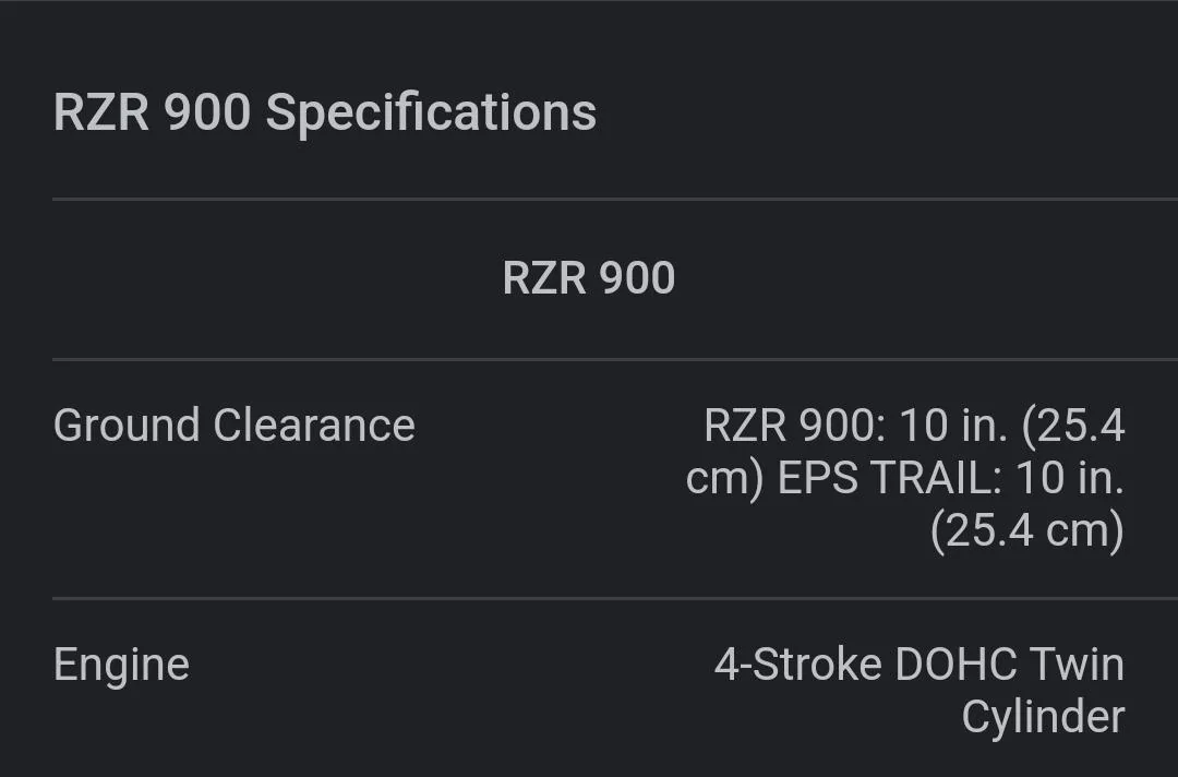

Between you and the guy that thinks RZRs only have 10" of clearance this thread is a laugh and a half
Ford Maverick Fx4 + 4k tow vs Tremor Screenshot_20220922_233829
Your really making yourself look more and more like a fool.
*you're - learn to spell before you start calling people names.
What's foolish is posting this garbage when you know perfectly well that they're coming with more than that these days.
