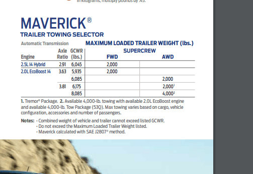

In the Ford tracking website for my just scheduled (YEAH!) Tremor, it says it has an "upgraded drive ratio".
One of the most technical reviews of the Tremor says that it has a 3.81 final drive ratio.
https://www.theautopian.com/i-took-...emors-off-road-hardware-heres-what-i-learned/
The Bronco Sport Badlands with the same dual clutch mechanicals has a 3.81 final drive ratio.
The higher drive ratio might also account for the lesser than expected mpg of the Tremor.
I expect that numbers on the datasheet are merely evidence of Ford's inconsistency/incompetence in communications.
Whether it does or doesn't the final drive ratio is not the reason for the lower MPG rating. If that was the case the 4k tow packages would also be lower and they aren't.
Assuming the data sheet is wrong then the 3.81 final drive ratio would provide better acceleration and torque at low speeds and less heating in the tranny.

I've always felt the FDR was 3.8 simply because, 1 the Tremors intended use and 2 upgraded tire size, 3 Autopian brief comment. Makes no sense to hobble off road performance with the 3.6 ratio. Should be noted that all 2022 Sports have the 3.8 not just the Badlands.
As for the opinion the Tremor has a smaller radiator, the very same PDF content sheet often treated as the last word claims all 2.0L Mavericks have the same coolant capacity.

It is mostly just down to cooling. To get the 30° approach angle, the Tremor cannot use the larger heavy duty radiator from 4k Towing pack. The Tremor will still be highly capable of towing 2k lbs, but Ford's standards for 4k truck towing are extremely stringent.
The Tremor has the same radiator and cooling fan as the Bronco Sport Badlands, which is not shared with the 4k Towing Package. The Tremor/Badlands radiator is shorter in order to accommodate the 30° approach angle.

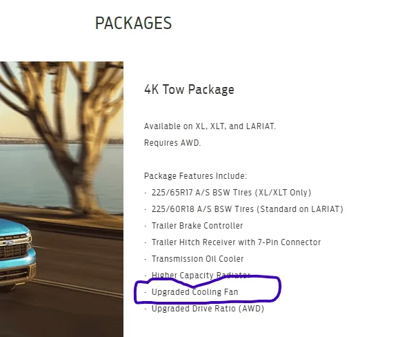

Try Phoenix with 60+ days a year over 110 and some reaching 120.
That reason alone is justification for the 4K package. Sonoran Desert both in Sonora and Arizona, 75 to 80mph highway speeds, and 110-120degF heats. Want all of the extra cooling that comes with the package.

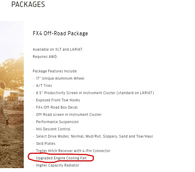

What I'm not sure of is what exactly does the FX4 package boost in terms of the radiator cooling fan... It looks like it's the same thing in both the 4K and FX4, but just a different way of wording it in the package descriptions.
Tremor has a smaller intercooler too, because of the higher ground clearance fascia. Arizona is hell.

This was the conclusion I had as well. Same engine, same transmission, same brakes. It's the radiator. Possibly something in the shocks, but that doesn't seem like something that would create an issue.
To me the Tremor could handle 4k fine, if not for short hauls that wouldn't get the radiator and transmission Temps up. I also have some concerns over heat discharge of the Tremor in very hot climates not towing. That would be why FX4 got a radiator upgrade, but Tremor did not. That was honestly one reason I went FX4 vs Tremor, a good bit of my time off road is in very hot Texas summer.
Looks like 4K has a transmission cooler and FX package does not…..
