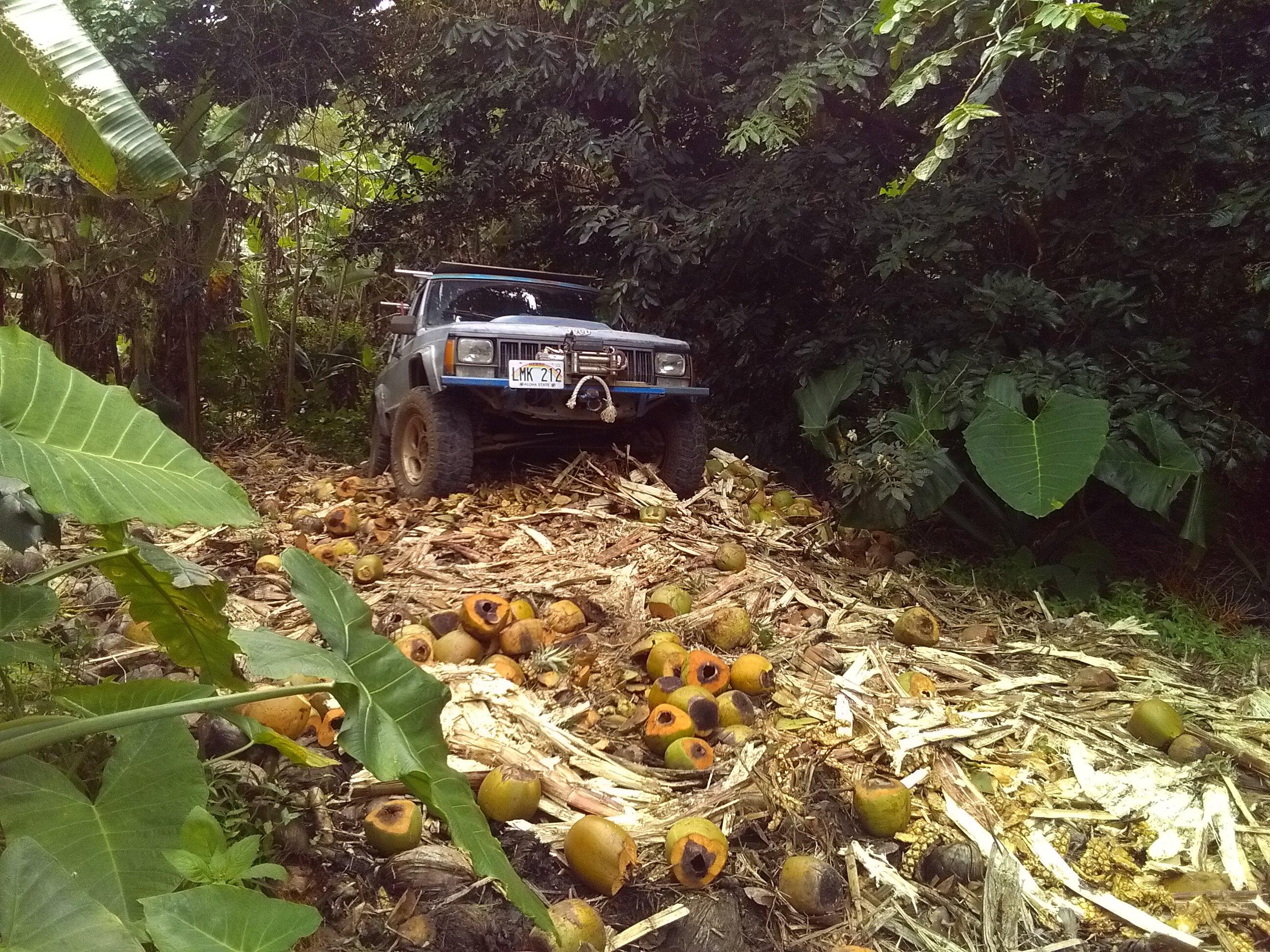

As for the lifting a Tremor mentioned earlier. The lift is in the spring and its only about 3/4" (the rest of the increase is tire diameter/radius). And since the CVs are improved for said lift. One would assume that the lifts available for the FX4 would be theoretically possible on the Tremor. I am thinking a 1.5" front and a 2" rear to compensate for my topper and keep the proper rake. Should allow me to run 245/70r17s or 255/70r17s. Which would put me a solid 2.25"above FX4 w/235s ground clearance. By my calculations that would put overall(not minimum because of the solid vs independent differences) ground clearance near or around whats found on XJ cherokee with 31s. Which as any of you offroaders may know is a very capable vehicle especially with traction aides. I dont quite expect it to keep up with my comanche on the coconut pile but I think it will do pretty well.
