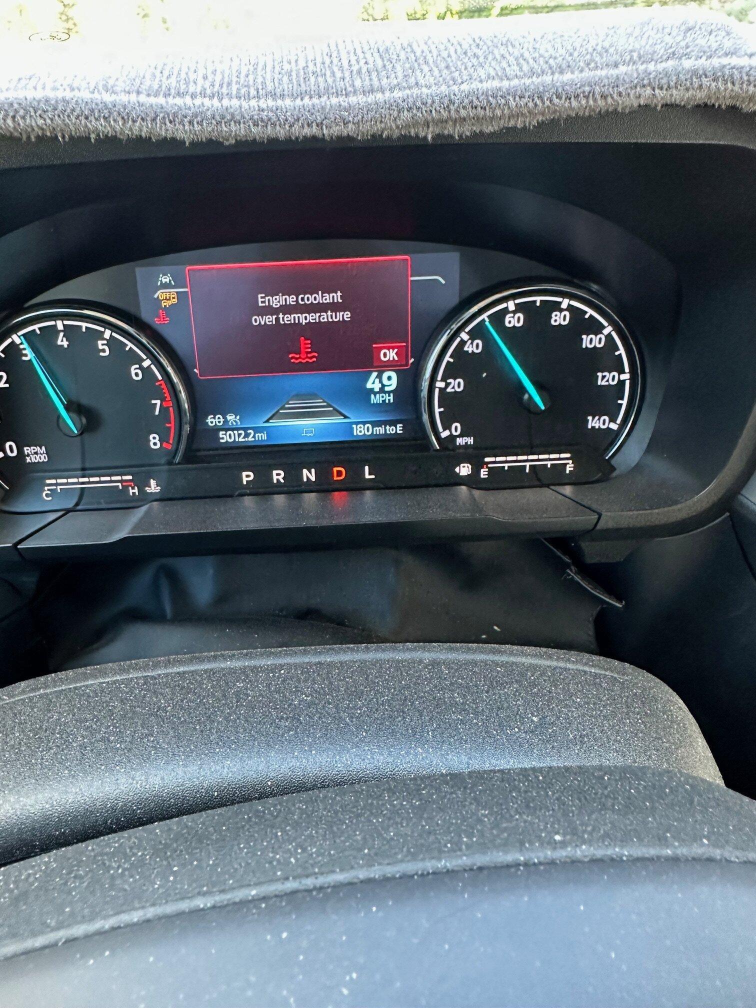

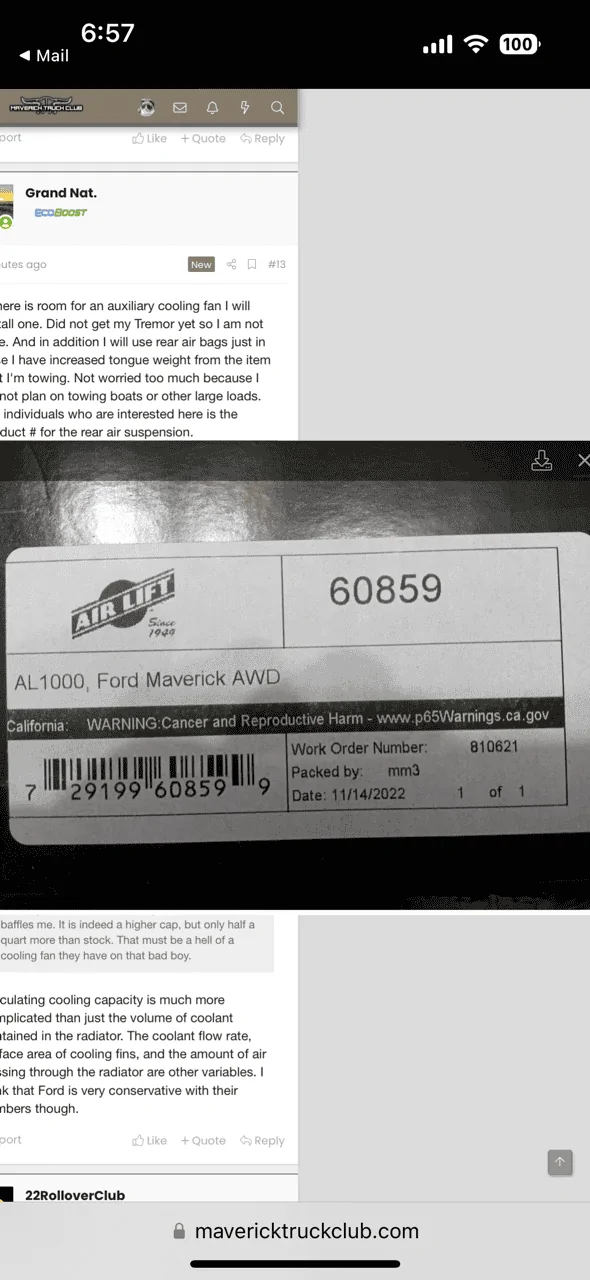

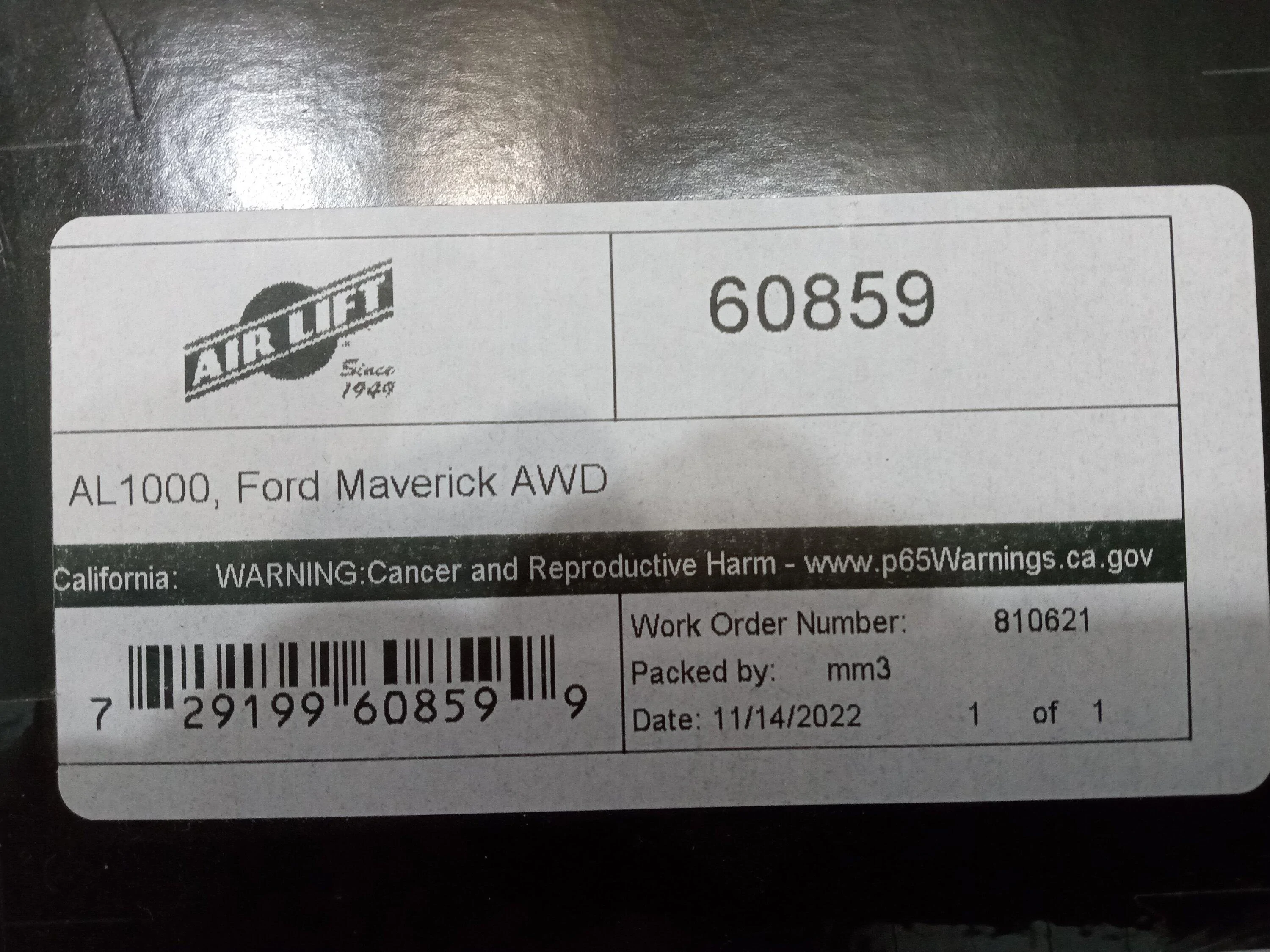

I'm Wondering if the 1500lbs air bag kit would help to at least get the tow up to around 3000lbs.
The other thing I had trouble with was the small radiator when towing. I pulled my 10' aluma trailer (425 lbs) with my Polaris General on it over the Bighorn mountains & before I made it to the top, an engine over temp warning light came on and it derated my power for a short time until the temp came back down. Is there a fix for this ? THX
