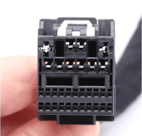

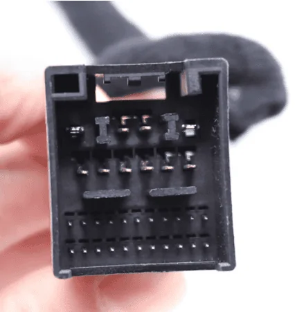

I know you didn't ask me for the info, but just in case you still need, here is a photo of the Puzu Ford Harness for the Maverick and the one I installed. Absolutely the easiest part of my audio install. I sent my supplier these photos so there would be no mistake.

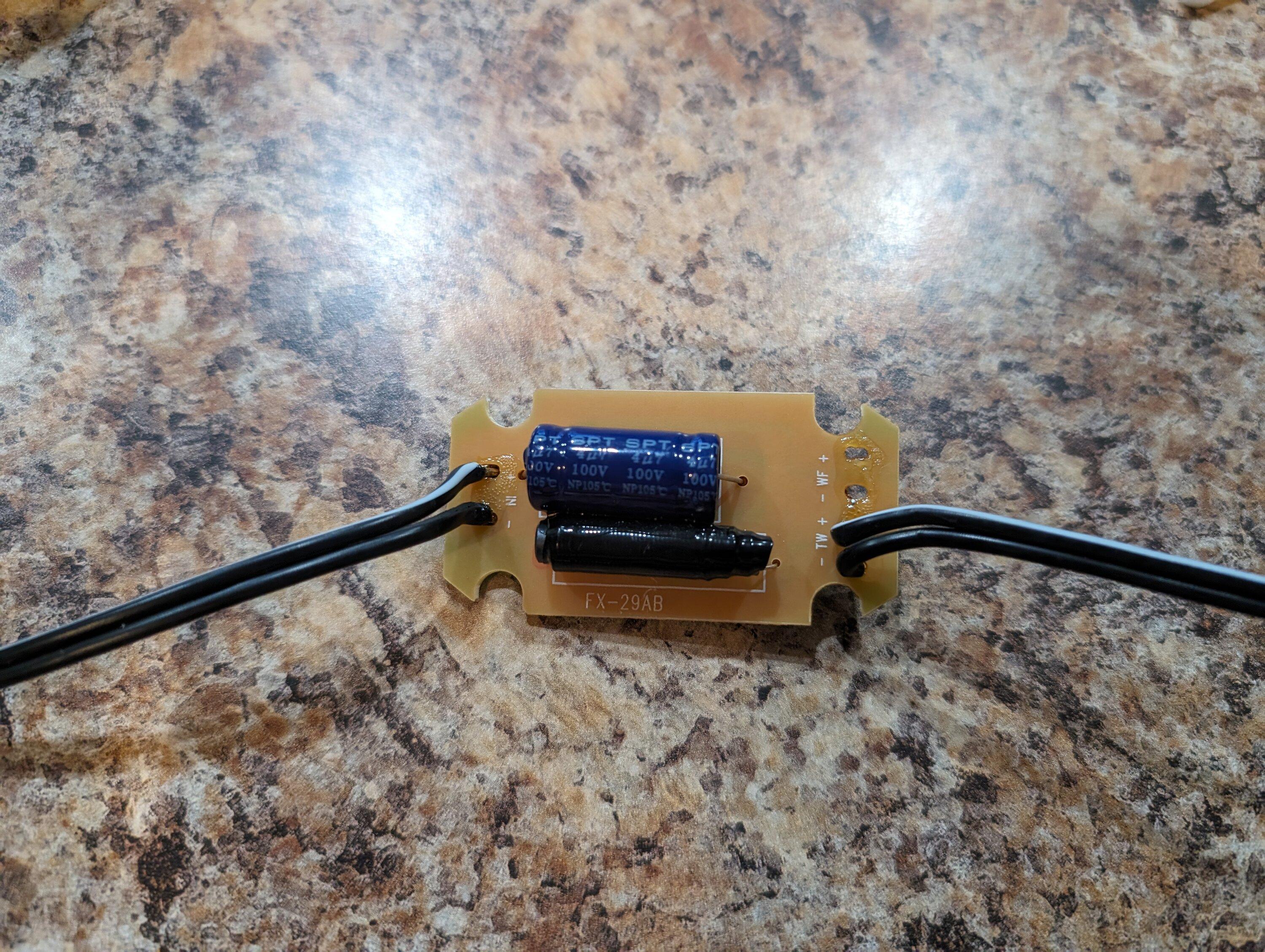

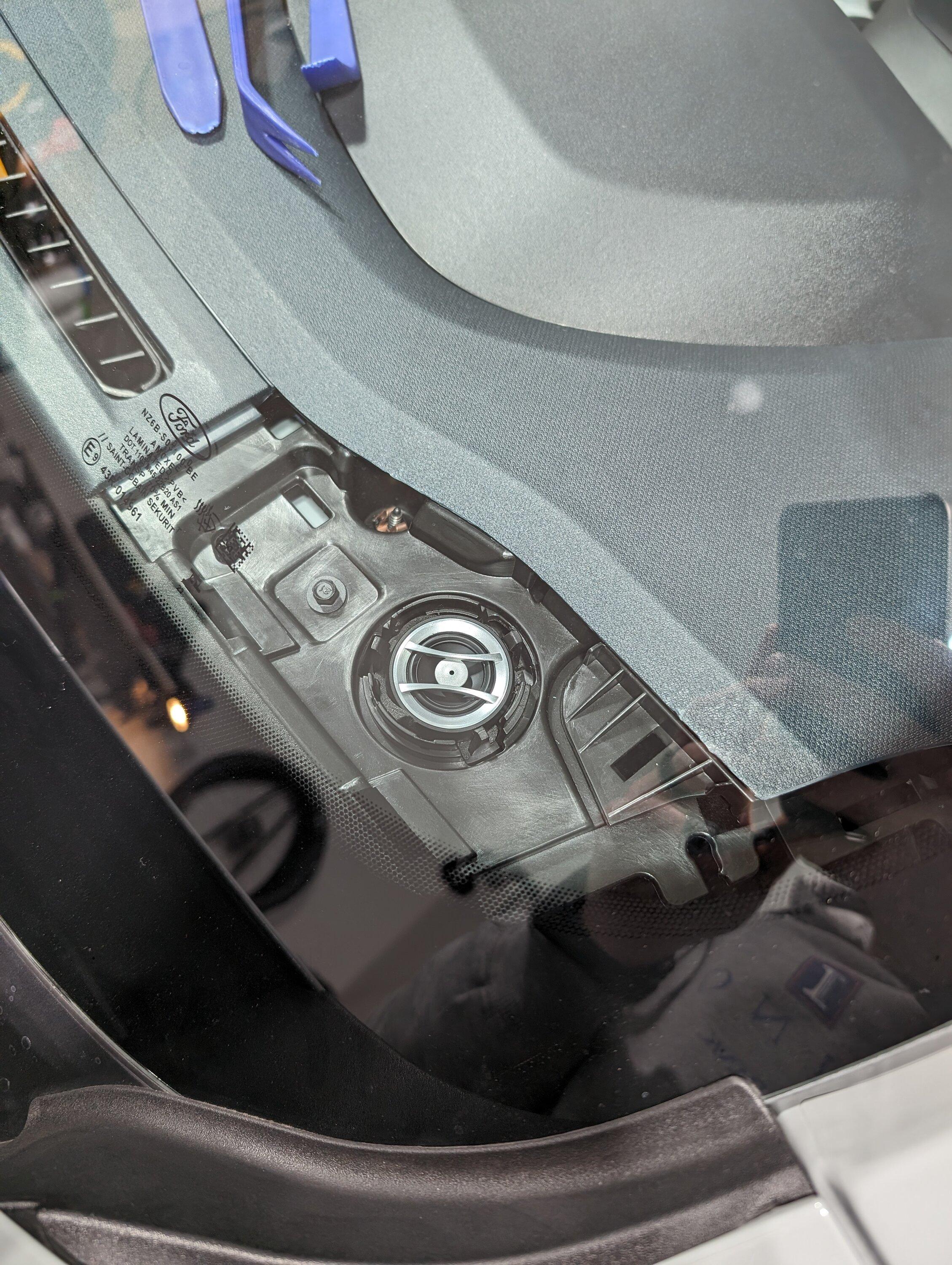

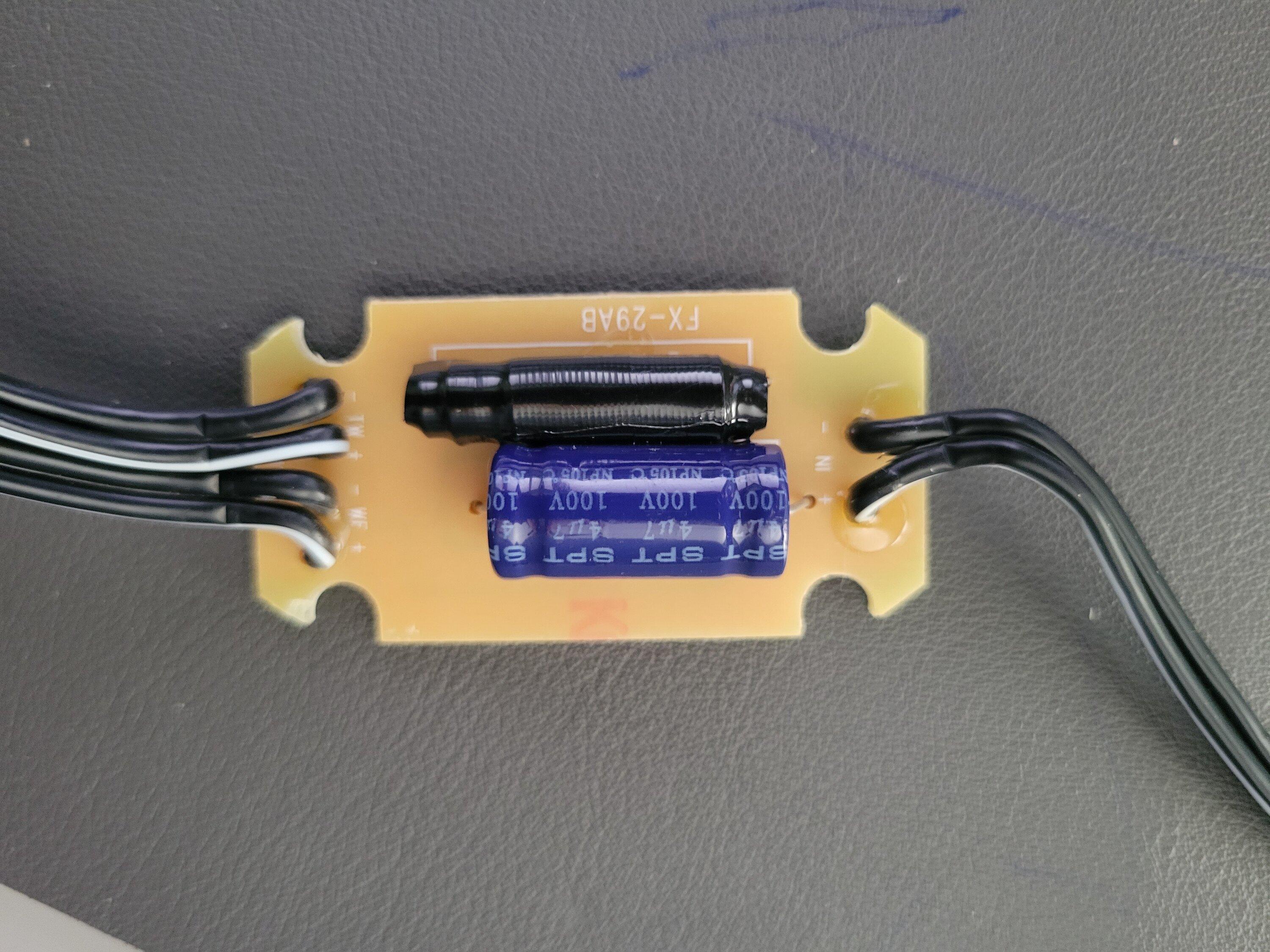

If anyone is curious, here is a picture of the focal RSE-165 crossover. I'm going to wrap electrical tape around it to make it smaller and try to fit it under the dash where the tweeters are to block out the bass.
I traced out the circuit and the woofer side of the crossover just goes straight through. The tweeter is in series with the capacitor and parallel with the black resistor/inductor?.
Did you install the RSE-165 crossover unit? If so, did you have to splice into the factory wiring?

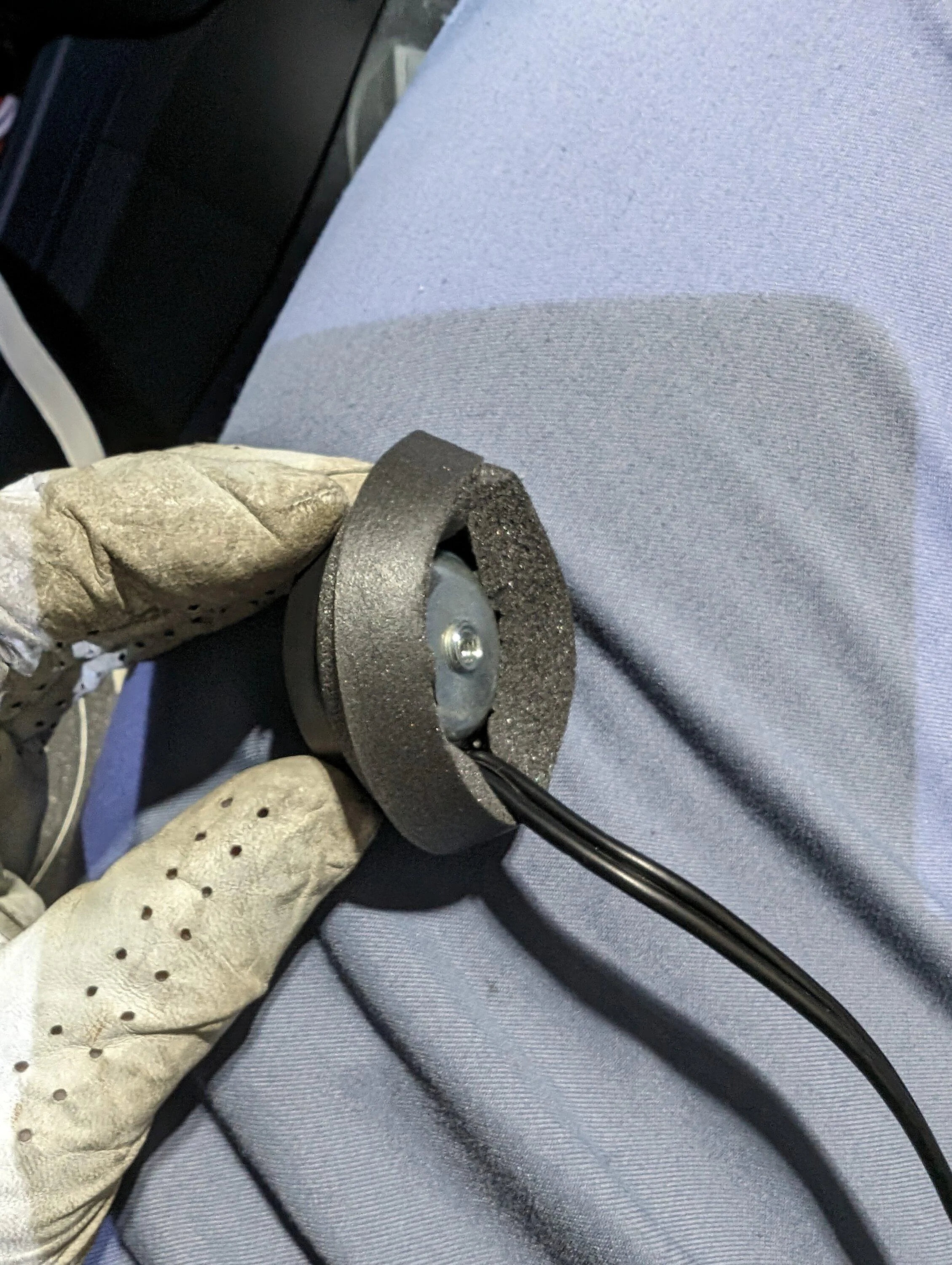

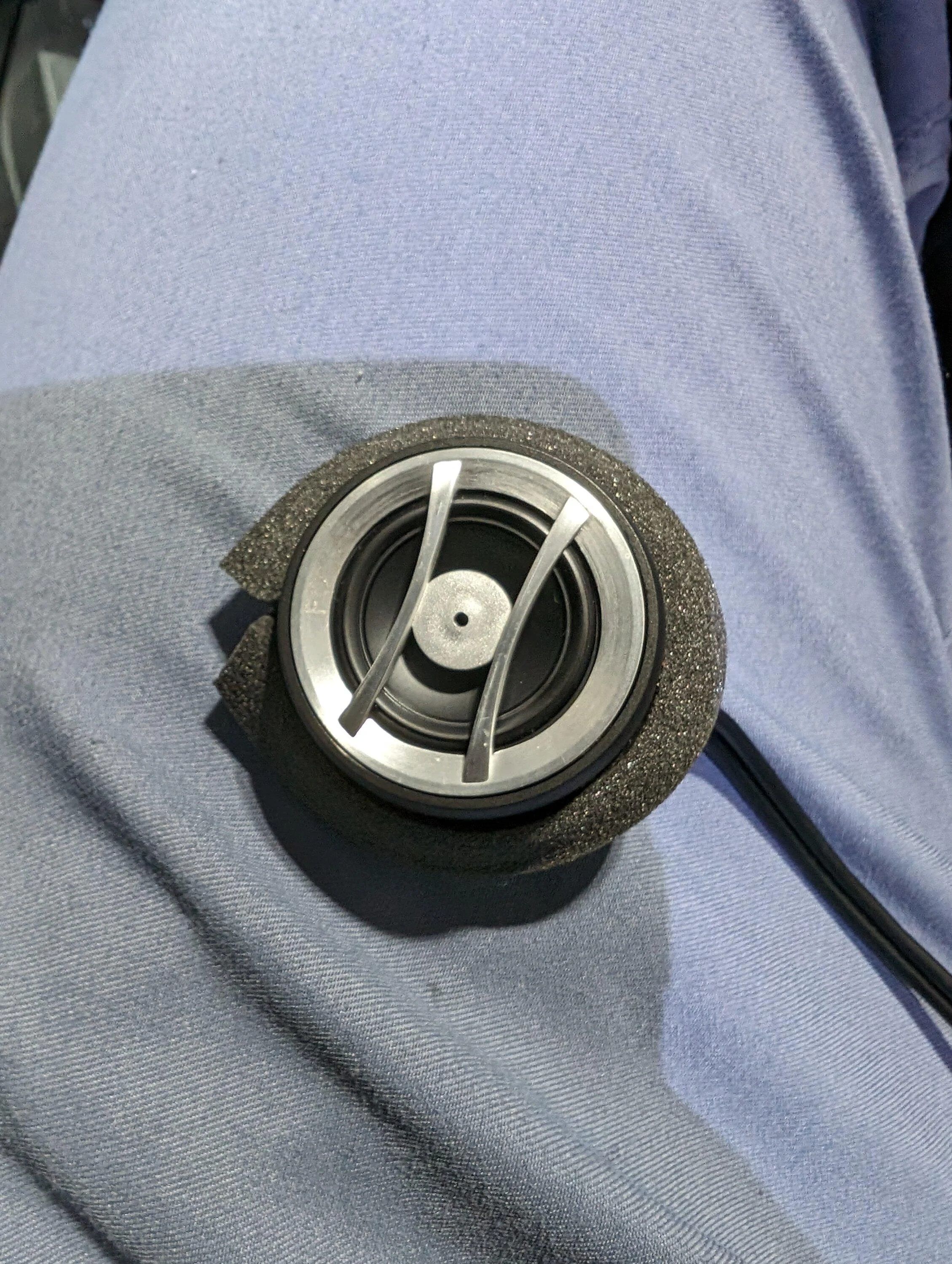

@jdmz I figured out what you were saying with the passive crossover only being active for the tweeter lead wire. I unsoldered the woofer lead wire and soldered it to the input side to reuse the connectors. I also purchased this speaker harness to plug into the factor tweeter lead. I have the glove box and fuse box panel all opened up, so I'm planning on just fixing the crossover somewhere in there.
Focal RSE-165 Tweeters Installed
Same here. The crossover fits perfectly under the stock tweeter location if you remove the plastic case and just wrap it with duct tape. Cheers!
