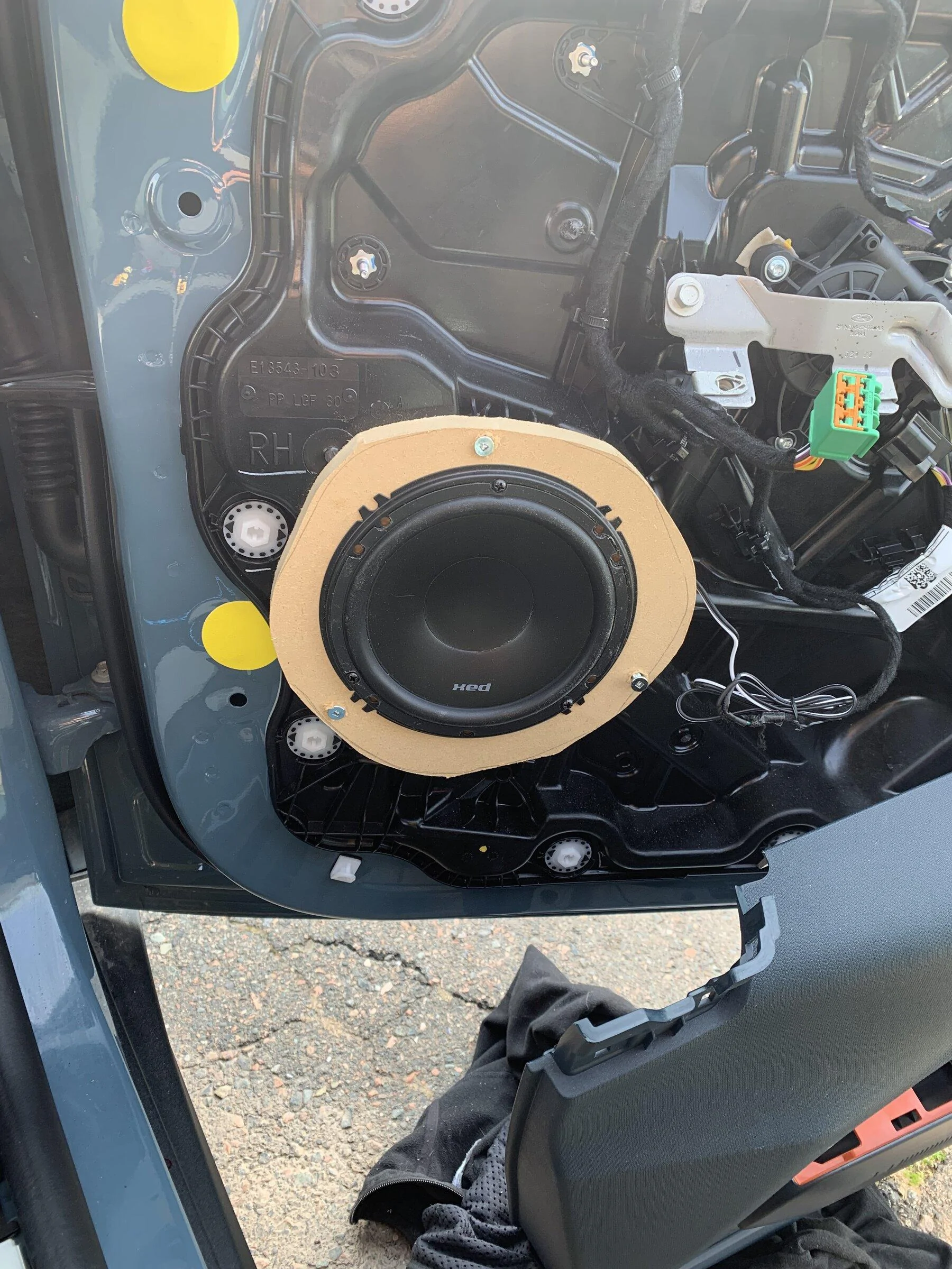

Finished my install of an upgraded sound system in my Maverick. There’s plenty of threads in here showing door panel removal and trim removal and such so I won’t go into that, but I will add that I hate all the damn clips holding everything in. I broke a few for sure, and I miss the days of just having visible screws everywhere.
My choice of upgraded gear was based mostly on getting good quality components at a budget price. I went with a component set up front and I have it powered by an amp, there’s just not enough power off the head unit to take advantage of any speaker upgrades up front. I did not upgrade the rear speakers because I can’t hear them anyway.

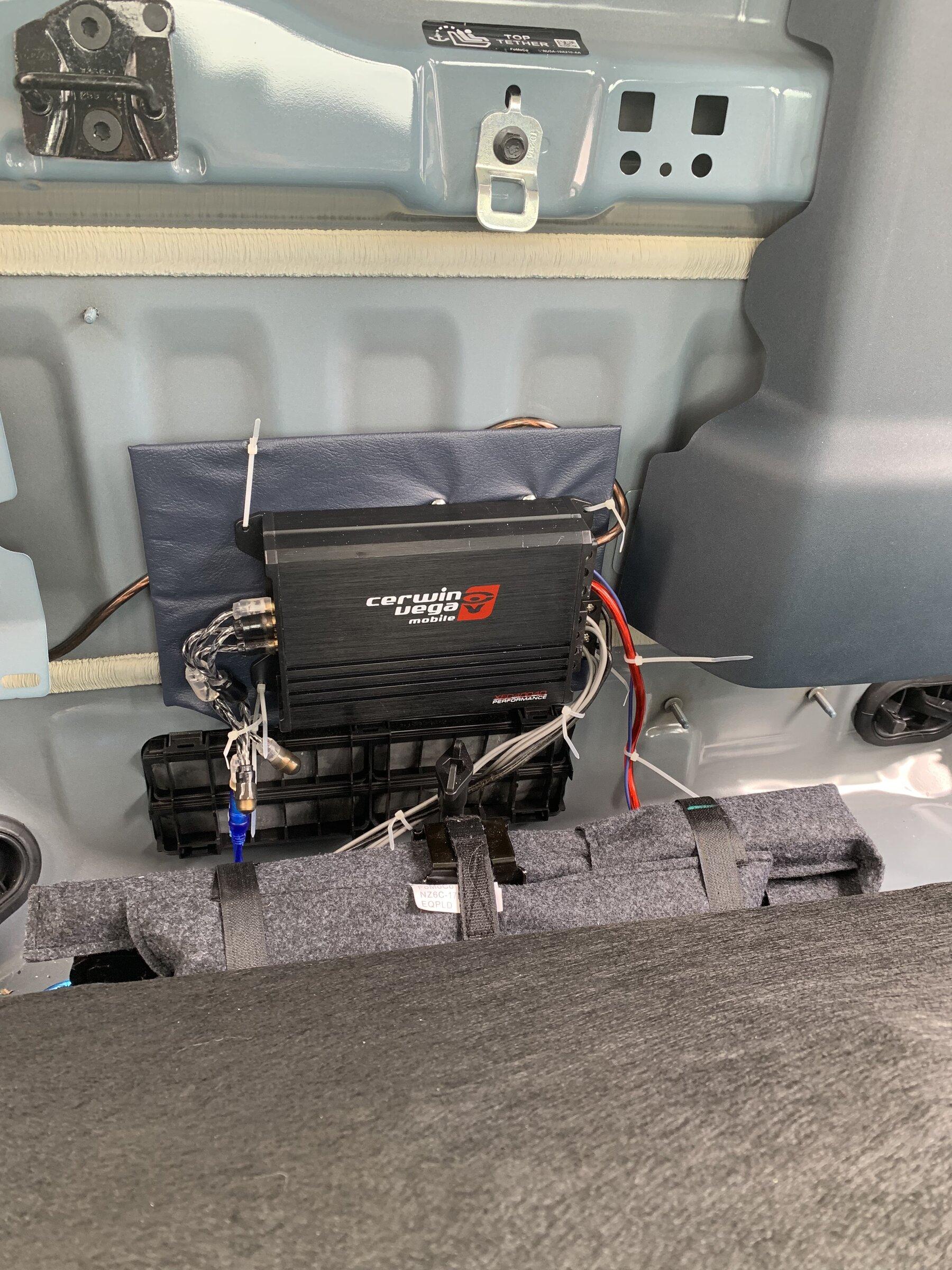

Amp is installed on an aluminum plate that’s bolted to an existing mount so no holes drilled, ground is picked up from an existing ground behind the back seat.
2 channels of the 4 channel amp are running on a high pass filter up the the front down the passenger side to the passive crossover. I could not get access to the inside of the rubber grommet that protects the wire bundle going into the door so I tapped into the existing speaker wires in each kick panel and tapped in to the other end of the speaker wire in each door.
Speakers are mounted to simple 1/2” mdf spacers, which are then mounted using the existing holes for the stock speakers. There’s lots of room in the doors when the spacers are used.
Tweeters are basically press fit into the existing tweeter mounts.

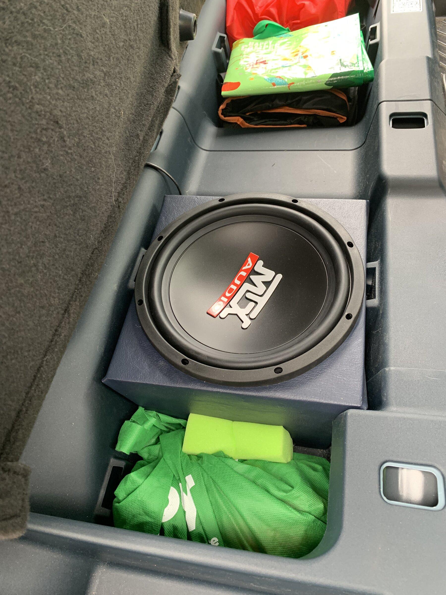

The subwoofer sits in a custom box that’s approximately 0.75 square feet and run on the 3rd and 4th channel of the amp bridged and with the low pass filter.

Also, yes the amp is zip tied to the aluminum bracket, the tiny little bolts I bought to mount it were apparently not tiny enough, so that’s a temporary solution until I pick up some new tiny bolts.

That sub doesn't rattle the living hell out of that plastic tray?

Thats a good fit on the sub..stealth...
I spent alot of time on adding mass and closed cell on that entire underseat plastic panels..
Nope, no rattles in the plastic tray at all, I suspect the tight fit of the box helps hold things tight. But I do have a solid rattle in the passenger side door when I turn it up, I suspect I’ll be chasing a few of those issues for the next little while but I expected that.

Speaking of the OP there is absolutely no way his box is .75 cu ft, I would say half of that if he's lucky. You can't even get .5 cuft in there if you pull the plastic insert and he left it. Subtract the woofer displacement and I'm very confident that box is significantly undersized.
