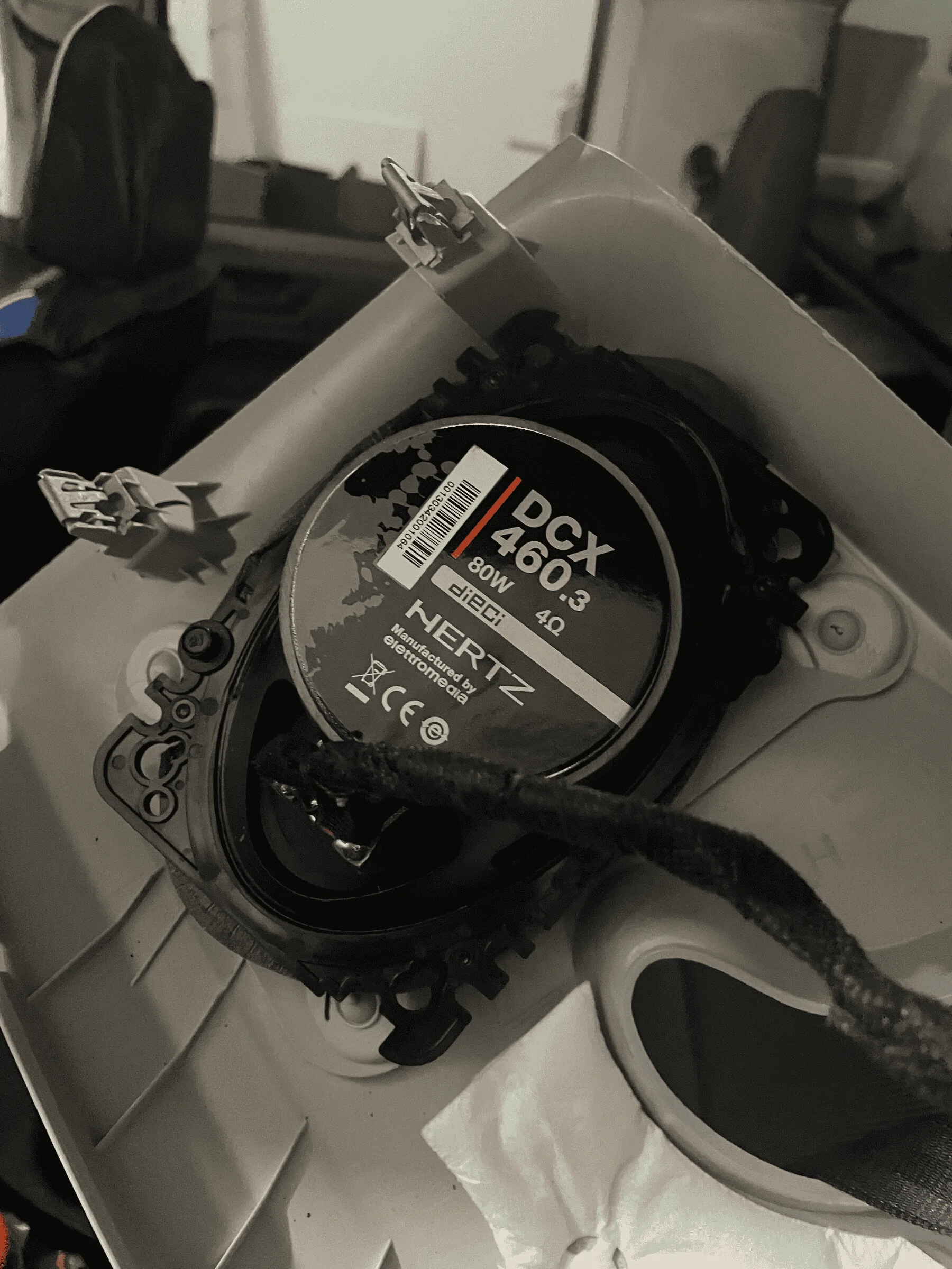

where did you put the 4” x 6” REF-6432CFX ?? i though back speakers were 4in round..

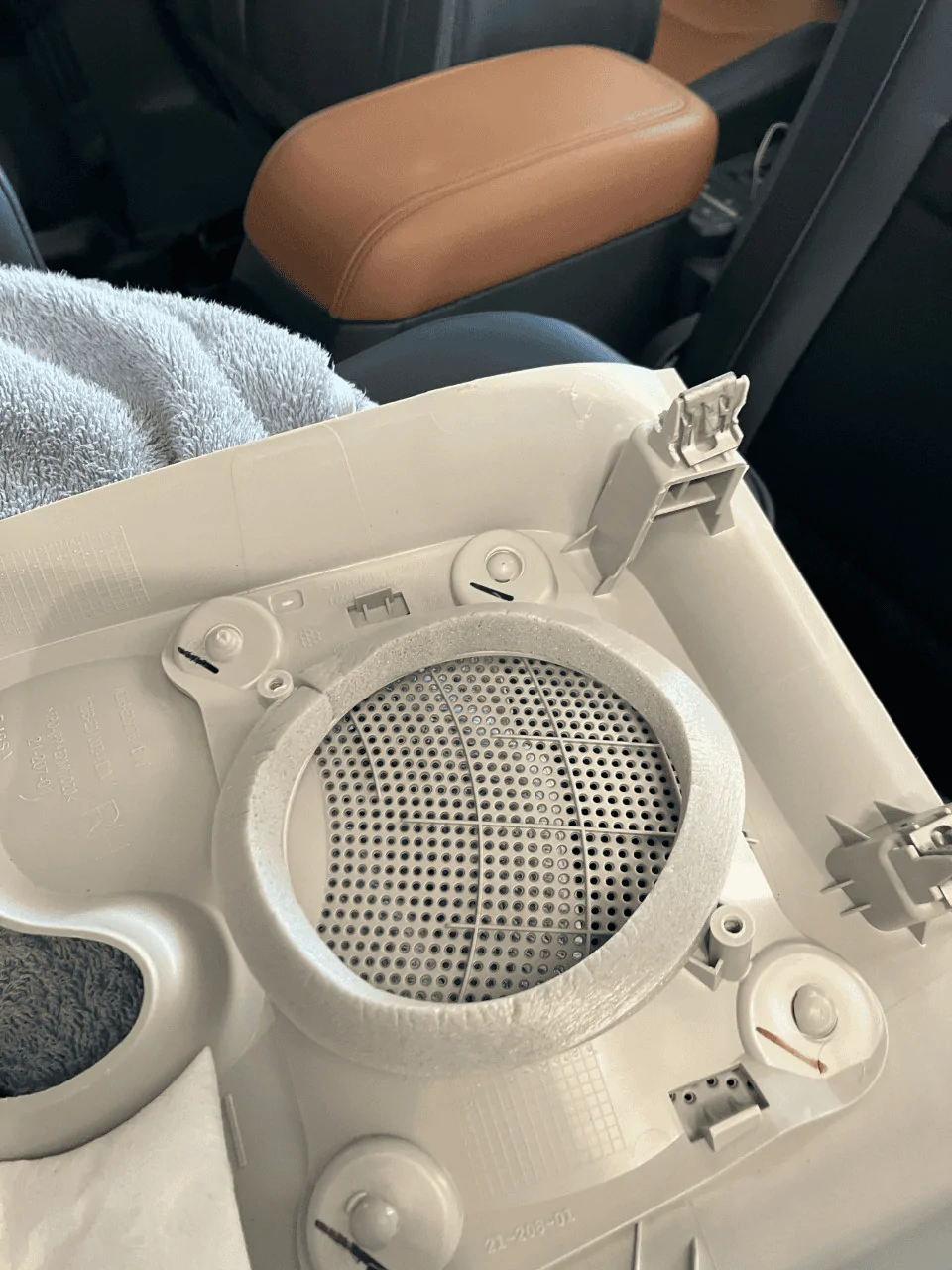

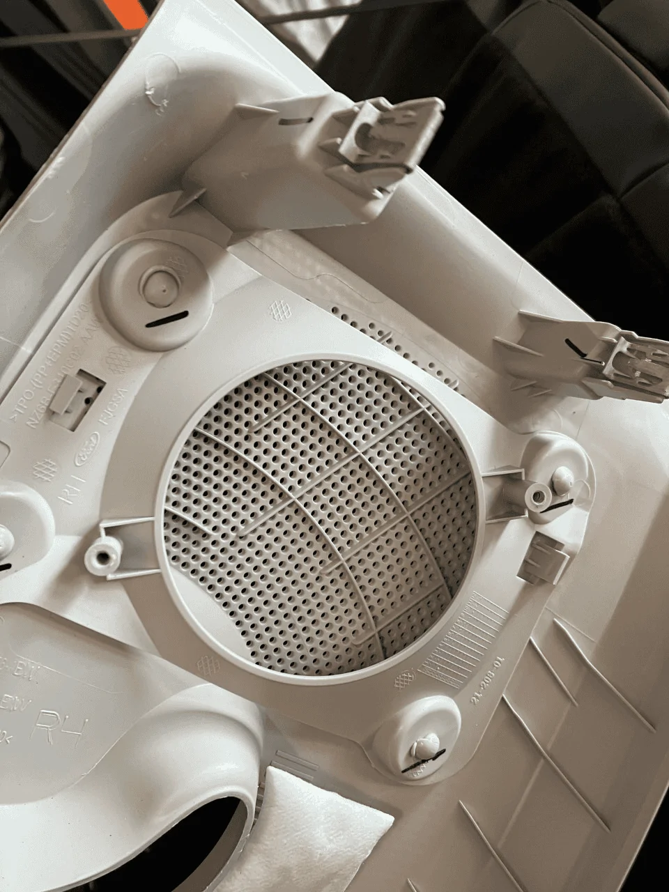

They bolted right up to the 4" mount on the rear speakers like this:
Rear Speaker Mount
Ford Maverick Full audio upgrade complete 1670614979665
Ford Maverick Full audio upgrade complete 1670615042480
Ford Maverick Full audio upgrade complete 1670615126366
This is just one way to mount the 4 x 6, there are many more methods that work as well. Credit MTC member BootXL76 for the photos. I added something similar to the gasketing material shown above. Plus, there is inside sheet metal with a gap between it and the outside metal skin of the cab. There is some fibre fill that Ford installed, but I filled up the cavity as much as I could.
Remember, the rear speaker circuit is limited on the low range of the frequencies to protect the stock 4" speaker. Some say at 75Hz, some say 100Hz, and others say at 150Hz. I do know it is limited because the low response just isn't there on the 4" x 6" Infinity speakers. The 4" x 6" have a frequency response of 75Hz – 21kHz which is also a good range. If I can truly get down to 75 Hz with the rears, then I didn't need the powered subwoofer at all with the music I listen to. They are also very efficient at a sensitivity of 92dB. They are rated at 45 watts RMS so they will be driven to their max by my DSP Amp, also rated at 45 watts RMS per channel. I haven't tuned the DSP Amp yet but I may eliminate the rear speaker feed and feed them from the front speaker feed through the DSP.
I'm not the only one that installed 4" x 6" to replace the 4" rears. Search 4" x 6" rear speakers here on MTC and you'll find a wealth of info.
Hope this helps some.

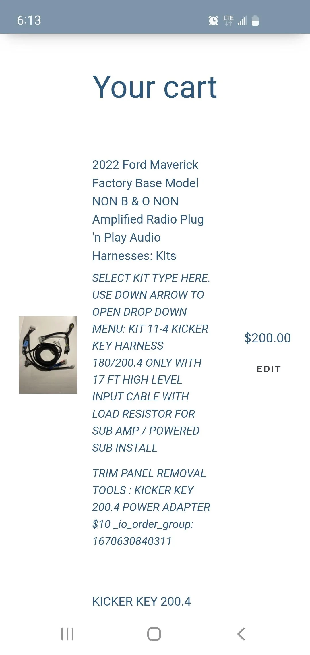

Ford Maverick Full audio upgrade complete Screenshot_20221209-181318_Samsung Internet
would this be a comparable harness to the one you used?
Certainly in the way the harness works taking the audio from the ACM feeding it through the DSP and looping back to the audio system's speaker circuits. Believe me, I lusted after the Kicker Key and appropriate harness for months. I just could not afford the Kicker Key and a $200 harness. So, when I found the Puzu DSP AMP with harness included, I jumped on it.

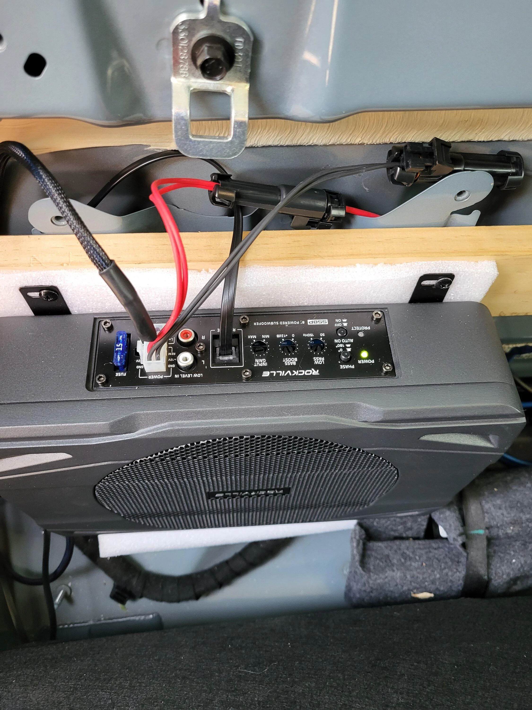

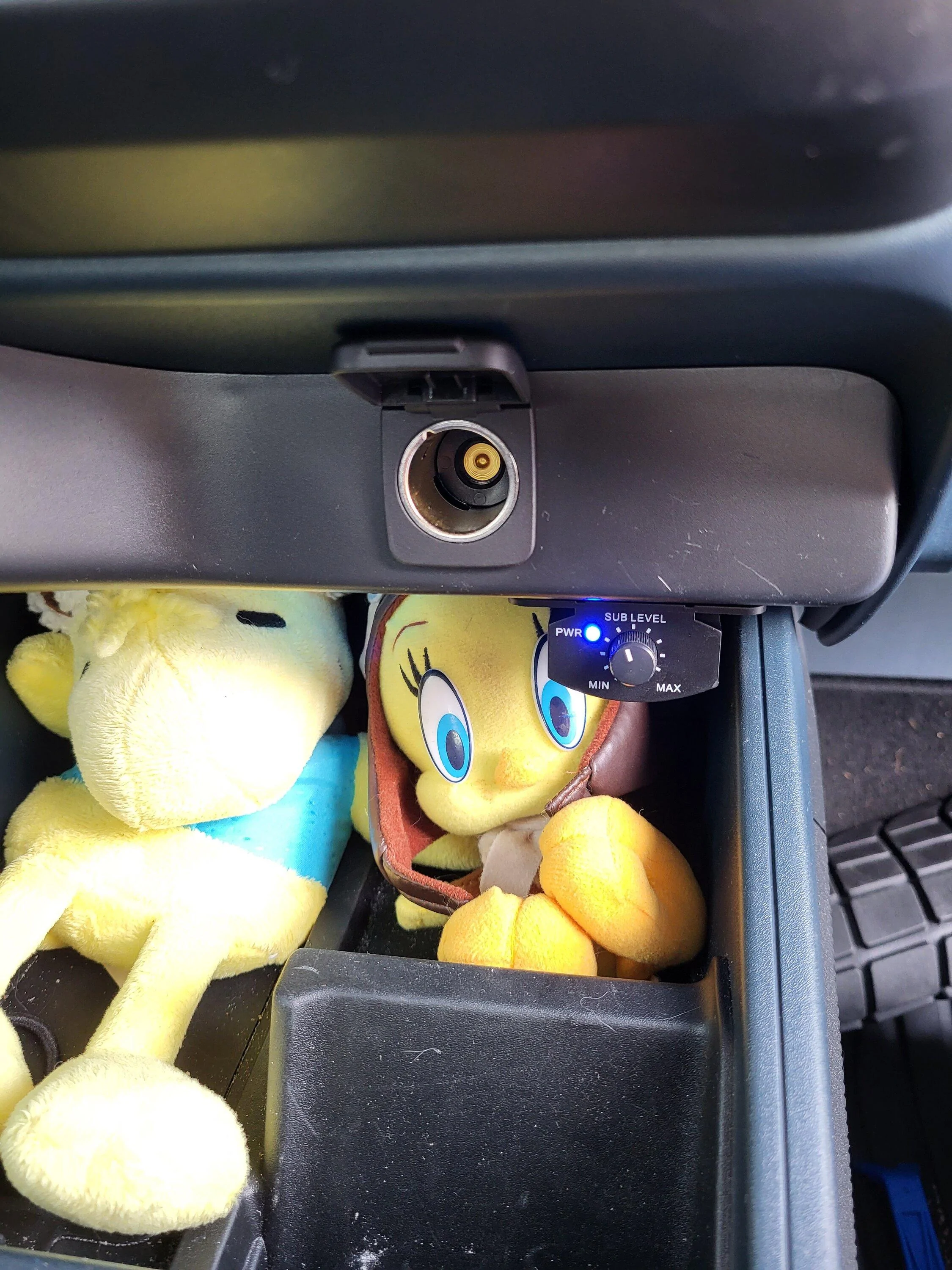

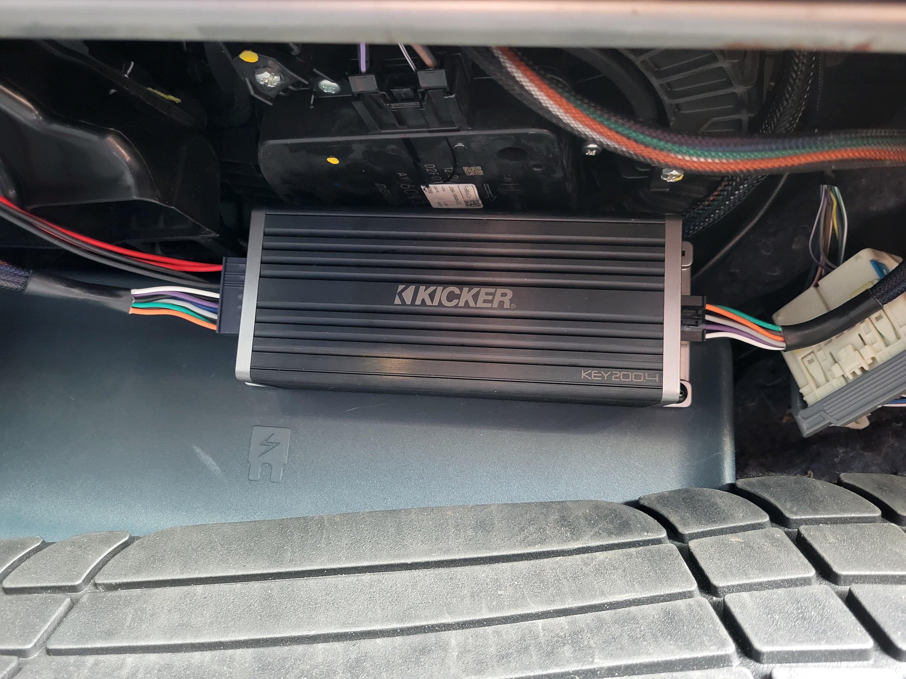

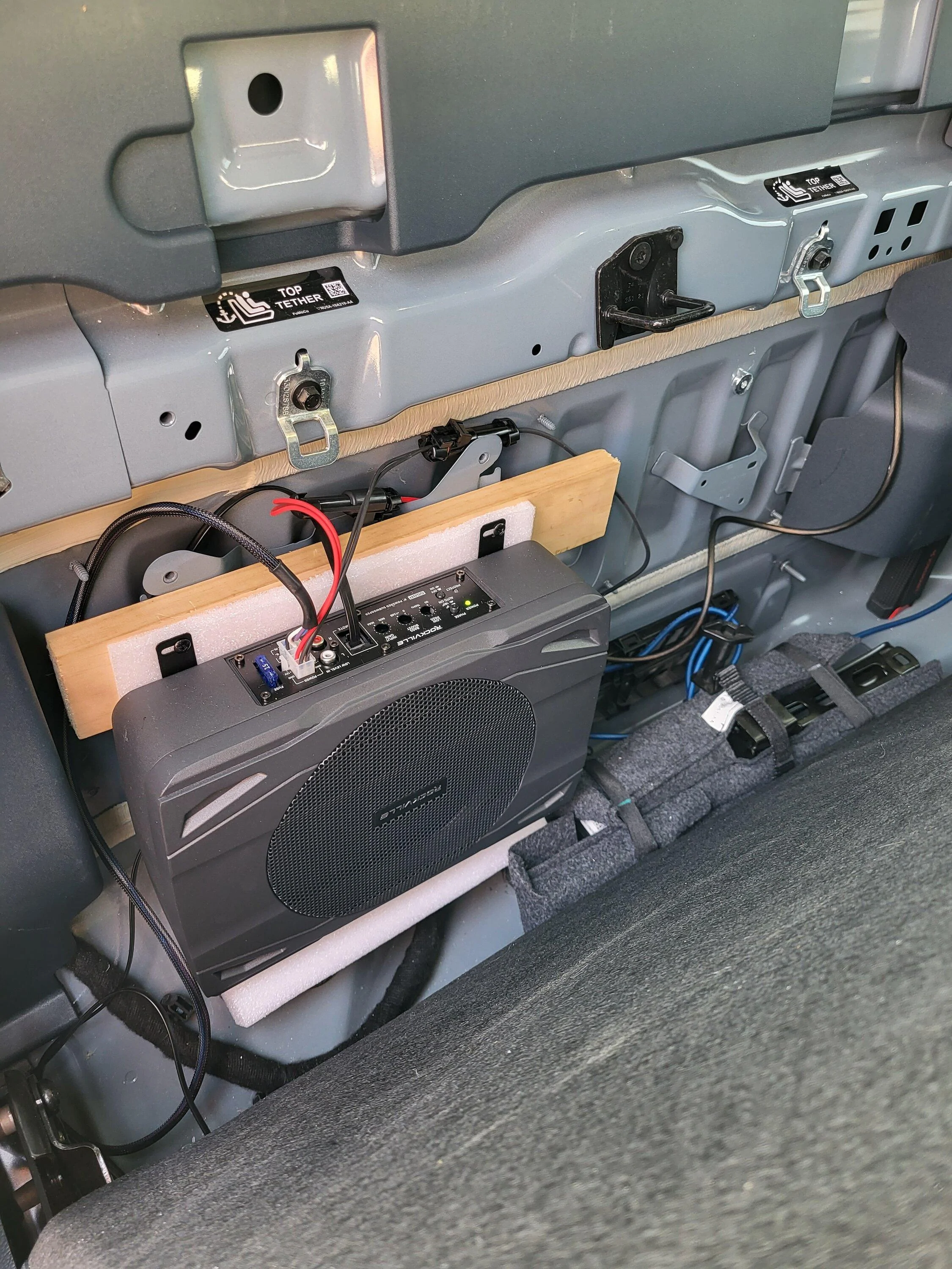

I finally upgraded the sound system in my xl maverick. The stock sound is awful. Terrible.
Kicker key 200.4 amp. $250 Best Buy.
Focal component speakers ( front doors and dash) RSE-165. $149 CRUTCHFIELD.
tweeter harness . Metra 72-5600. $15 for two. CRUTCHFIELD.
Rockville 8" . 400 watt powered sub woofer. $100 . Amazon.
Complete harness that connects radio to amp and subwoofer. $180
https://hoelwiring.com/#MainContent
The hoel harness may seem expensive but it's such a time saver. All in one to hook up everything. I only had to run two power leads from battery and run two ground wires. The customer service is outstanding. Even answered my many noob questions at midnight !
I bought the Boss amp kit for $20 on Amazon. The Rockville sub came with a wiring kit.
$5. At harbor freight for heat shrink tubing.
I took my time and install wasn't too bad. The tweeters actually caused the most cursing.
The kicker key amp is amazing. It automatically balances the audio.
I am not exaggerating....the sound is 5 times better than stock. Simply fantastic!!!
