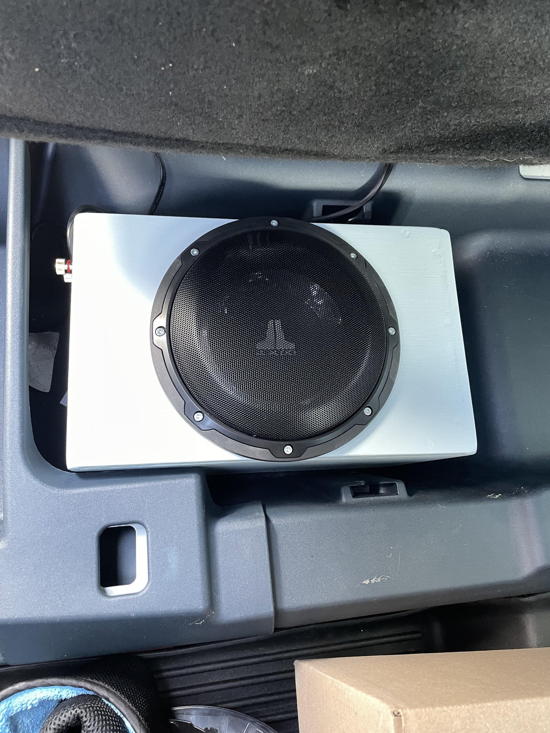

I installed Morel Maximo Ultra component speakers up front and Kicker 4" KS series rear speakers (all from Crutchfield on sale) this weekend and it made an incredible difference. I connected the crossover to the tweeters only and was able to stash the crossovers under the stock tweeter location. Couldn't believe how crappy the stock speakers were when I took them out - junk. I am thinking of adding a powered sub and a 4 channel amp in the future but wanted to see what difference the new speakers alone would make. Night and day though it would be nice to have a bit more bottom. Next step will probably be to add a modest powered sub and see if I want to go on from there with an amp, but I think it will be fine for my old ears without the amp.
Since this I added an Infinity Kappa 5 channel 500w amp, AudioControl LC71 Line Converter and a 8" 4ohm JL subwoofer in a .35 cu.ft. enclosure. Complete transformation - incredible, full range sound. Sound is clear and on point no matter the volume
Ford Maverick Full audio upgrade complete IMG_3994
Ford Maverick Full audio upgrade complete IMG_3996
