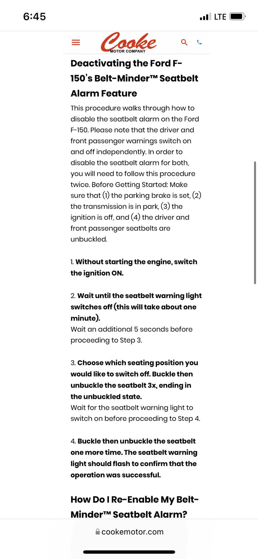

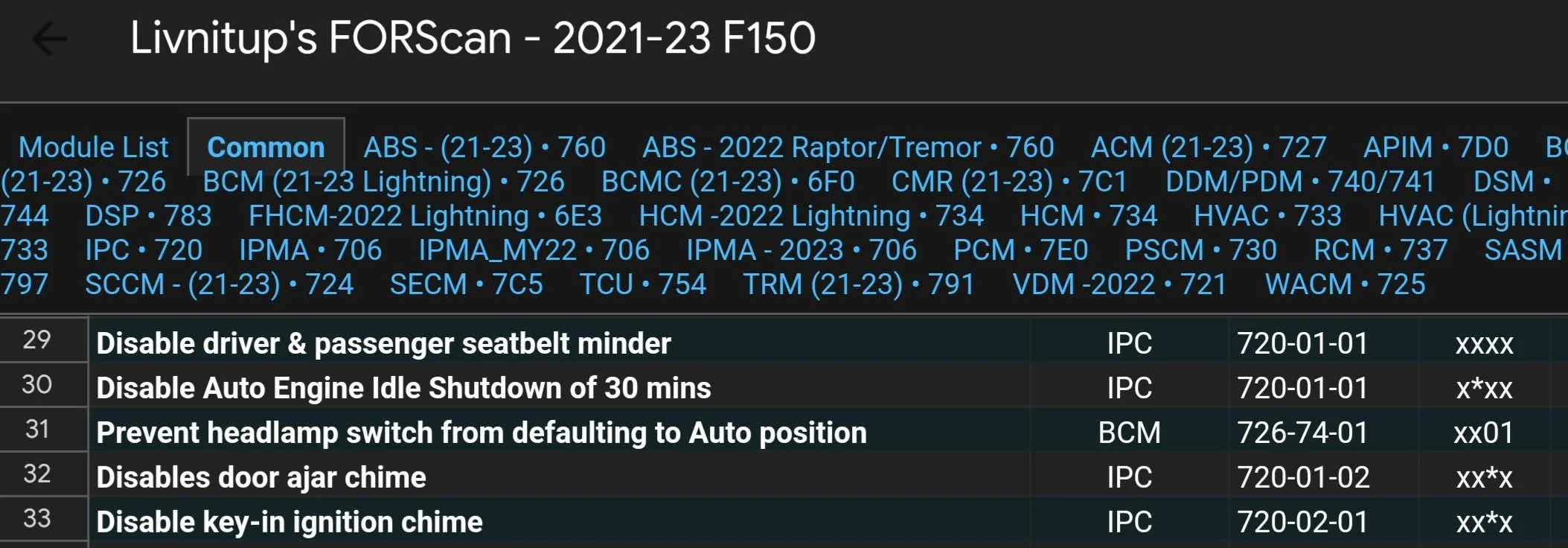

Hi ya'll, making a thread for finding way to stop door chimes, double honk, even a few other features you may hate or love.
Are Maverick owners able to disable/mute thru infotanment system or has anyone tried "Forscan" that works on f150s ect? Just thought some people may like to know how to stop the dings/ alarms if they don't have kids or are like me and will drive without a seatbelt during ice fishing and the alarms drive me nuts. Should have an "ice fishing mode" where doors are unlocked and no seat belt required. Hope this thread finds those with Mavericks or knowledge on subject. * My mav won't be here till end of November.
"FORScan ELM327 OBD2 Adapter Compatible with F150 F250 and More, Transform MS/HS CAN Automatically, OBDII Diagnostic Scanner via USB for Windows only"
