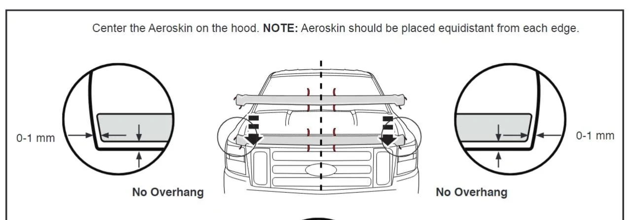

Next time, BEFORE removing tape covering, position the piece where you want it. See post 20, using a small piece of painters tape to hold it in place. (see dotted line post #20). CAREFULLY cut tape between hood & guard, leaving a piece on hood & a piece on guard. Start to remove 2 sided tape coverings on guard. CAREFULLY line up the two pieces of painters tape while holding guard off hood. CAREFULLY ease guard in place aligning the painters tape pieces & lower on hood.
*** even with this you can miss align, but it works pretty well for me.
