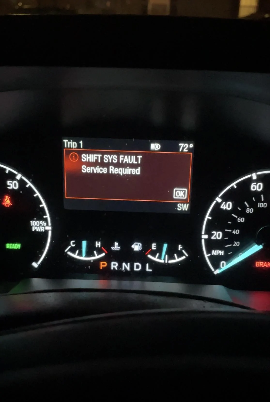

Hey everyone, going to give a short update here.
TLDR - still not fixed, but the dealership finally has my vehicle.
shortly after I posted this I sent an email to the general email for the dealership listed on their website detailing the issues and giving them the possible fixes (thank you to everyone that gave me advice here btw)
I waited a couple weeks for a reply and never got one, so I called them, played phone tag for a week before I finally got an employee email I could email. So I wrote them an email detailing everything. We got an appointment set up so I dropped it off over the weekend.

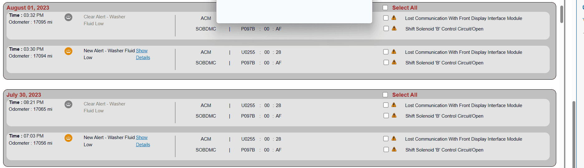

they call me today and first thing they say is we don’t have the part for your recall. I explained to them this isn’t about a recall, I told them about the email and I briefly explained what is going on. They said they were going to try to recreate the issue by driving my truck home tonight. I told them that’s fine but y’all already tried that but go ahead if you want. but to please check the ford pass and please check the error codes. I was working so I was unable to give him the exact codes I received on here. But I made it a point to ask him to please check the email I sent them and to please check the ford pass for the error codes.
I’m not picking up my truck until they fix something and they can give me a good reason for fixing it. (Example the P097B code is messed up so we replaced the wiring) so they won’t be able to give me a “we can’t recreate the issue so we can’t fix it.” Hopefully anyway
I’ll keep you guys updated. I appreciate all your help
