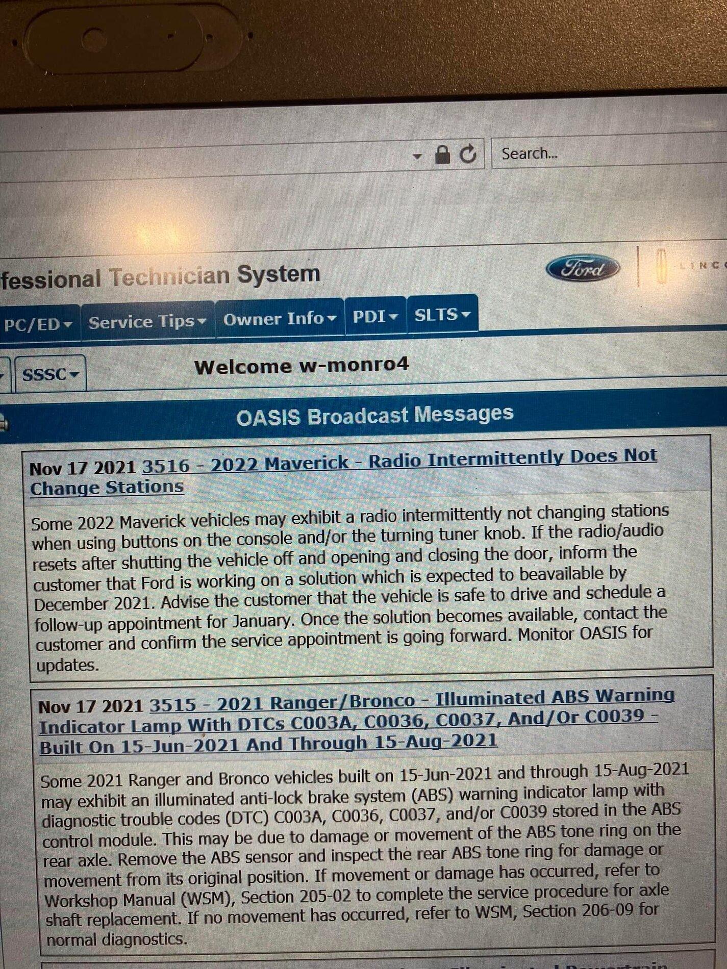

Pulled this image from another maverick group. Looks like ford is aware of the radio tuning issues.

Good to know they are aware and already working on a software patch.
Also good to know its a software issue and not a hardware one. Way easier to patch a computer than reinstall a new radio.

While I agree a software patch is easier than a hardware issue, I didn't see anything in the message above indicating that it is a software issue. Perhaps you have other information?

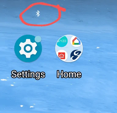

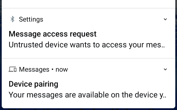

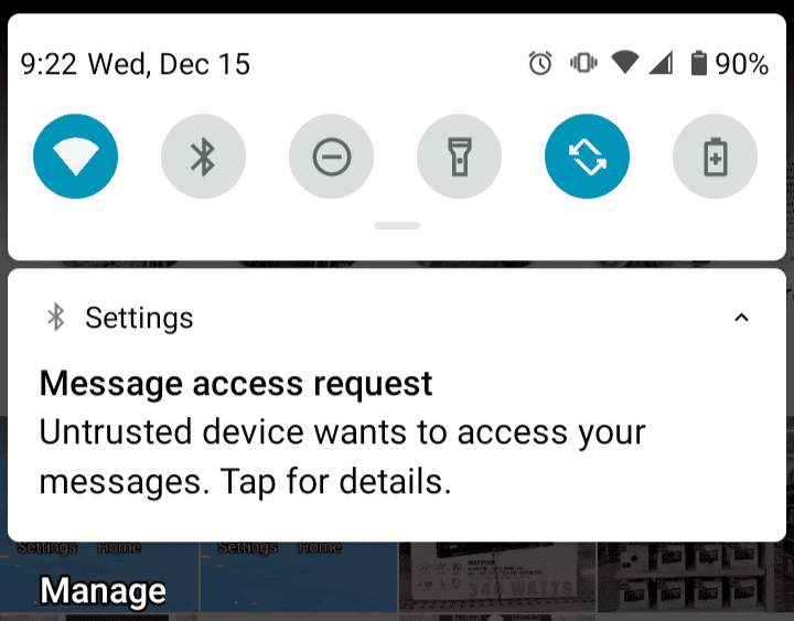

In all seriousness, I suspect the radio problem is caused by a failure to revert back to manual mode after syncing your phone via Bluetooth or USB. I noticed that even when my phone is not connected and BT is off, it displays a message when I get in my car that a device wants to connect to my phone. The BT icon even shows at the top of my screen when it's off. I bet if I tell my phone to forget the Maverick and/or tell the Maverick to forget my phone, the radio will work fine until the next time I connect.
