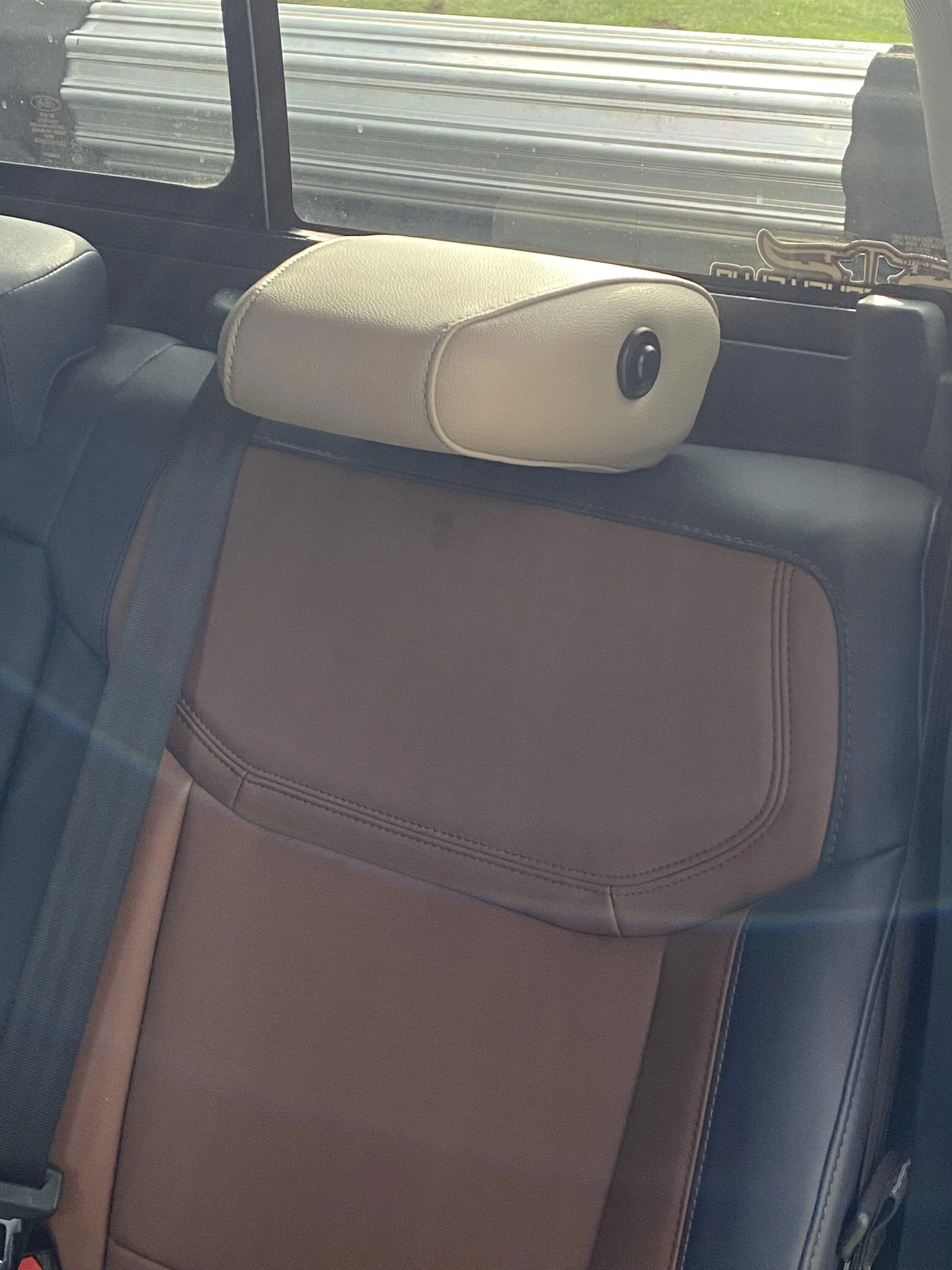

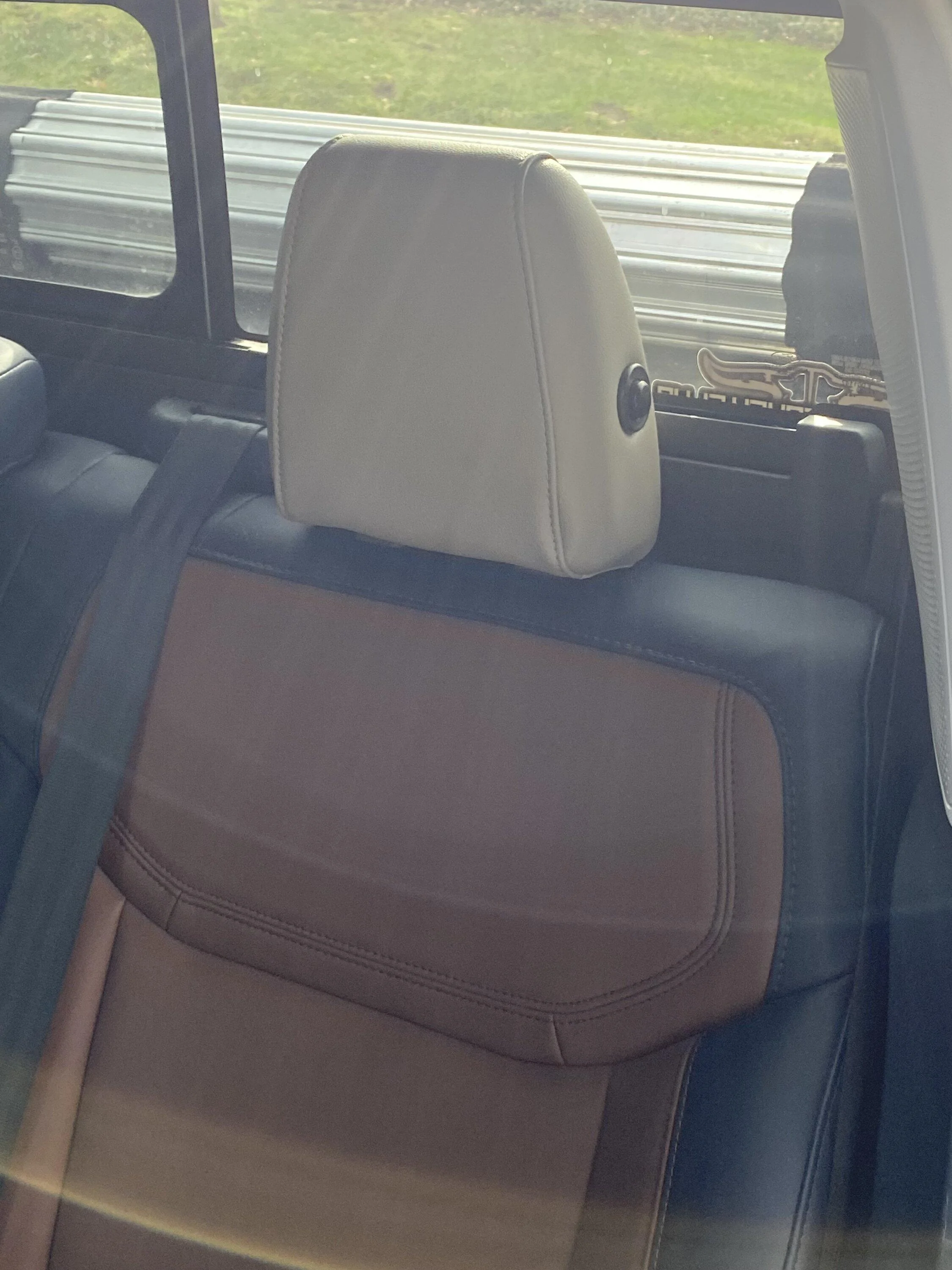

Someone in this thread mentioned using rear headrests from a C-Max. So... This past weekend, I "borrowed" one from my wife's 2017 C-Max and it fit perfectly in the rear of my Mav. As someone else mentioned it does not lock when fully down as the notch in the rod is a bit smaller, but it is not going anywhere. I would think any C-Max rear headrests would work as the C-Max was a pretty short model production (2013-18).
Quickly put it back before my wife noticed...
Ford Maverick Folding Rear Headrests Installed IMG_2694
Ford Maverick Folding Rear Headrests Installed IMG_2695

Someone in this thread mentioned using rear headrests from a C-Max. So... This past weekend, I "borrowed" one from my wife's 2017 C-Max and it fit perfectly in the rear of my Mav. As someone else mentioned it dies not lock when fully down as the notch in the rod is a bit smaller, but it is not going anywhere. I would think any C-Max rear headrests would work as the C-Max was a pretty short model production (2013-18).
Some people are just willing to put their life in danger to help others. Thanks.

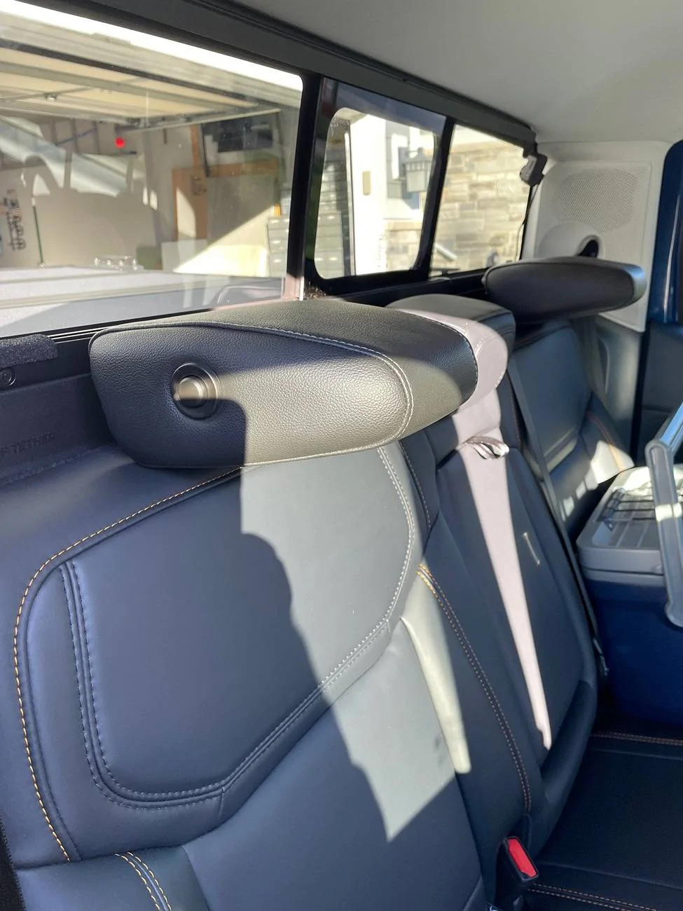

I just did this modification for more visibility. It is a great and easy mod and it matches perfectly with my XL seats. I picked up the Escape folding rear headrests on eBay. Funny enough the 2023 and 2024 escapes don't have the folding rear headrests anymore...:facepalm:
So make sure you buy ones that do indeed fold! From a 2017-2022 Escape I believe
