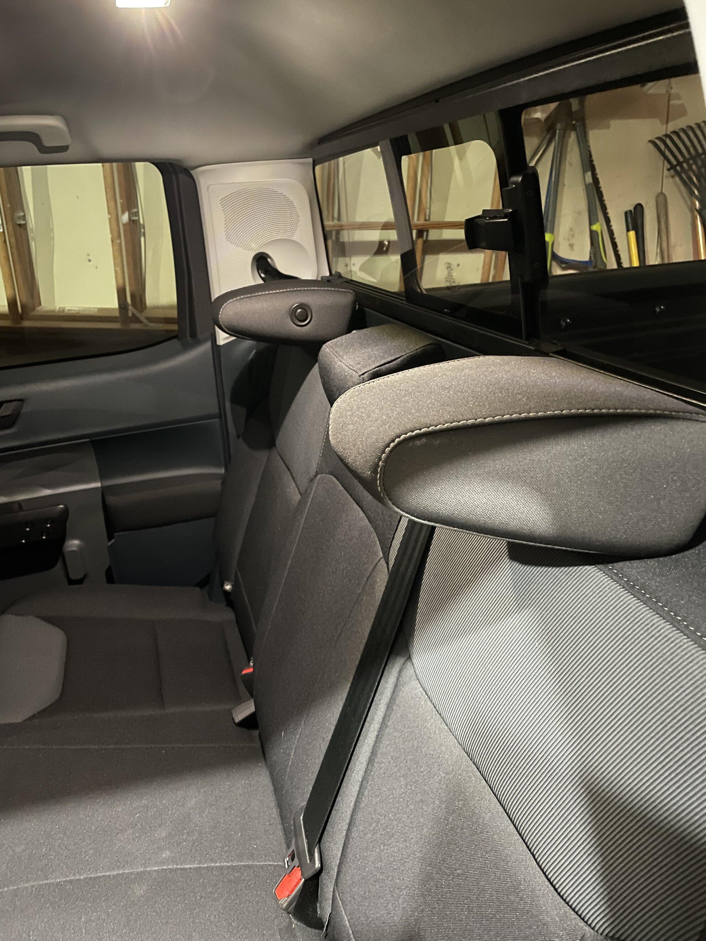

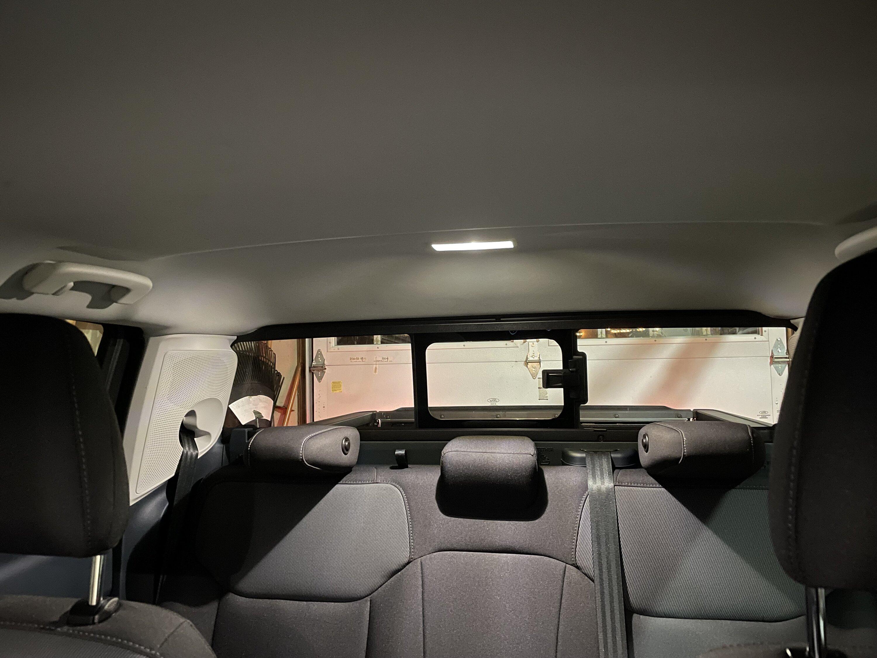

Installed these 2013-2019 Escape folding rear headrests (eBay purchase). Matches the XL black cloth interior. Great fit but they do not lock in - the notch in the shaft that locks them is a bit smaller than the OEM. I might modify it later but it is a snug fit - they aren’t going anywhere. Provides a lot more rear visibility and they clear the front seats when folding the rear seat down.
Good hunting! They look factory (well, they are, just for a different vehicle). Why didn't Ford just use this concept in the Maverick? They had the parts, right?

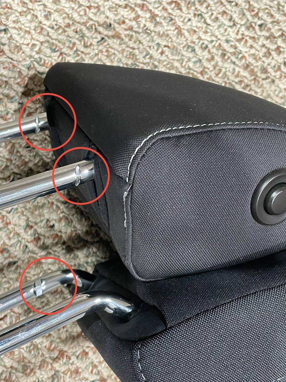

the headrest posts don't have the serrated locking notches..did I get the wrong year headrests (mine were off a '19 escape), or do none of the headrests have the locking serrations & I'm just being dense.
I'd love ot hear from those who've also done this to see if my headrests were an anomaly or the norm.

Yours are the norm, mine do not lock-in either. 5 minutes with a Dremel would fix it, but they fit tightly and don't move.

Mine have notches on both Mav and Escape but they are different. Mav has one wider notch only on the right post, about an inch from the top. Escape has a thinner notch on both posts about 1/4 inch from the top.
