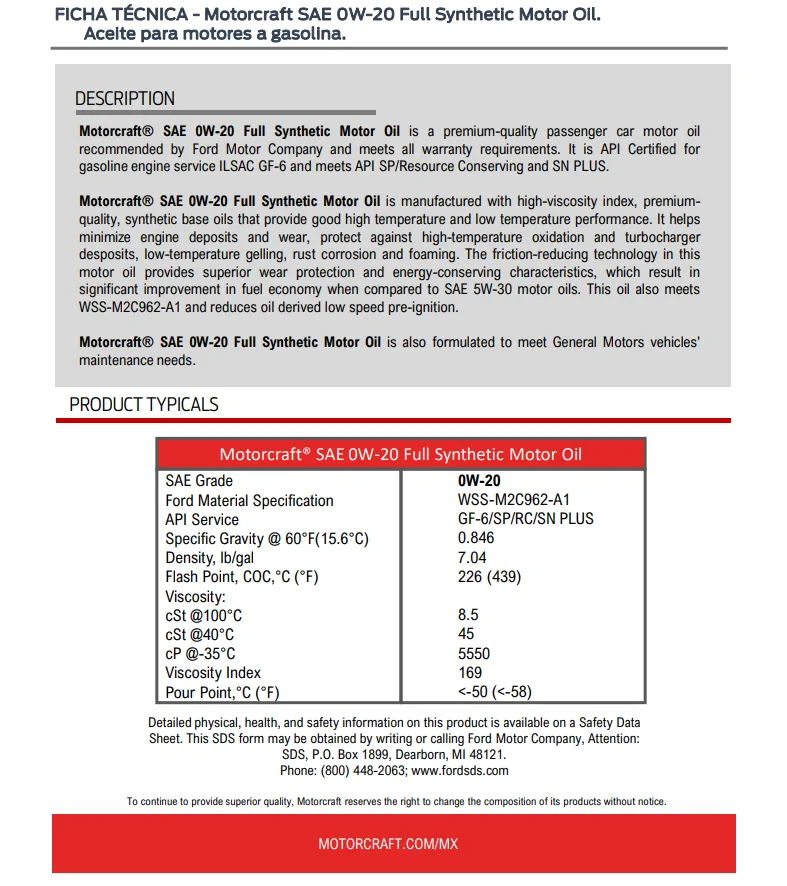

To me it seems just…wrong…to have the luxury of changing oil every 10k miles. But that’s what the manual says. I did go with full synthetic. I figure with such an infrequent interval, who cares if it’s expensive.
Pretty sure that the specified oil for the Hybrid is 0W-20 synthetic. I have questioned the Service Advisors many times about this for my 2020 Escape Hybrid. I don't think you need to ask for it, but I always make sure. However, I am sure that the dealers will always use synthetic.
My manual lists WSS-M2C962-A1 as the only option, which is a Ford part number for the oil, so it cannot be an either/or situation. If you don't choose full synthetic then I wish you luck.
