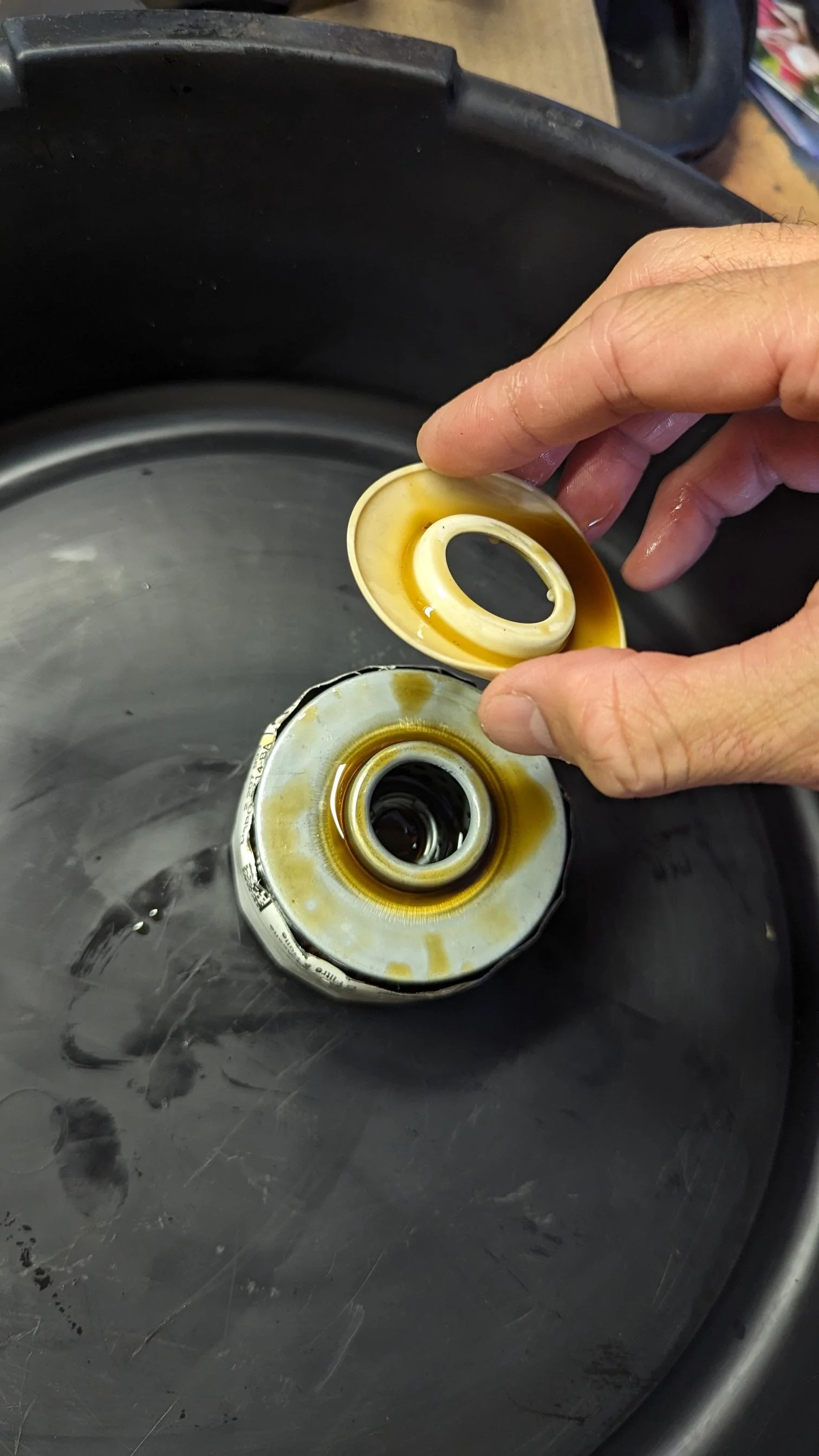

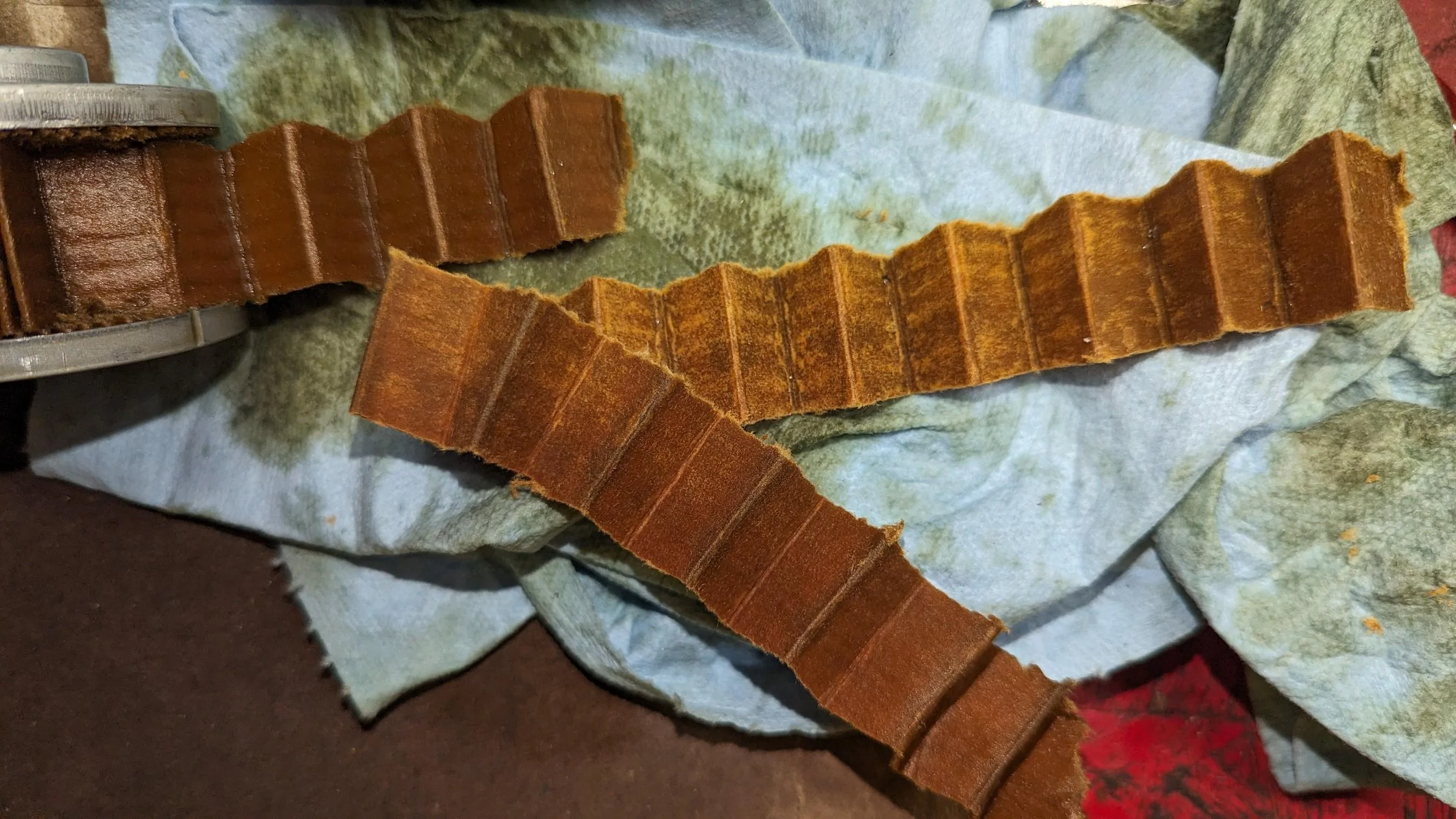

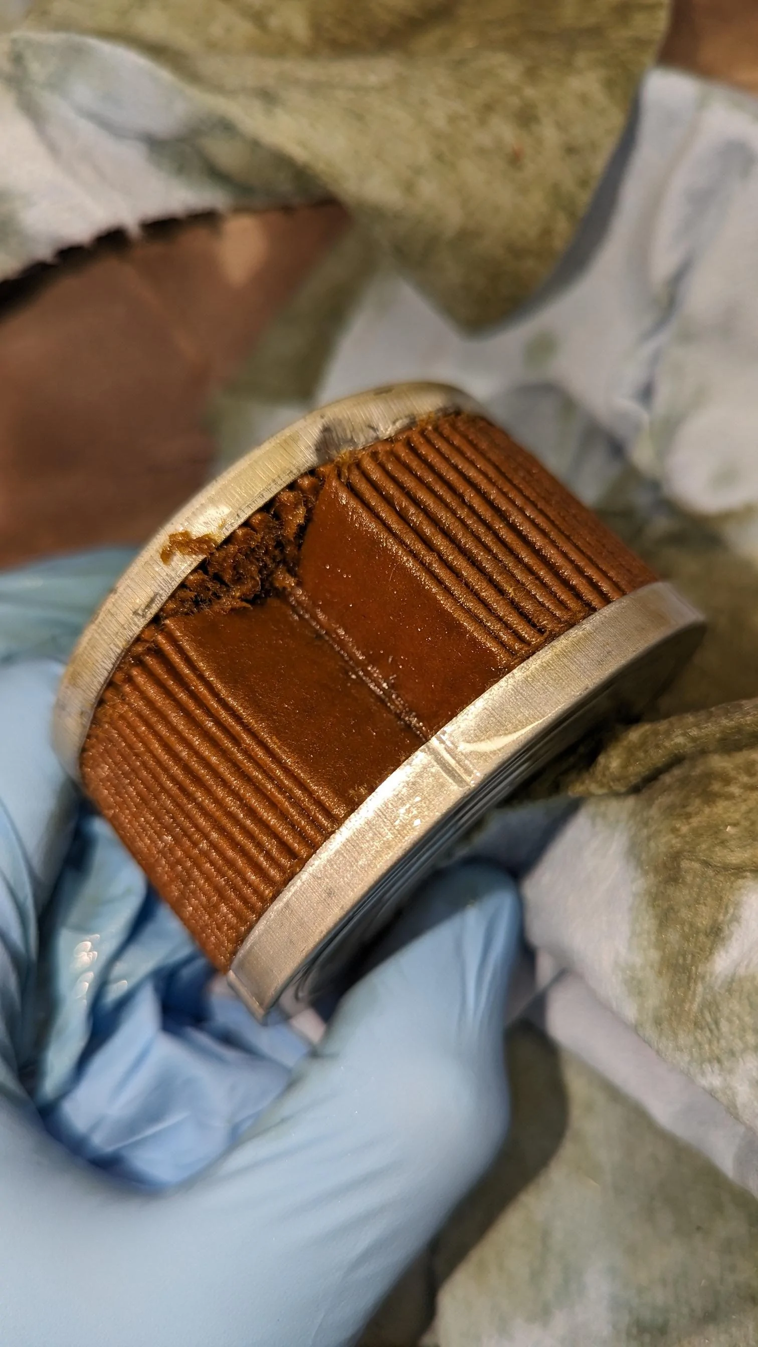

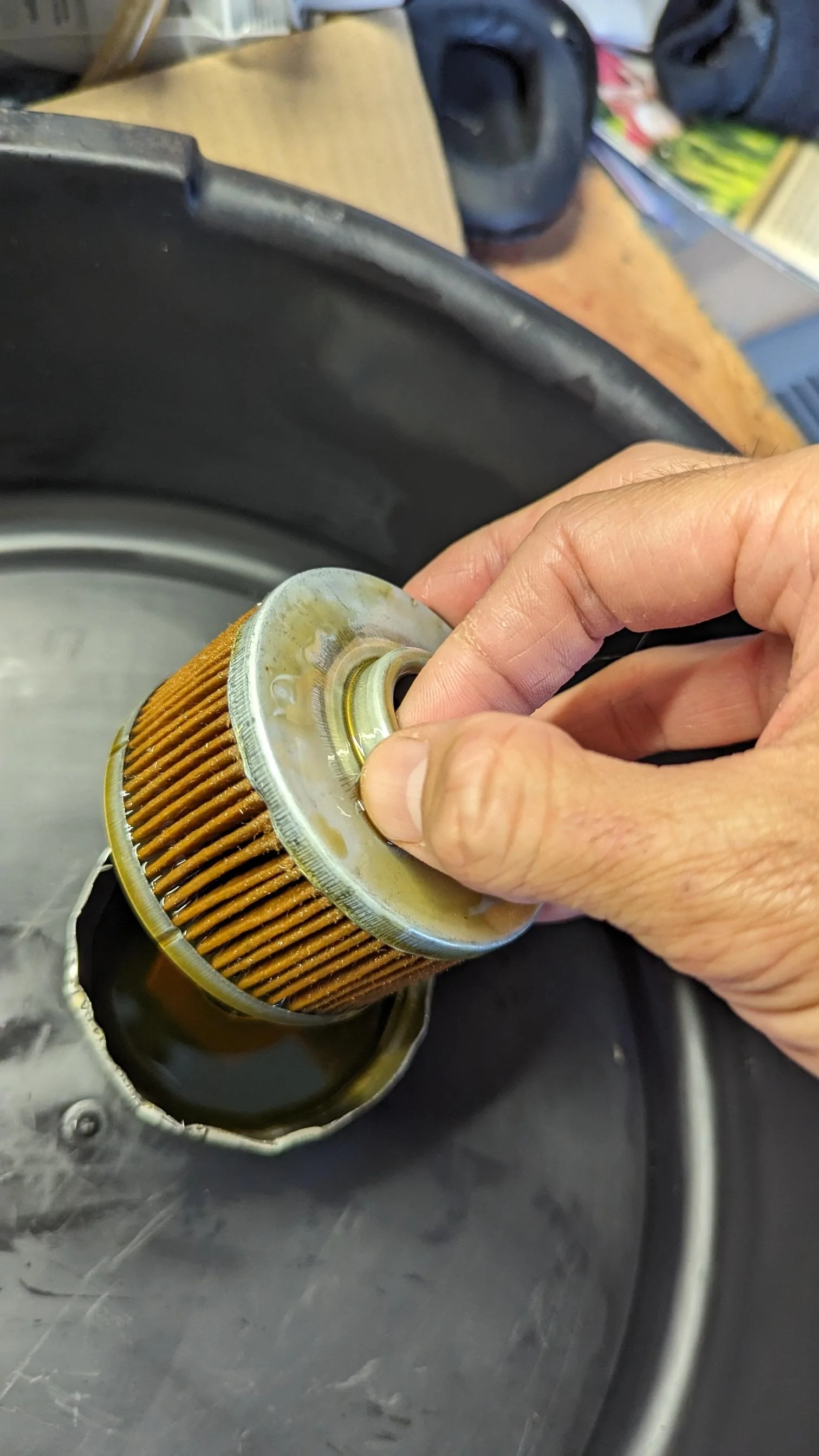

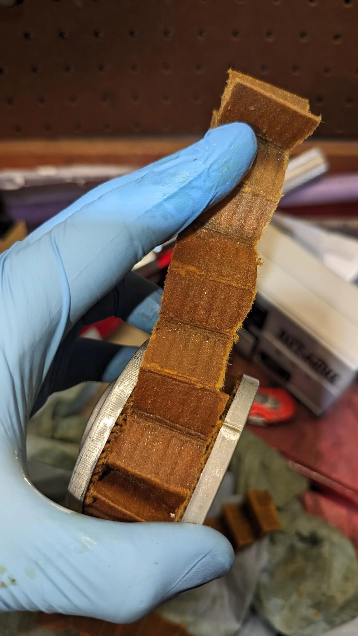

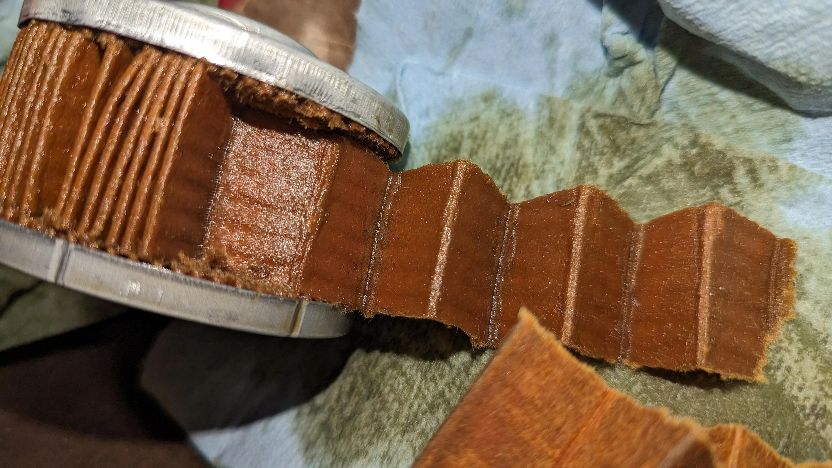

Well thank you.. I do not know the oil flow direction through a filter but after reading this, in the name of science, I went and bought one of the filter openers.. pics below.
For anyone who cares, the findings are; not much sediment but it's there and indeed only on the "outside" facing pleats, which would not have made their way back into the center of the filter, which was the oil that was dumped back into the oil from the pan. Implying there is sediment floating around in my first oil change, yes? But is it a big deal? Eh, it's out.. 🤷
