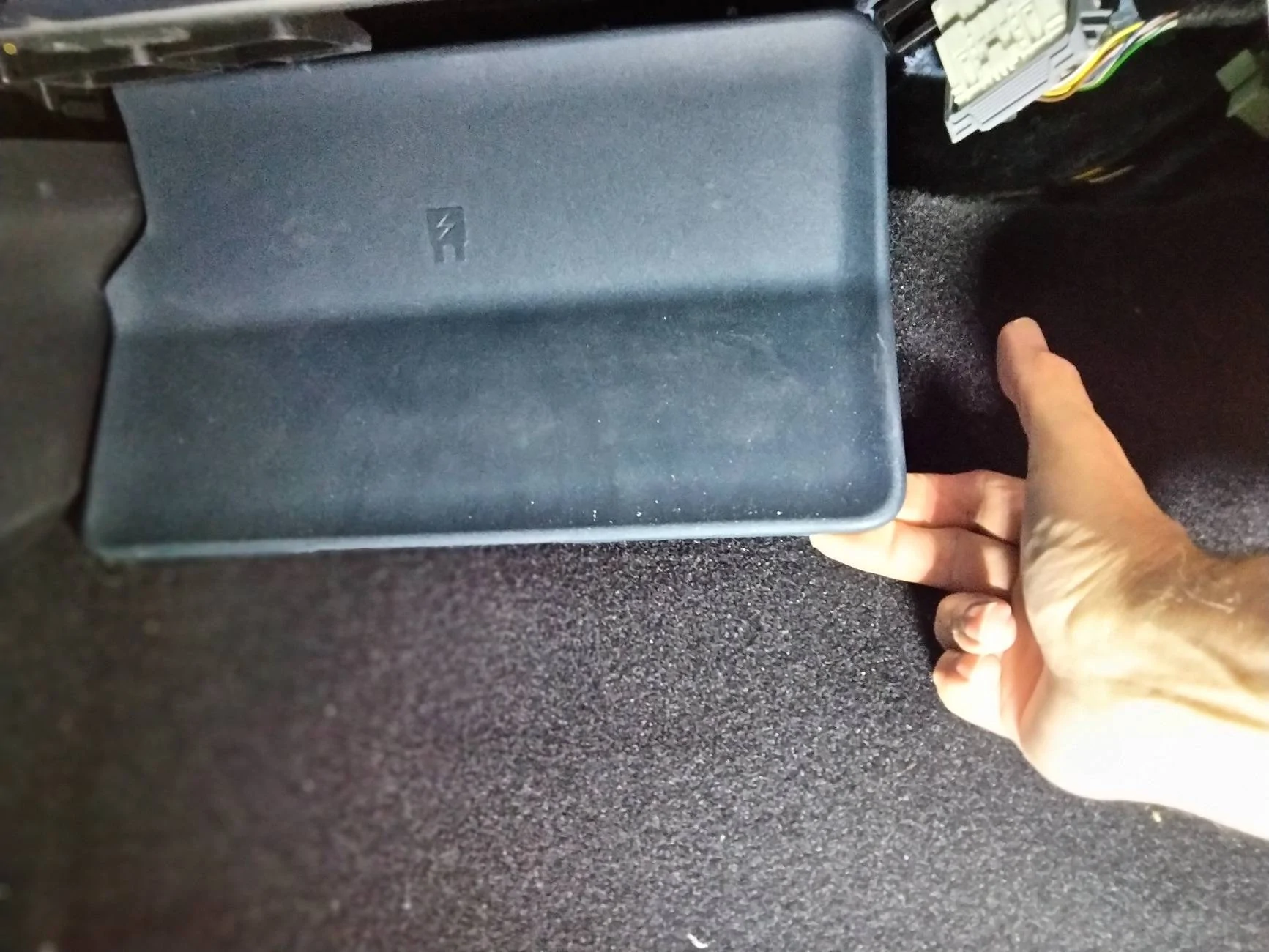

Is it hard to get in to there to access the fusebox?
You do not have to drop and remove the glove box in order to access the fuse panel. You have to remove the plastic cover plate that covers the fuse box. That is done while kneeling down with the passenger door open.
Refer to post #3
This is the panel 👇Passenger side footwell
