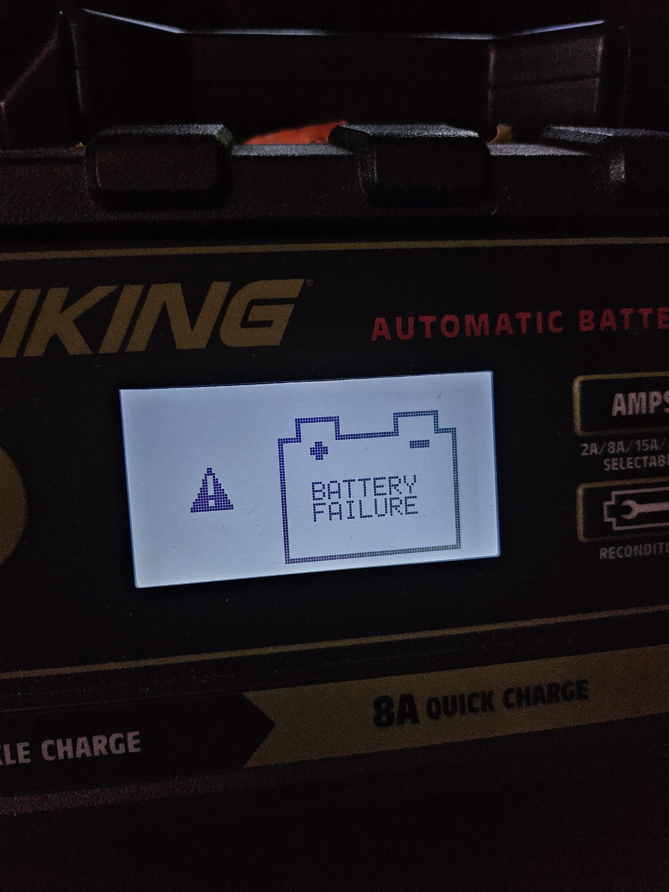

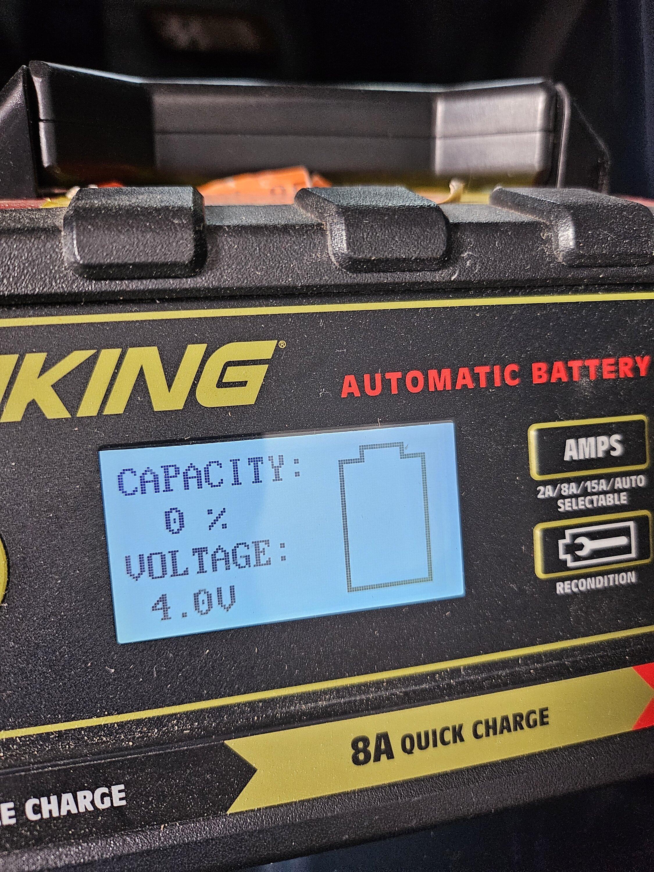

I got my first deep sleep notification in the Ford Pass app last night, Because of all the threads about the issue I wasn't too concerned. However this morning I went out to run an errand and the battery is completely dead! No lights or any activity getting into the truck!
I connected an automatic battery charger, it comes on and shows the battery capacity at zero and the voltage at 4 volts. I left it on for a few hours and come back later to find it says battery failure!
Ford Maverick First Deep Sleep Notification 20240129_141201
Ford Maverick First Deep Sleep Notification 20240129_164427
Called Dealer and they called me back and will have mobile service come check it out tomorrow morning. It will be interesting to see what they say..
Some electronic controlled battery chargers or battery tenders need to see a certain voltage before they will charge. I can't remember that voltage, but if you are too low it may not be charging at all. I keep an old style shop wheeled charger that simply shoots voltage out regardless of the condition of the battery. If you can borrow an older charger like one of those, give it a try.
Here is a little more info on how to get a very dead battery back to life. Maybe.
https://www.chargingchargers.com/tutorials/battery-recognition.html
One of the video's guy says that level to start a charge is 9-11 volts. Anything much lower and a newer high tech charger won't recognize the battery. Time for the old school (my era, as in OLD) regular type straight charger.

I have an old style charger that I had loaned to my neighbor and was not able to try it yesterday.
However Ford mobile service came out this morning and took the battery back to the dealership for testing. They called about an hour later to say the battery was defective and would be bringing me a new one.
They showed up with a new (different battery) and then did the software update for the blinker recall. Here's the battery they installed.
