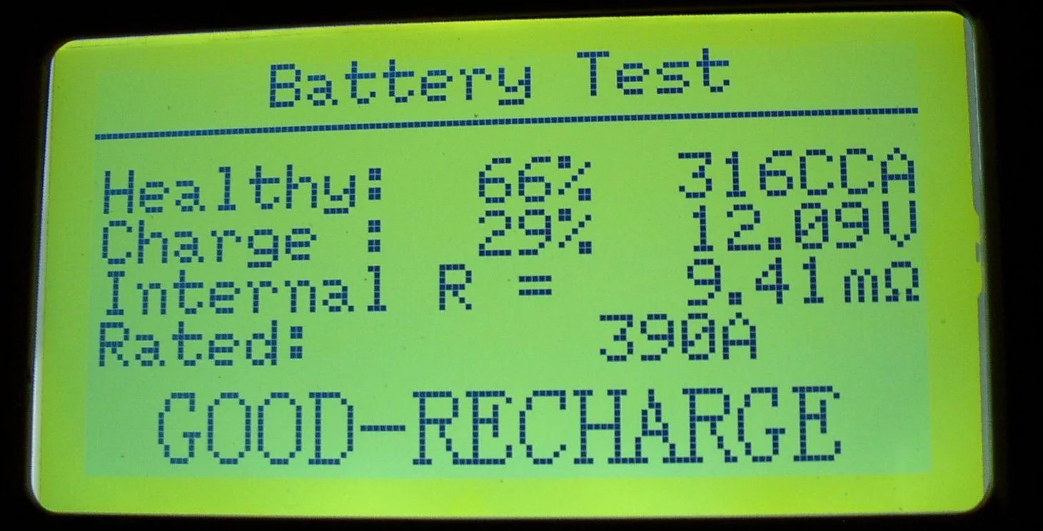

Voltage is only one measurement of battery state.
Battery Charge is more important.
To measure the actual battery state you need a device like the ANCEL BST100 Battery Load Tester.
ANCEL BST100 Car Battery Tester 12V, 100-2000 CCA Load Tester Digital Automotive Alternator Battery Analyzer
When I got my first "Deep Sleep" message on my previously owned Ford Maverick XLT Hybrid these were the results shown using the ANCEL BST100:
Deep Sleep First Measurement shows Battery Voltage of 12.09 Volts but the important number is the 29% Battery Charge.
Ford Maverick First deep sleep - voltage question Tested - Deep Sleep Messag

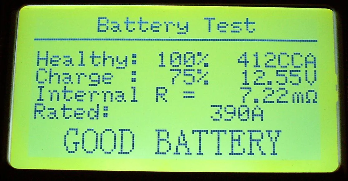

After having the Maverick "Turned On" I.E. Readyed to drive for 30 minutes to have the 12 Volt Battery charged by the Hybrid HV Battery this is now the result:
Ford Maverick First deep sleep - voltage question Tested - After 30 minutes of ON tim
Note that the "Battery Charge" went up to 75%.
And the "Battery State" went from "Good Recharge" to "Good Battery"
