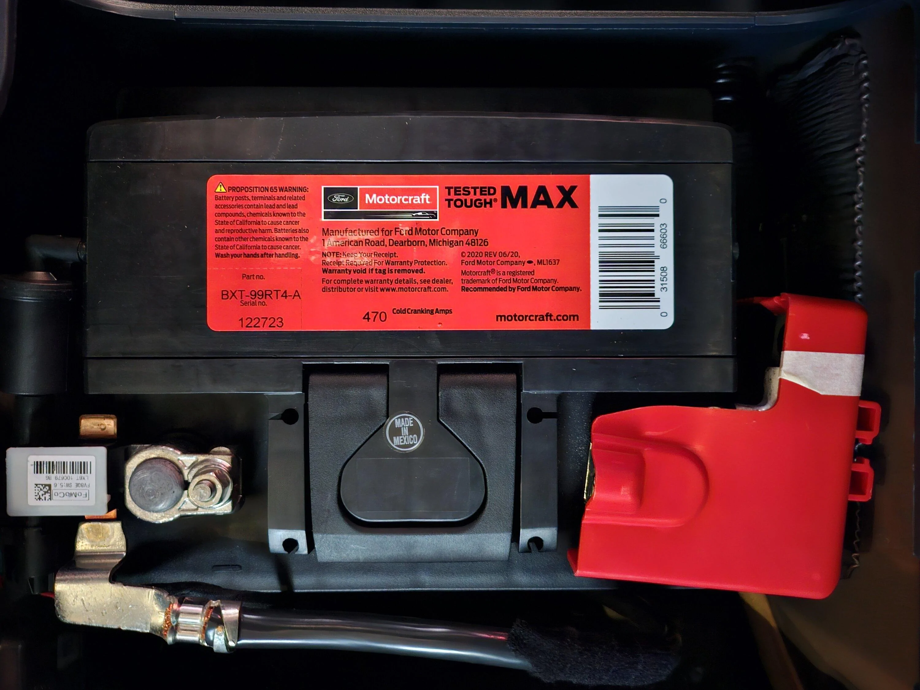

I have an old style charger that I had loaned to my neighbor and was not able to try it yesterday.
However Ford mobile service came out this morning and took the battery back to the dealership for testing. They called about an hour later to say the battery was defective and would be bringing me a new one.
They showed up with a new (different battery) and then did the software update for the blinker recall. Here's the battery they installed.
Nice. That's even better than messing with the dead battery. If mine ever pukes, I may skip the dealer and get a Die Hard Gold I think it is called . Saw where several others here have switched to that one and are having good luck with it. Hope the new MotorCraft one lasts you a long time!
