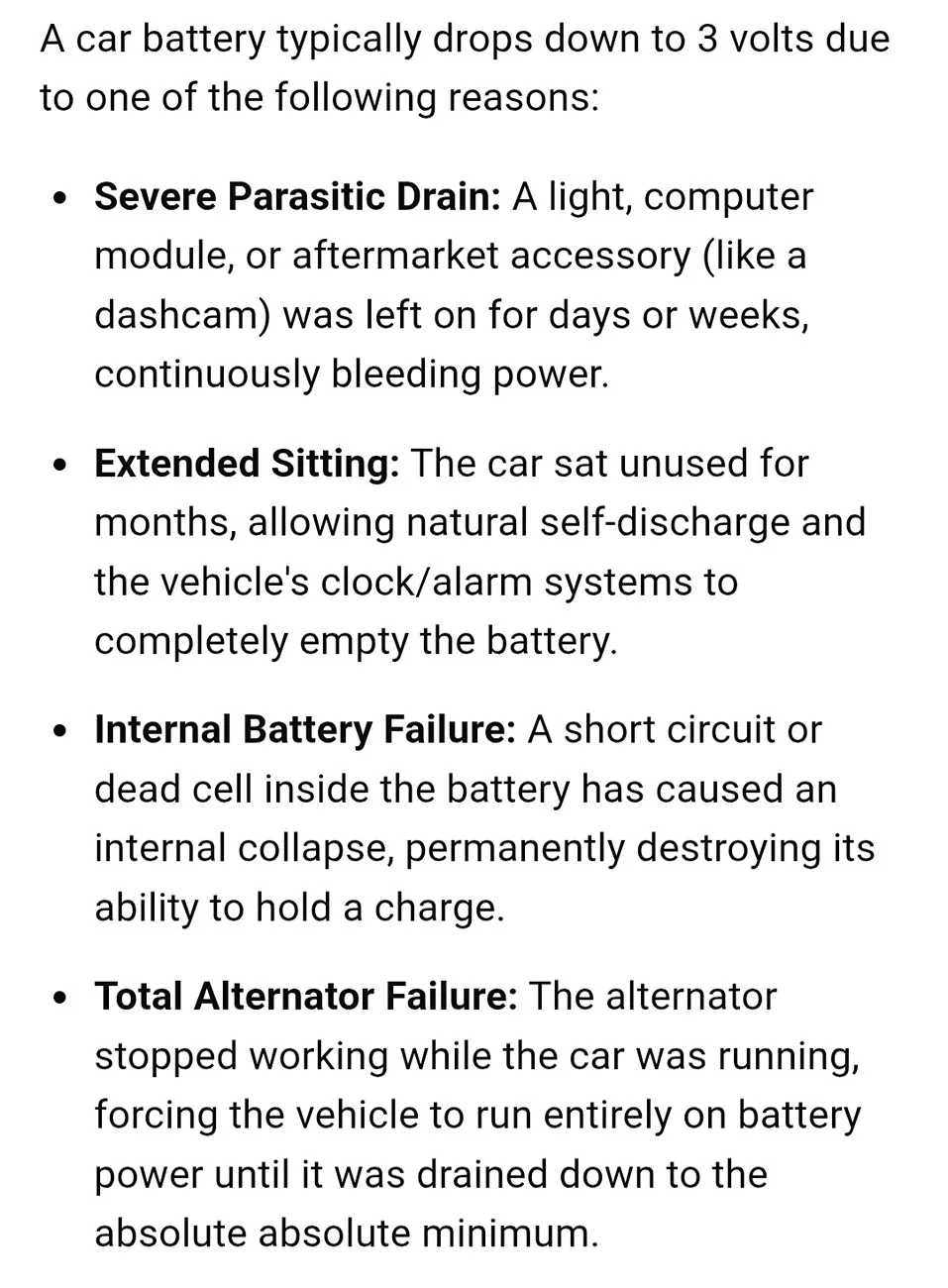

I bought a super capacitor because I won't remember to keep a battery pack charged at all times 😬
So, this tell me they won’t do anything if your below 3 VDC.
I’ll pass.

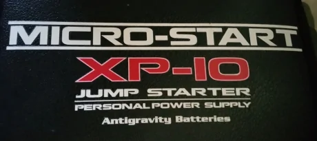

this is so hot . . . capacitors rule!
and it's good to get us thinking of lithium and how this new craze to electric cars is robbing peter to pay paul.
we wanna get away from petro and its concomitant environmental nightmares but then we sidle up to batteries. batteries need lithium which has to be mined and the least regulated and most contaminating industry on earth is mining
water table in bolivia and argentina is being devastated by slag from litihum mines. of course little brown countries don't matter so who cares if their agriculture is threatened . . .
here's my contribution to world hunger: my ole micro-start. got it for 89 bux a few years ago: it's now 200. zowie
great thread y'all--keep hollerin
