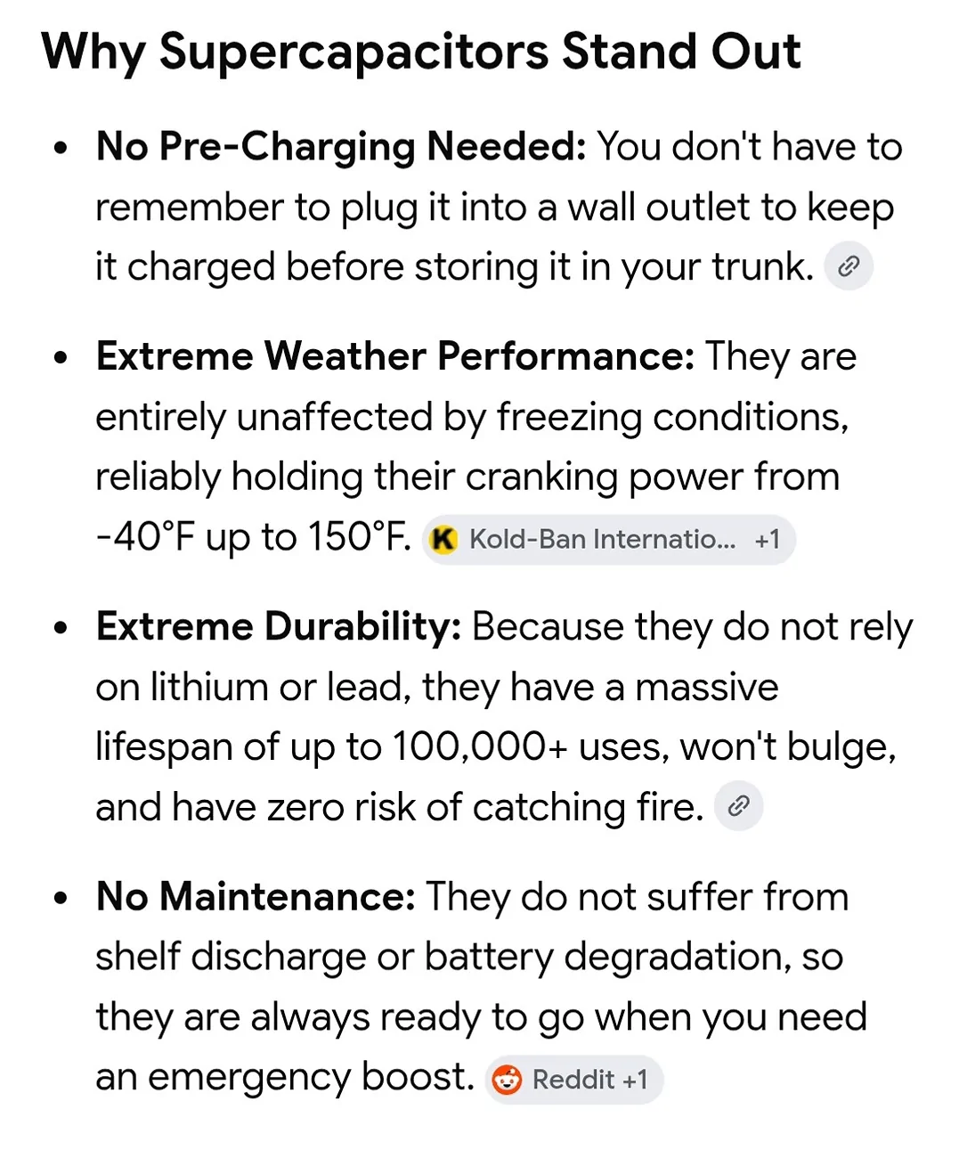

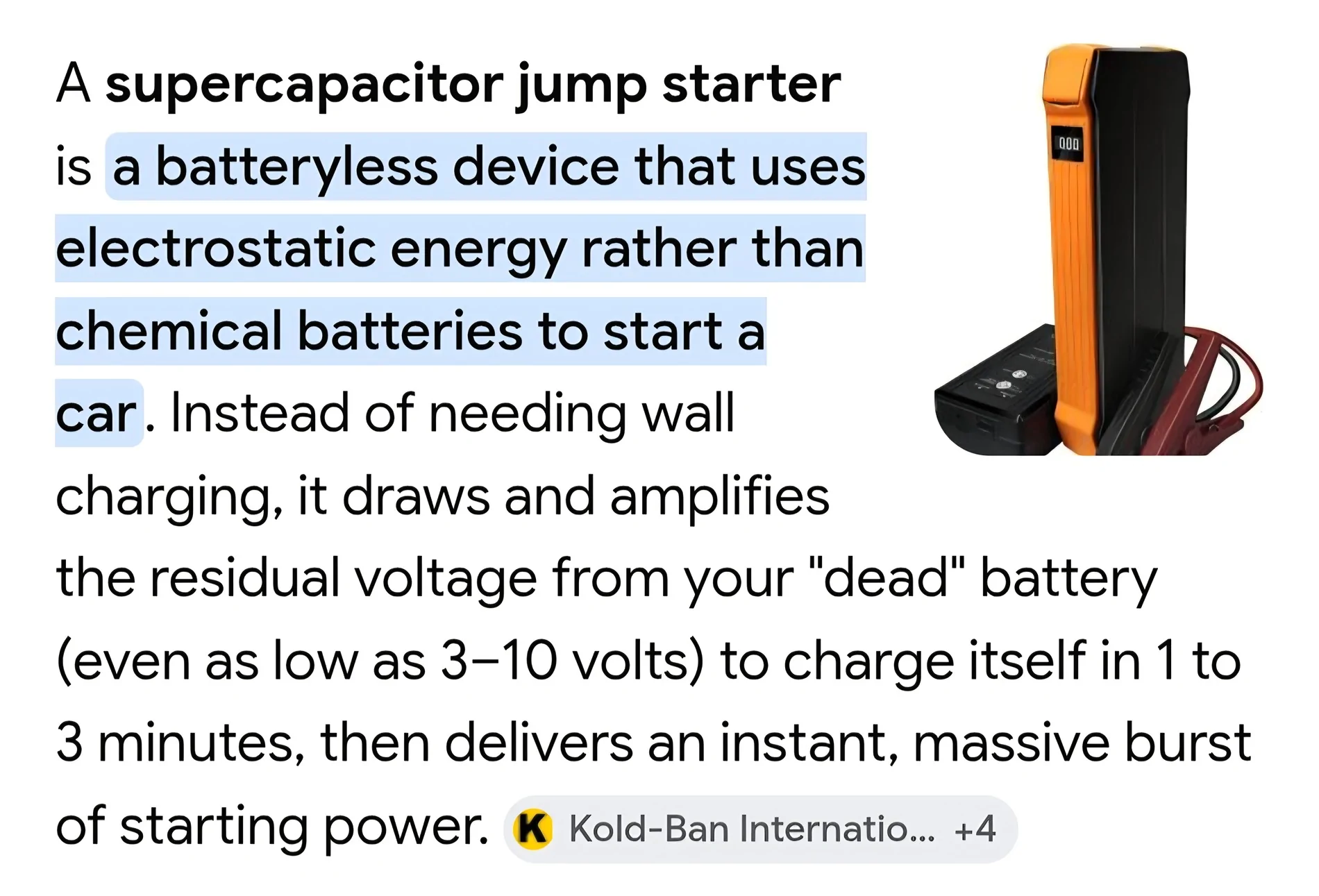

I bought a super capacitor because I won't remember to keep it charged 😬
I was probably lucky I charged it for a road trip fairly recently.
