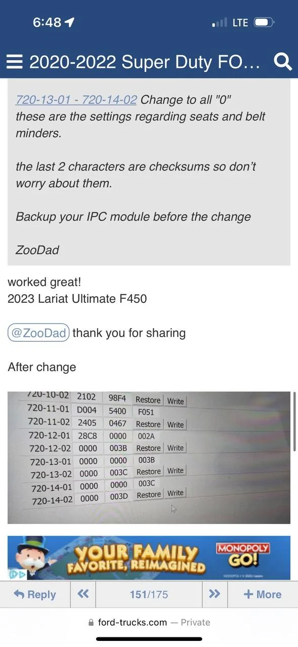

This picture is all I have from f250 forums.
Ford Maverick FINALLY, FORScan coding to disable the Seatbelt Information Screen! (CONFIRMED WORKING) IMG_2894
There should be a way to copy all of your settings from one cluster to another in FORSCAN. I can still dig into the coding to see if there is any splash screen section in the coding but I also have the 4 inch with no splash screen so I can't test it out. Maybe someone with the 6.5 inch screen can test it.

I finally found the way to disable the ANNOYING Seatbelt information screen that comes on when you start the truck and stays on even after you buckle your seatbelt. Thank you to 2023 F250 forums for the coding information.
DISABLE SEATBELT INFORMATION SCREEN
1. Open IPC AS BUILT
2. Change line 720-13-01 and 720-13-02 to ALL ZEROS. And WRITE the changes. Click yes to let Forscan correct the checksum.
3. Change line 720-14-01 and 720-14-02 to ALL ZEROS. And WRITE the changes. Click yes to let Forscan correct the checksum.
These coding changes worked for my 2024 Maverick XL AWD ECOBOOST. These changes remove the seatbelt info screen pictured below entirely and it also seems to disable the seatbelt chime too. I would love to hear from other members to see if these changes work in your Maverick! Also, I have the smaller instrument cluster. (The 4 inch Instrument Cluster)

Check this out! This is worth a try and you can always change it back if it doesn't work! This is also from the F250 Forums.
