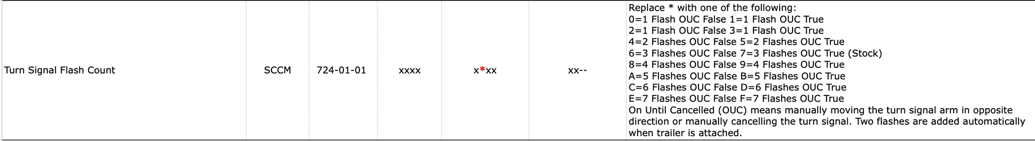

Check this out! This is worth a try and you can always change it back if it doesn't work! This is also from the F250 Forums. EDIT: THIS DOES NOT WORK. The coding must be different for the maverick.
Tried it and it did not work for me on a 24 Ecoboost FX4 XLT

The checksum correction feature in Forscan is doing some heavy lifting with this approach, I'm wondering about the forscan version numbers, for those that haven't had this work. Any updates available that might help that feature work better?
Disregard, I misunderstood.
He is talking about the turn signal coding.
