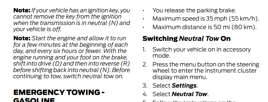

Real world experience here...last trip was 2622 miles. YOUR 2024 manual is DIFFERENT than my 2023 manual.
Ford Maverick Extended Flat Towing 1714141832890-ba
That extra 3 minutes is a new addition from 2023. I put my truck in and out of NT many times during that 2 week trip, NEVER waiting 3 minutes after setting up NT...as the Truck isn't running at that point...you are in accessory mode. But they are telling you to have the vehicle on for 3 minutes to make sure something gets warm during this "each morning and every 6 yours if you drive that long in a day" period. I think it is just poor sentence structure. They still weren't smart enough to tell folks exactly how to make the engine come on, as someone did when they wrote the C-Max towing instructions (step on the gas pedal).

Making me think this morning....
The *ONLY* other thing I could think of would be that the computer might need 3 minutes of being "on" in accessory mode after placing the truck into NT. But that makes little sense to me.
I really think that the 3 minutes is PRIOR to turning off the truck and putting it in ACC in order to put it into NT so that it gets a chance to circulate fluids...ince they did not tell you anywhere to make sure the ICE is running for the "few minures".
But leaving it sit there, with ACC on for 3 minutes after putting it into NT would cover all the bases. Restarting is NOT the answer. If I ever tow our 2024, I suppose I would do that just to be sure, until Ford fixes/updates the manual. @Ford Motor Company ????

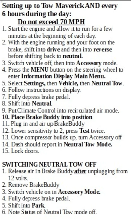

I create cards whenever I set up a towed vehicle and leave them in the lid of the center consoles.
Here is a combo card of Ford's instructions that includes my BrakeBuddy. I never trust my memory, as It is different for each towed vehicles. Note: This is a push button Lariat.
I am going to be using a portable power station to keep the BrakeBuddy charged, rather than wiring a straight socket. Going to give that a try next trip. If you follow my card exactly, the BrakeBuddy will have no power while the truck is being towed...and even though the compresser says there is pressure, it can only trigger and release if there is power (late lesson learned on another vehicle).
