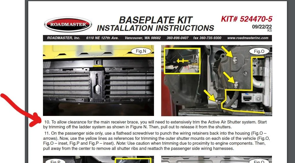

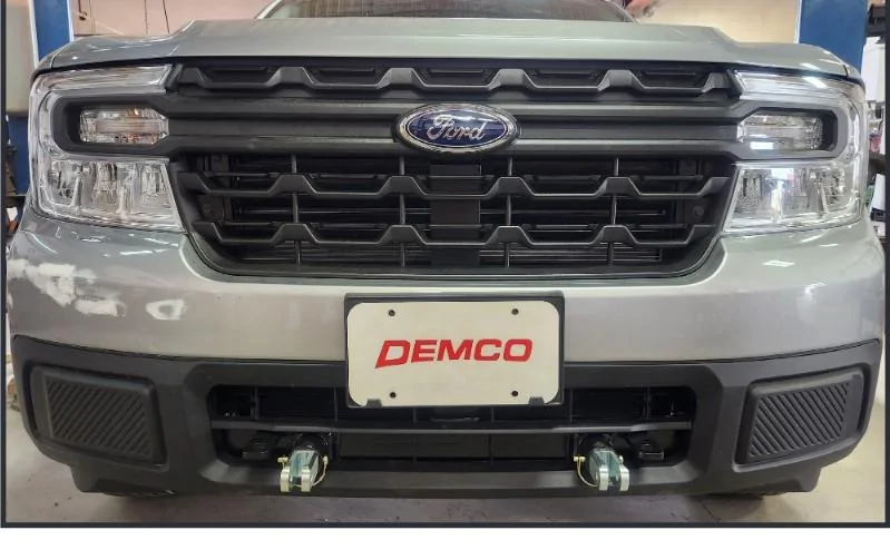

Since this old thread is back live, I am pleased to report that DEMCO has produced a baseplate for the Maverick Hybrid that both looks great AND leaves the active shutters alone. They told me (on 7/17/23) that shipping would start in 3 weeks. MSRP is $655. Etrailer has no ETS yet. They usually sell for at least $75 less than MSRP out. Roadmaster has a $50 converter from a Roadmaster towbar to the Demco baseplate.

Yes. Demco is shipping, as of 8/14/23. $665 + shipping. eTrailer is about a month from having them at a likely much better price. Demco's website wasn't updated the last time I looked on Tuesday, but they responded via contact us.

For a likely $150-$200 savings over the MSRP, I can wait too. I do already have the installation guide:
