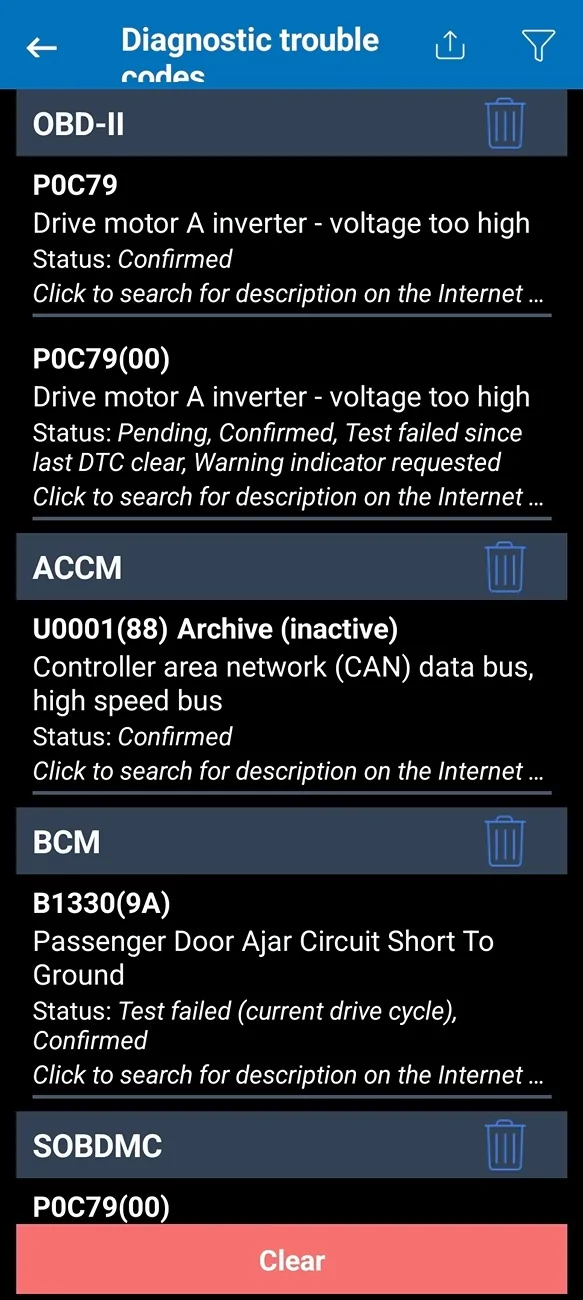

For the second time at start my Maverick engine went to beyond full throttle to redline and bouncing off the rev limiter. This time it lit the check engine light. The next time it happens, I'm walking away and letting it self destruct on YouTube. There are too many unsafe bugs on this truck and I've lost confidence driving it. I'm looking to trade for an Equinox EV.
Ford Maverick Engine runaway at startup Screenshot_20260713_072444_Car Scanner

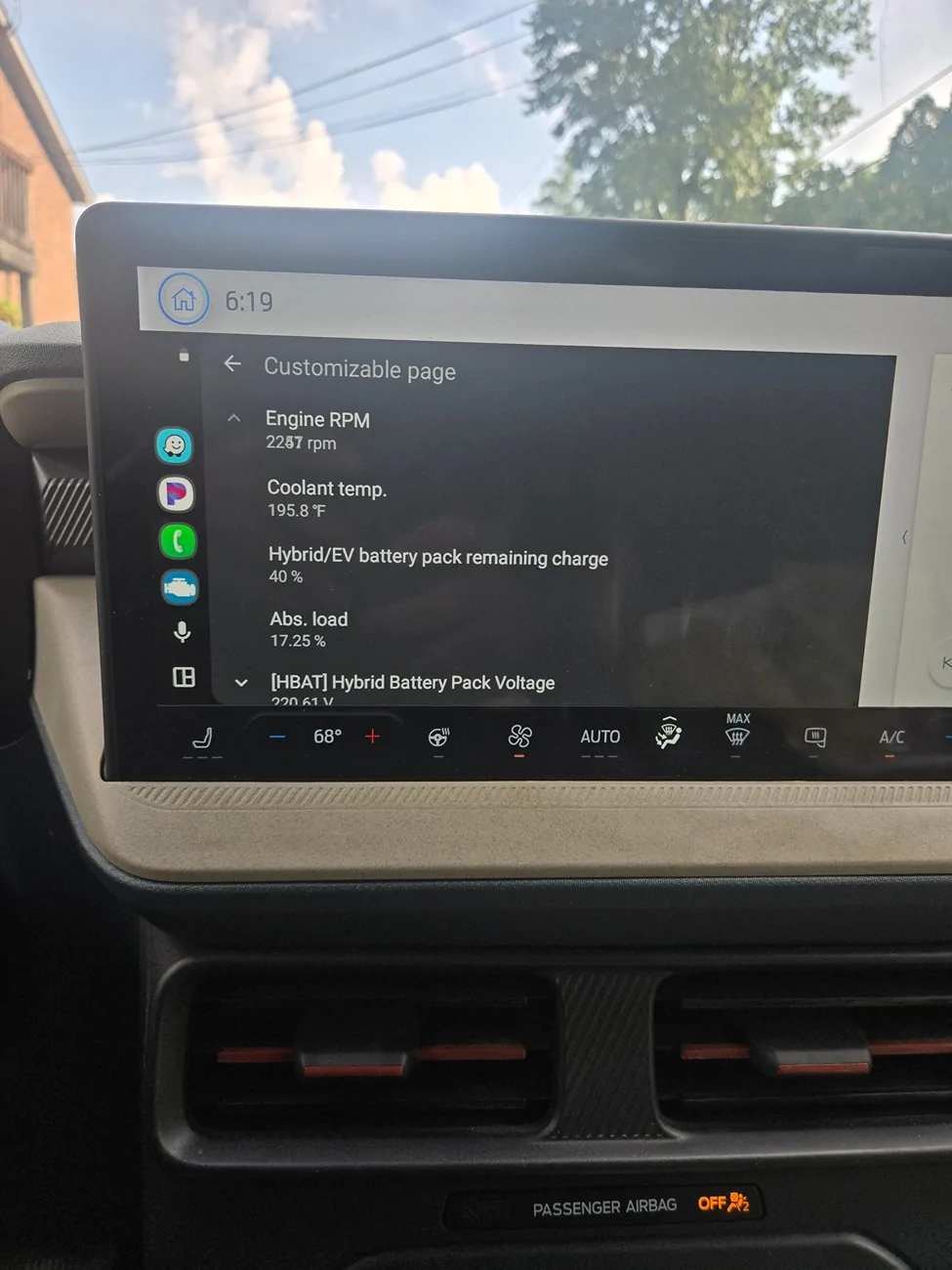

Photo of RPM with accelerator to the floor in park.
Ford Maverick Engine runaway at startup 17843267690817947838555872581766

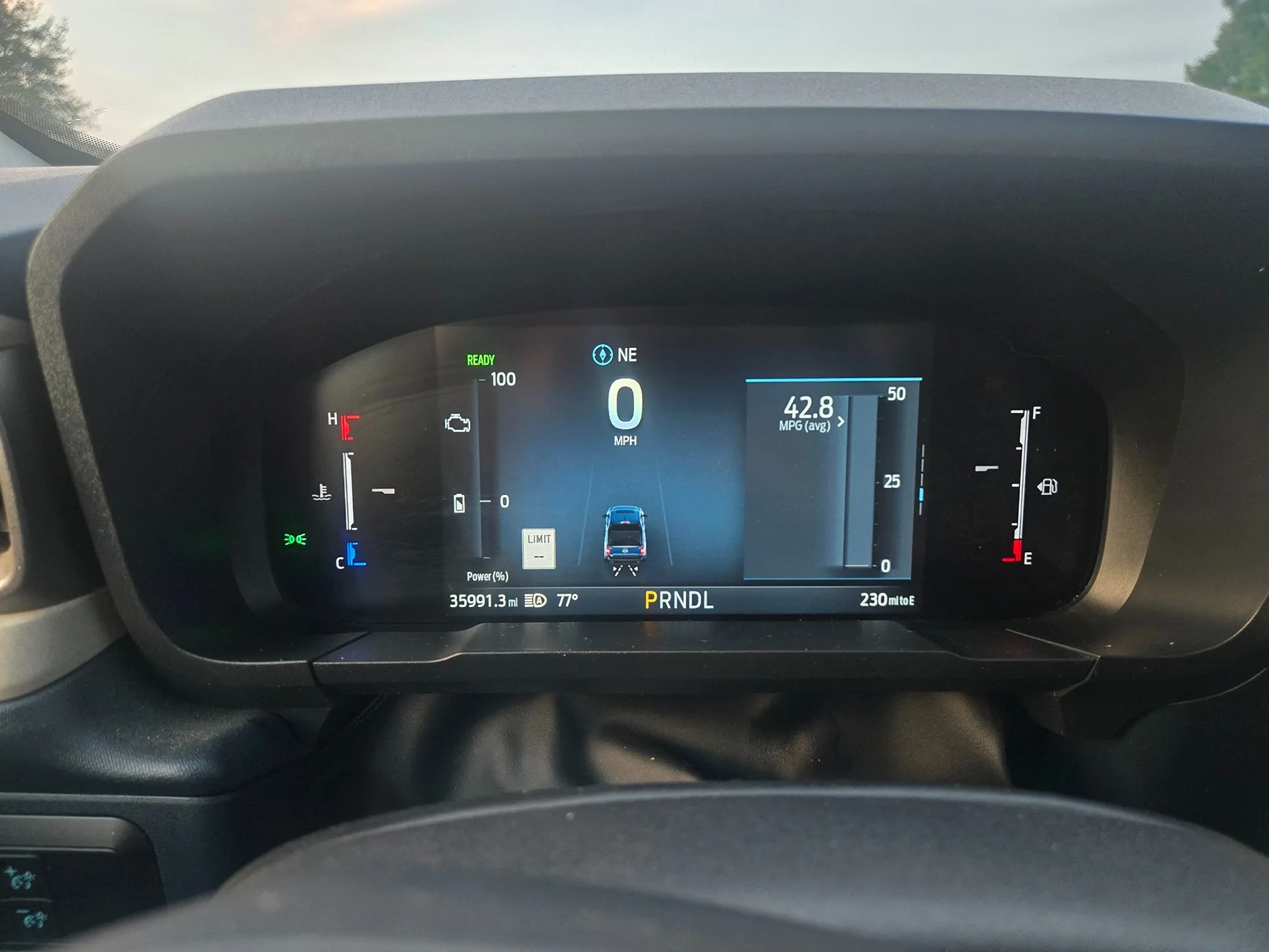

I've had all updates and recalls performed and after two weeks the dealer told me to pick up my truck. He said that the tech that's qualified to work on it "forgot" to perform several checks and repairs then went on vacation. He then gave notice and left. They kept my ticket open until they have a tech to repair it. It's been close to a month now and I won't drive the truck any more. I found another dealer that I can drop off my truck to next week to look at the bugs and failures. It's 8 miles from the 36,000 mile warranty expiring. I'll load it onto my car hauler and drop it off there. I just have to unload my car hauler, because it's got my deck material on it. While swapping out the tires and wheels to OEM, I found several e-brake wire standoff clips broken off from the previous repair of replacing the right rear axle assy, so I'll address that as well. Sloppy, hurried work with no concern of liability since he knew he was leaving that dealership. It's clean and ready for a new home after I address these issues should I decide to. If they can get the bugs worked out, I'll hang on to it for a couple more years. If they refuse or give me a hard time, then I'll drop it like a hot potato.
Ford Maverick Engine runaway at startup 20260805_204311
