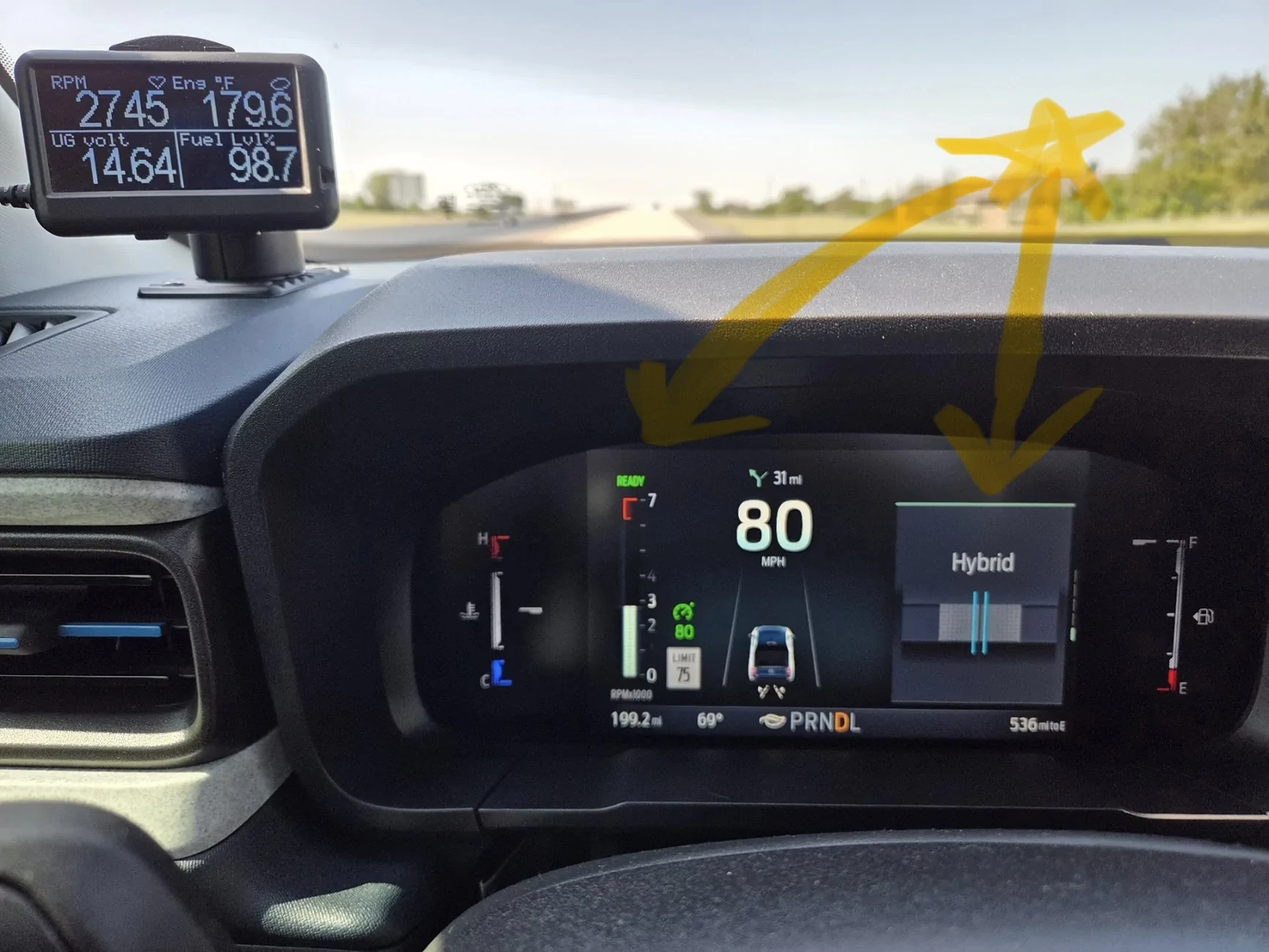

Are you looking at the add-on scanner displaying RPM that is not part of the truck?
No look to the right of the Temp Gauge in the dash 0 at the bottom and 7 at the top it's the same as mine and notice the rpm is just below 3 so the same as his add on scanner which shows 2,745 rpm!!
HeyBales
May 3, 2024
4,953
4,560
KC Metro area
Good eye. all beeee.
I'm wondering if that is engineering mode, or several other posters in other threads thru the year with newer system, complaining about no tach, haven't looked hard enough.

but…. did you notice the HYBRID mode in that dash?
or are you talking about something else?
I missed that, but a tach display isn't an option on the 25MY hybrid I have, as documented in the 25 MY OM, as it gets a power meter instead, noted on page 102.
The tach is noted as part of the display on the 25MY EB on the following page 103.
I had (incorrectly) assumed that was also the case for prior years, but then I don't have one of those.. Thus the hybrid vs EB comment which applies to the 25 - 26 Mavericks.
I don't see much advantage to a hybrid tach, while I like the power meter.

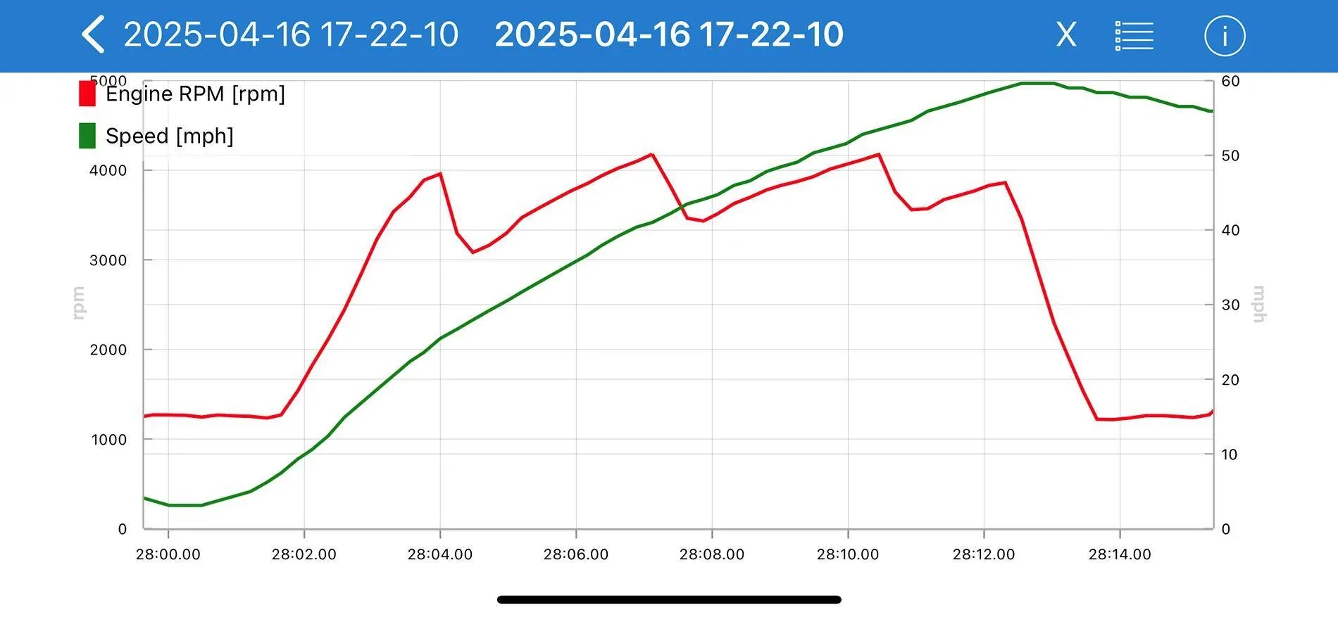

And in the sense of gears - low RPM to higher RPM, shift, low-high, ect.
That actually happens except for the gear shift.
It literally does climb an RPM range depending on if you are really pressing it or calmly increasing speed.
I'm betting that range is around either the best power band or efficiency band for the engine.
Here's an example of the power band really pressing it. Rolling start to 60 in 12 seconds - woohoo!
Thank you @johnDeere.
Ford Maverick Engine RPM at 70 mph for Hybrid 1781119954065-n
This snippet shows the torque when it's done, obtained by changing the ICE and generator/gearing motor RPMs.
