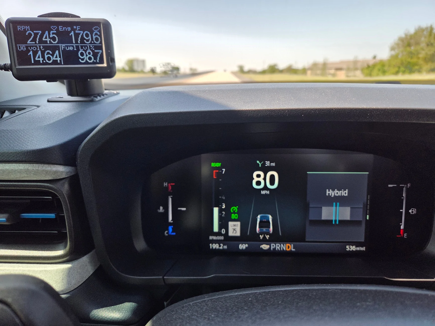

Ford Maverick Engine RPM at 70 mph for Hybrid 20250906_112720
Around 2300 @70. Rpms rise based on load like going up a hill.

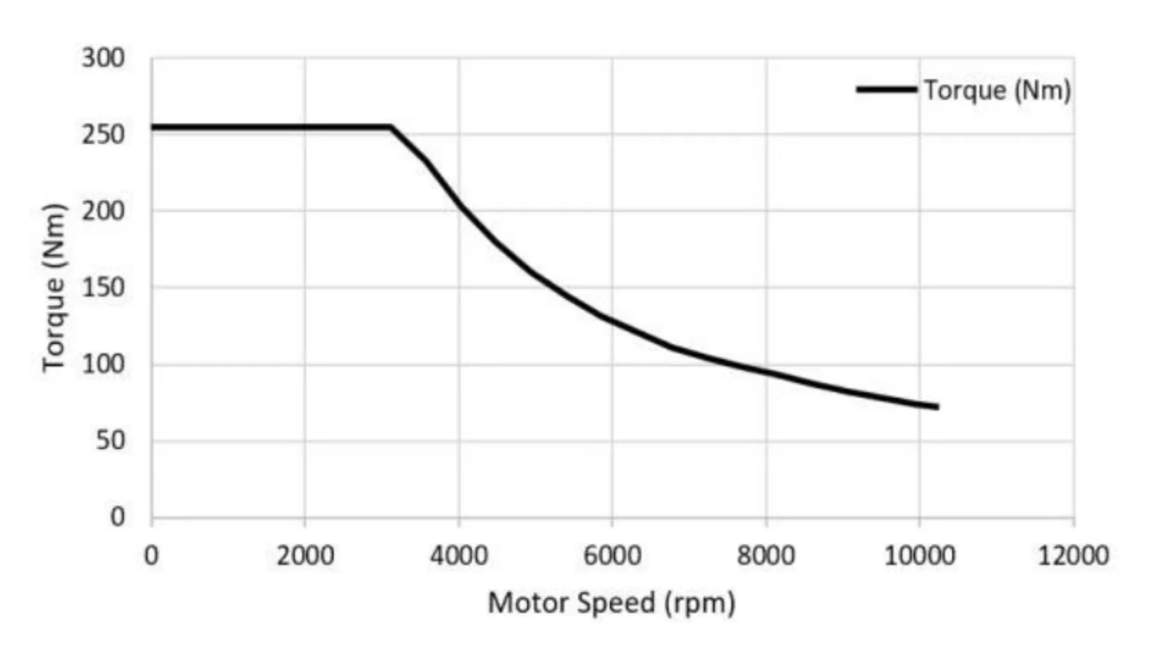

Lower RPM not more efficient.
Look at the ICE graphs in my post above. Star on optimal RPM, which isn't as low as it can go.
Not our Maverick ICE, but probably close enough.

That would take some effort to know as there's MG1 & MG2 plus gear reduction and computer controls at play here. Motors rpm and engine rpm vary with load.
The electric traction motor speed is fixed to output shaft speed. Always 125 rpm per mph with stock size tires.
The generator speed varies in proportion to engine speed when the engine is running. But generator speed is also fixed at 125 rpm per mph in the opposite direction of spin if the engine is off. (2022-2024). Slightly different ratio in 2025+ but same idea.

Found this (mg2 is direct geared to final drive gear). Used HF55 (2025-2026 years)
https://www.google.com/search?q=for...3&sourceid=chrome-mobile&ie=UTF-8#lfId=ChxjMe
Yes but...
AI is quoting information from the HF45 model years 2022 to 2024 and "claiming" it is for the HF55 which was model years 2025 and 2026.
Need someone with an OBDII scanner, set to motor RPM, then drive at exactly 10 MPH and see RPM and divide by 10 to see the exact ratio.
It will be close to the earlier trucks, but probably not exactly the same.

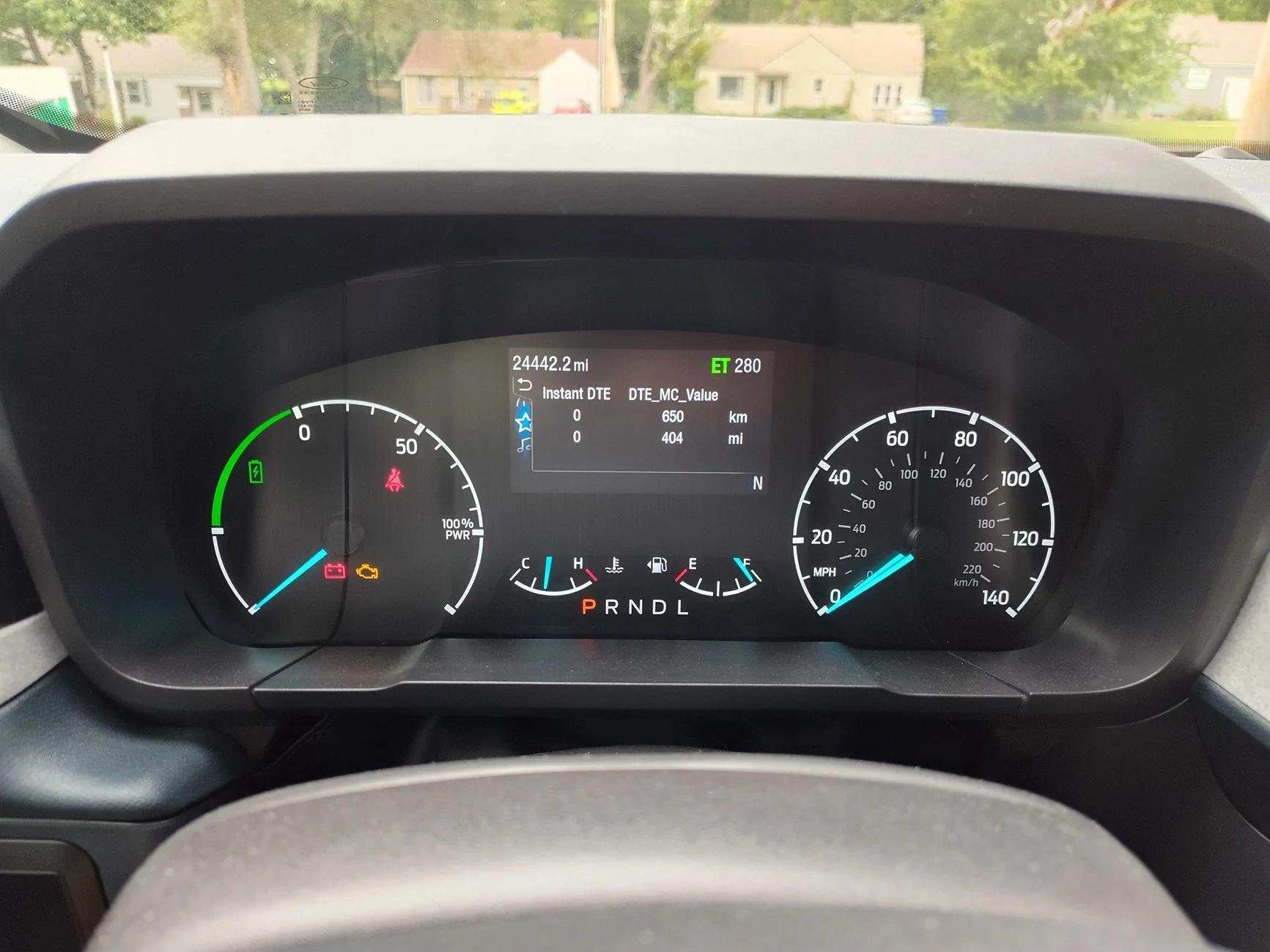

If you want to watch a tach for a normal trip - just to see what it happens to be at different stages - you can go into ET mode and watch a line item.
But you'll be missing other things in center area.
But might be interesting for a trip - like what does it get up to on this on-ramp, what's the initial idle at, what's it going at on this long downhill that sounds so bad with regen air braking.
Also has a value for battery volts - weirdly must be pulling from different place than the PID because mine didn't match.
I also want to investigate this - is this the rolling mile distance it uses for avg mpg it uses for DTE estimates? MC... hmmm.
Maybe I need it running to see something.
