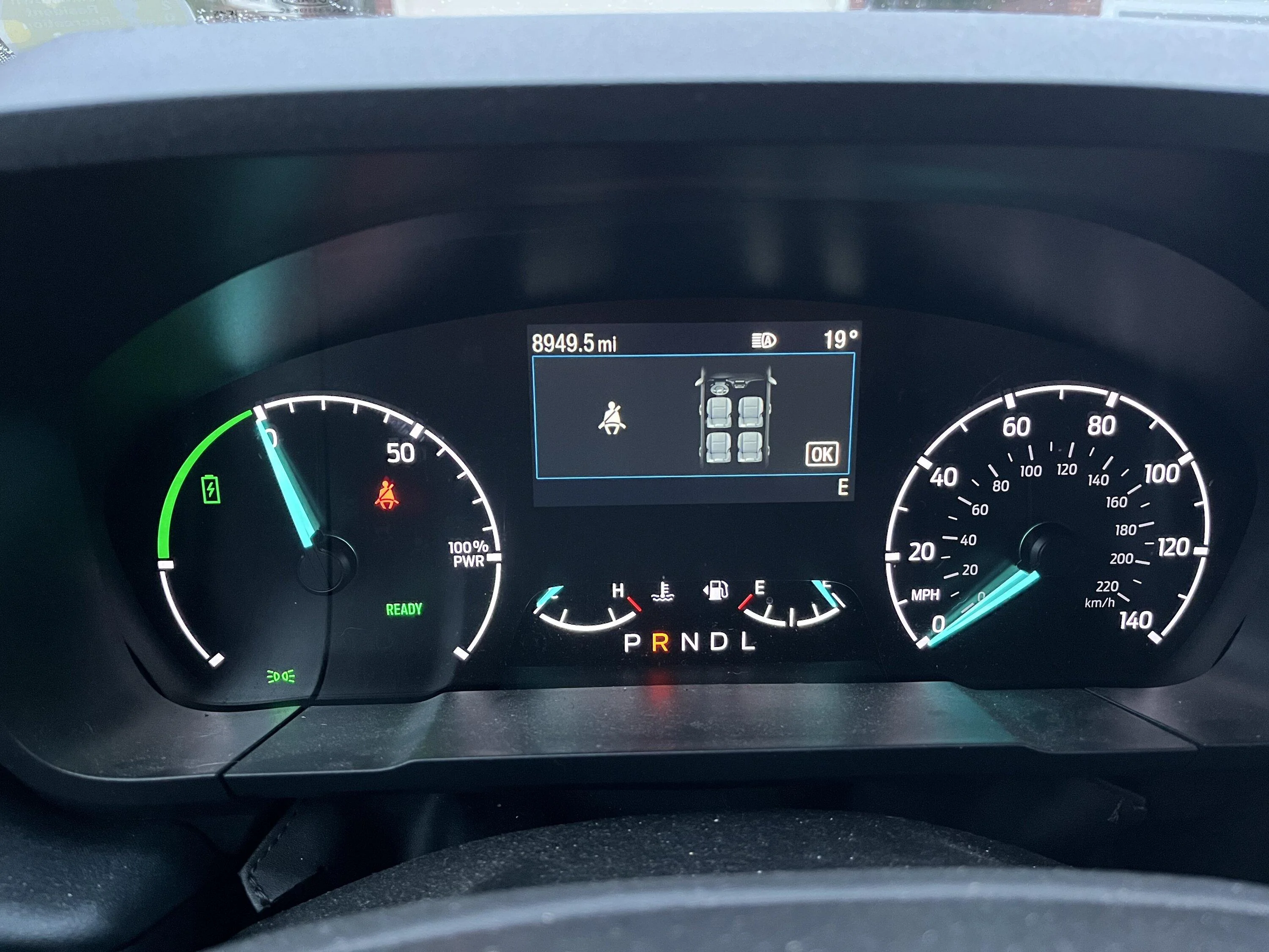

Outside temperature 19 Fahrenheit.
As you hear in the video the car sounded very loud as something was not right. What can that be?the rpm were low.
After engaging the reverse gear, the vehicle got quiet and I had no problem driving afterwards.

...I don't think this is relevant at all. OP's engine has not catastrophically failed, nor has it given any inidication it will do so.
We really have no idea what valve or ignition timing strategy that causes this noise, but it appears to be related. I personally think it is just a little bit of gear chatter from the planetary gearbox that we call the eCVT.
As you noticed @Peps it went away as soon as there was torque applied to the drivetrain and any lash in the system was taken up. It is also possible that due to the cold weather your truck was in a "warm up idle" state at 1500 rpm instead of 1250. I.... wouldn't lose any sleep over it. YMMV.

Engine damper sticking / chattering.
I'd bet the ranch on it.
I have heard this many times and from many owners. (Including my own before it was replaced under warranty.)
It can happen at any time at any temperature. Just recently seeing more posts about this in cold weather.
Maybe lubrication hardens.
Maybe thermal shrink exacerbates this.
