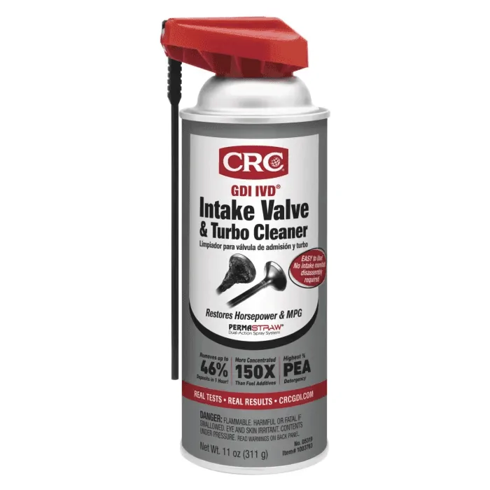

This is only for non-turbo charged engines!!! It will ruin the turbo on an ecoboost.
Maybe this CRC product will work.
Safe on Turbo and Super Charged Engines
GDI IVD® Intake Valve & Turbo Cleaner is effective on turbo, super-charged, and twin turbo systems. It will also work on engines with port fuel injection (PFI engine). It will not harm the oxygen sensor or catalytic converter.
Ford Maverick Ecoboost engine question -- prevent carbon build up in the cylinder head? 1681402311085

I would not recommend spraying any solvent cleaner into a running the ecoboost engine unless you want to destroy the turbo.
Walnut blasting or manual scraping is the only method that works.
CRC claims it is safe for turbo engines. I do understand your reluctance though.
Where is it squirted in?
Does the fall under warranty?. Also, it sounds like head removal is not necessary, but only the valve cover.
