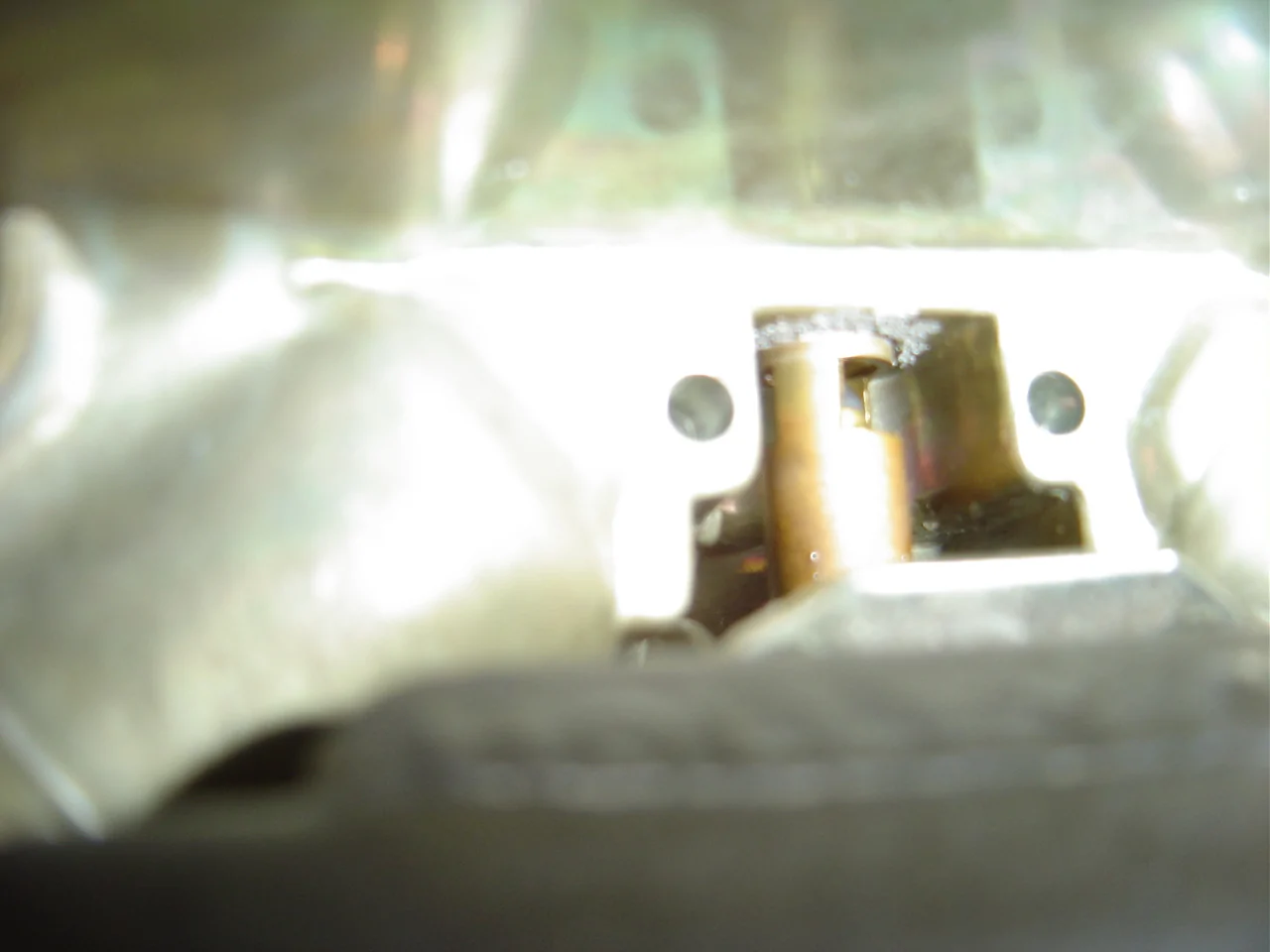

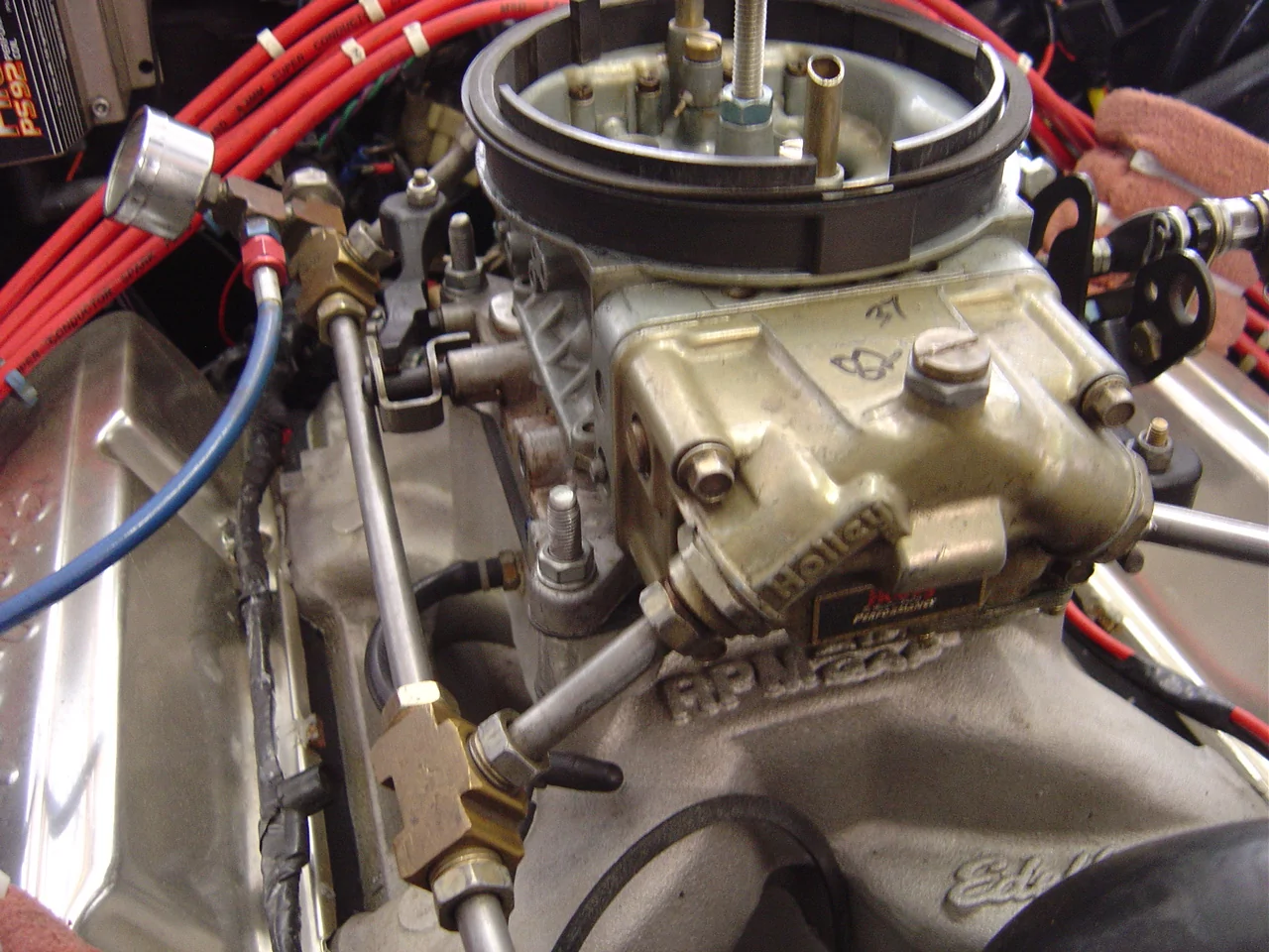

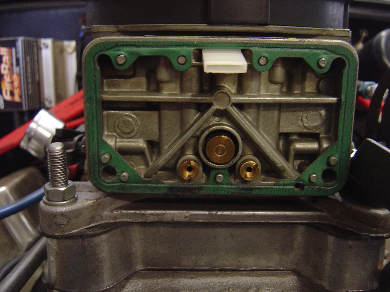

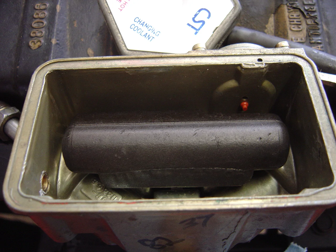

I've written articles on ethanol as a racing fuel, first published in 2005. Did a LOT of research in the process with lots of ongoing testing in both carbureted and electronic fuel injected vehicles.
Ethanol only leaves deposits if it evaporates. It is my carb cleaner (E85) of choice as it strips varnishes and other crappola as good or better than Gumout or the more caustic carb soaks. And... it's really cheap in comparison!
While seeing about a 2 mpg drop in overall economy, Brett runs like Jack the Bear on E30 and I know it's keeping that nasty stuff out of the lines, pump and injectors in the process. I also use a bottle of Techron every 10K miles in a full tank of gas. It's also that tank that I'll run below a quarter full, otherwise I fill between a quarter and half at least! The more in the tank, the less opportunity for condensation and "Phaze Separation". The turbos and computer tuning love the slow burn and higher octane of the additional ethanol. But, more power and fun do come with a price, though the reduced purchase cost almost breaks even in cost per mile.
Ran it first in my 74 Cuda in the original tank, stock rubber hoses and mechanical fuel pump without issue. I did use non cork gaskets, especially on the Holley carburetor as the ethanol will dissolve the solvents in the glue that holds the cork chunks togeter. Ran it from 2005 on street and strip through 2020 when I sold it. I don't know if the collector that bought it converted it back but I did give them all the carb parts needed if they did. Only "problem" I ever had was some white residue in the carb from over winter storage evaporation. Otherwise everything was squeeky clean! (See Photos) Tank was kept full with the cap vent taped over, so no chance of water infusion and no room for Phaze Separation. There are lots of rumors and miss claims out there but most stems from confusion with that other alcohol fuel, Methanol, which is some severely nasty stuff!
