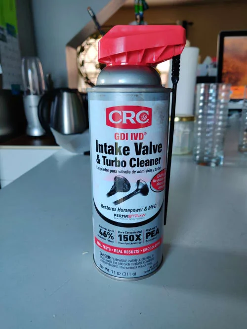

I use the CRC intake valve cleaner on my wife's DI 2015 Honda CRV every 20,000 miles. Many disagree but for $10-12 I'm comfortable using it. I spray it in the brake booster port on the intake.
I bought some of this with the intension of using every 5000 miles or so, but I am concerned is there any sensor that could be damaged by using this or & I wouldn't want to spray it into a hot turbo.

Can't speak for the CRC product, but Berryman says their 2611 Valve/Combustion chamber cleaner is NOT safe for MAP sensors. There is a MAP sensor on the left front of the intake manifold. There's no way around it. I will remove and plug the hole while appling this product. Looks like there is an EVAP Line port on the left side with a quick-connect, just above the throttle plate assembly. Should be a good location to inject the cleaner.
