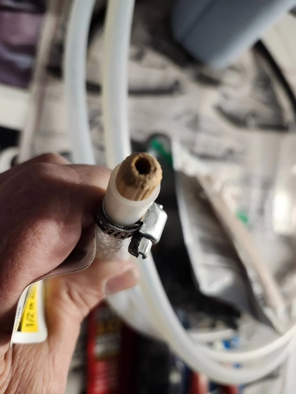

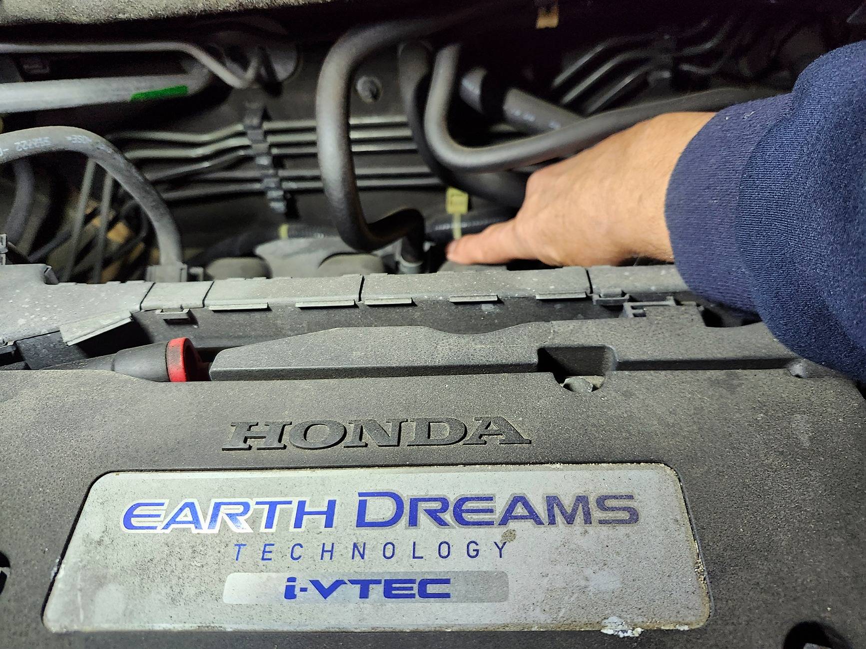

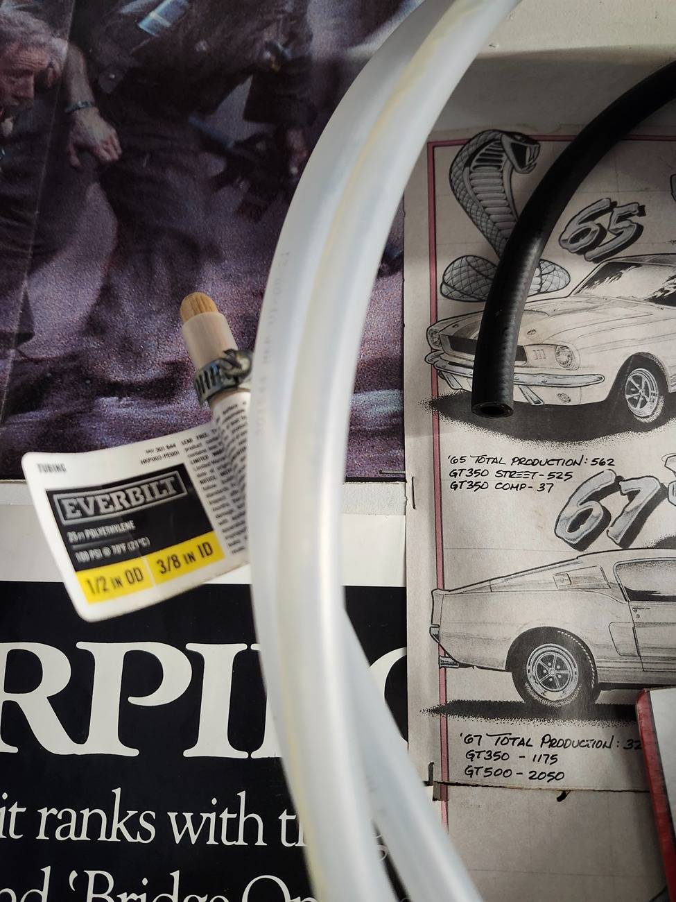

Apologies to MTC for a little thread high jack 😀
Here are pics of intake and hose I use. I drilled out a wood dowel for the spray can hose. Hose is long enough to reach driver's seat so I can keep RPM around 2500 while spraying the cleaner.
Ford Maverick Top End cleaner to prevent carbon buildup on valve stems. 20250410_192701
Ford Maverick Top End cleaner to prevent carbon buildup on valve stems. 20250410_193028
Ford Maverick Top End cleaner to prevent carbon buildup on valve stems. 20250410_193051
