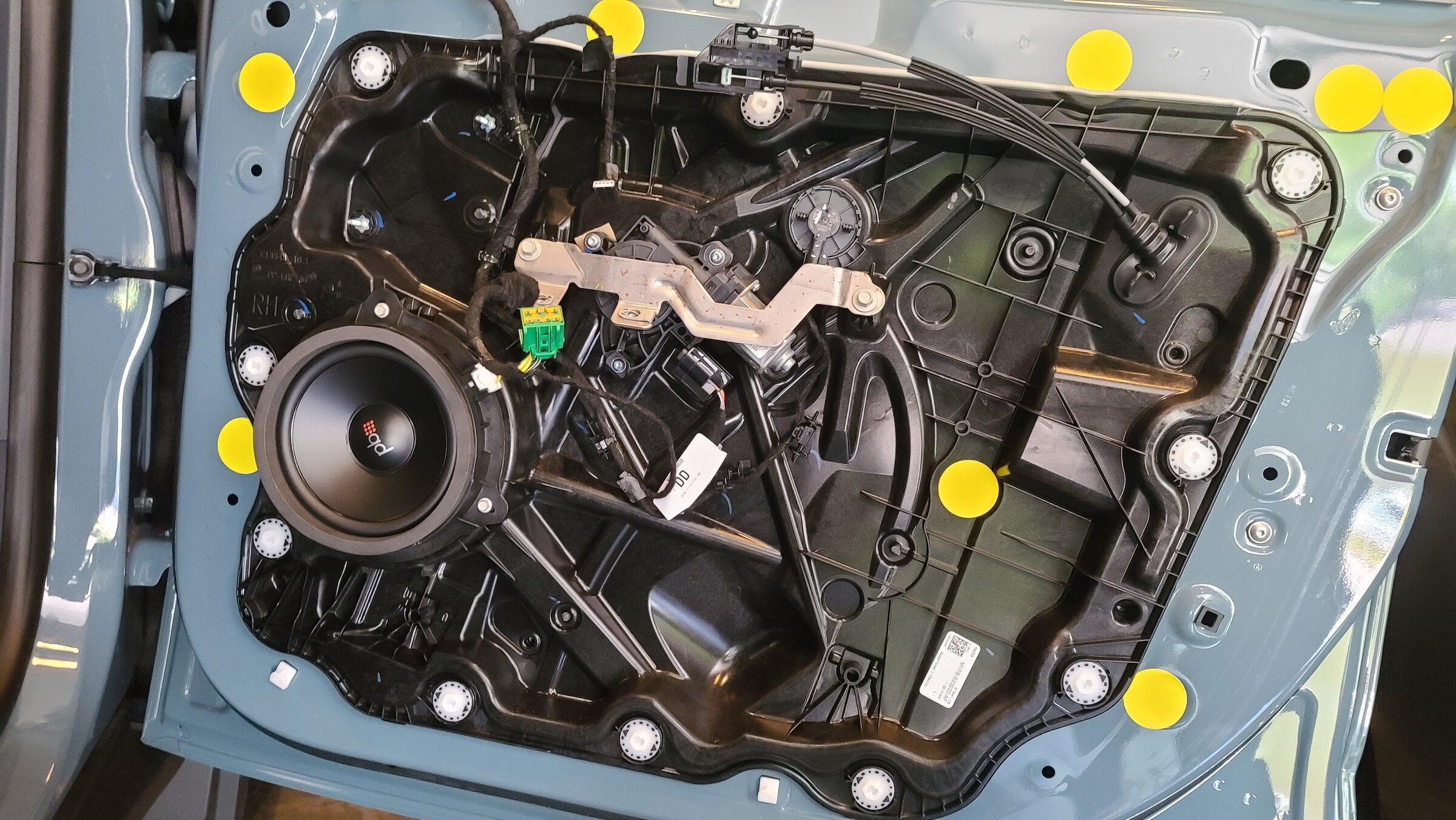

Just finished installing the door speakers and tweeters, added some kilmat to the inside of the door panel while I was there. The tweeters took a minute to figure out but plugged right in. Only managed to break one clip. To me it's a big improvement over the stock speakers.
Ford Maverick Easy Speakers Upgrade -- drop in and no existing modifications required 20220604_122935
Ford Maverick Easy Speakers Upgrade -- drop in and no existing modifications required 20220604_123613

ProTip: Empty the entire box and check for all contents before installing.
I was wrong. This is plug and play. Not until I installed the 2nd woofer did I find all the plug and play adapters. Much easier that way.
