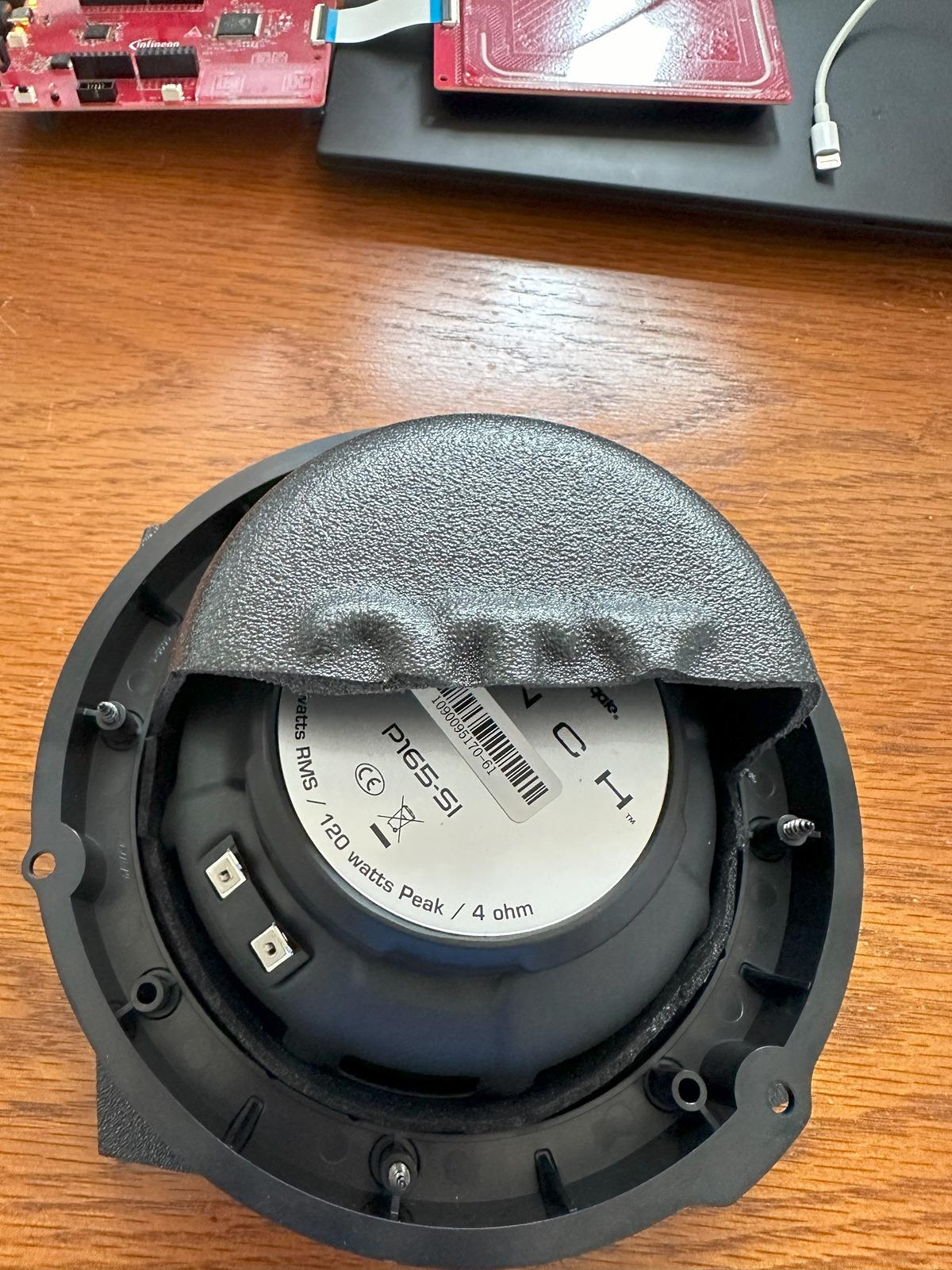

Thought I'd show what I did in my Mav (EB XLT). I combined a number of different ideas I'd seen on here; I apologize to those that I borrowed from that I didn't take notes on who originally posted what. Goals were to improve sound quality, while keeping everything in a state where I could easily go back to stock.
I started with a set of Rockford Fosgate Punch P165-SI seperates for the front. These have the crossovers for the tweeters built into the woofers, so I ended up using the factory wiring to power the woofer, then running new speaker wire from the woofers through the door jams and up to the dash. Removing the doors, while intimidating on a truck with less than 500 miles, is actually pretty easy. Have a floor jack with a rubber saddle and a second set of hands handy. Takes all of five minutes to unbolt it and another few minutes to unplug the wiring connector.
I used some XTC speaker baffles behind the woofers to try and keep water off the woofers. I cut them with a utility knife to create a "ledge" that leaves the bottom halves exposed so the sound wasn't compromised, but would (hopefully) force water to run off the baffles and drip down past the woofer.

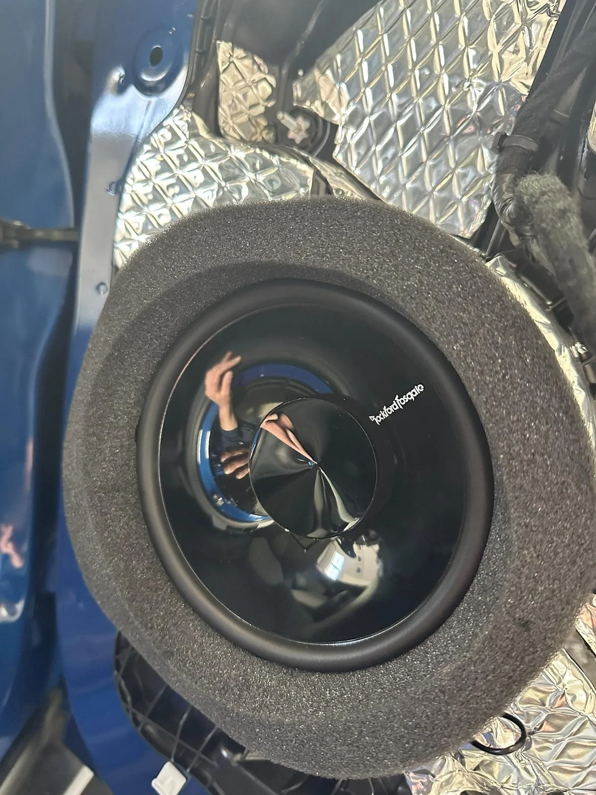

Used some foam rings on the top of the woofers before installing. These woofers fit the Metra 82-5605 speaker mounting brackets perfectly. The 72-5602 speaker wire adapters also fit correctly.

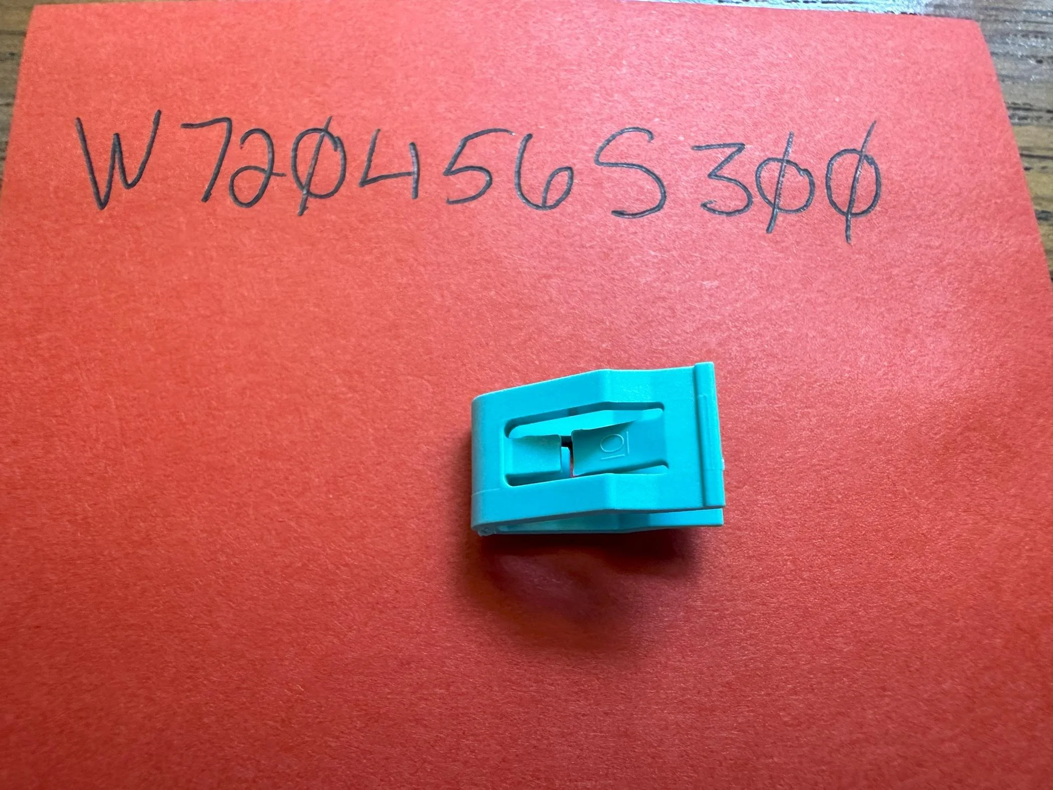

One note: when removing the tweeter speaker grills, I dropped several of these blue clips that hold them on into the dash. They eventually worked their way out, but in the meantime I bought a bag of them from Ford (I also broke one). They were like $6 for five of them. The part number is W720456S300. They also hold on some other dash pieces like the climate control panel. You may want to consider proactively ordering a bag of them; they are easy to break/lose.

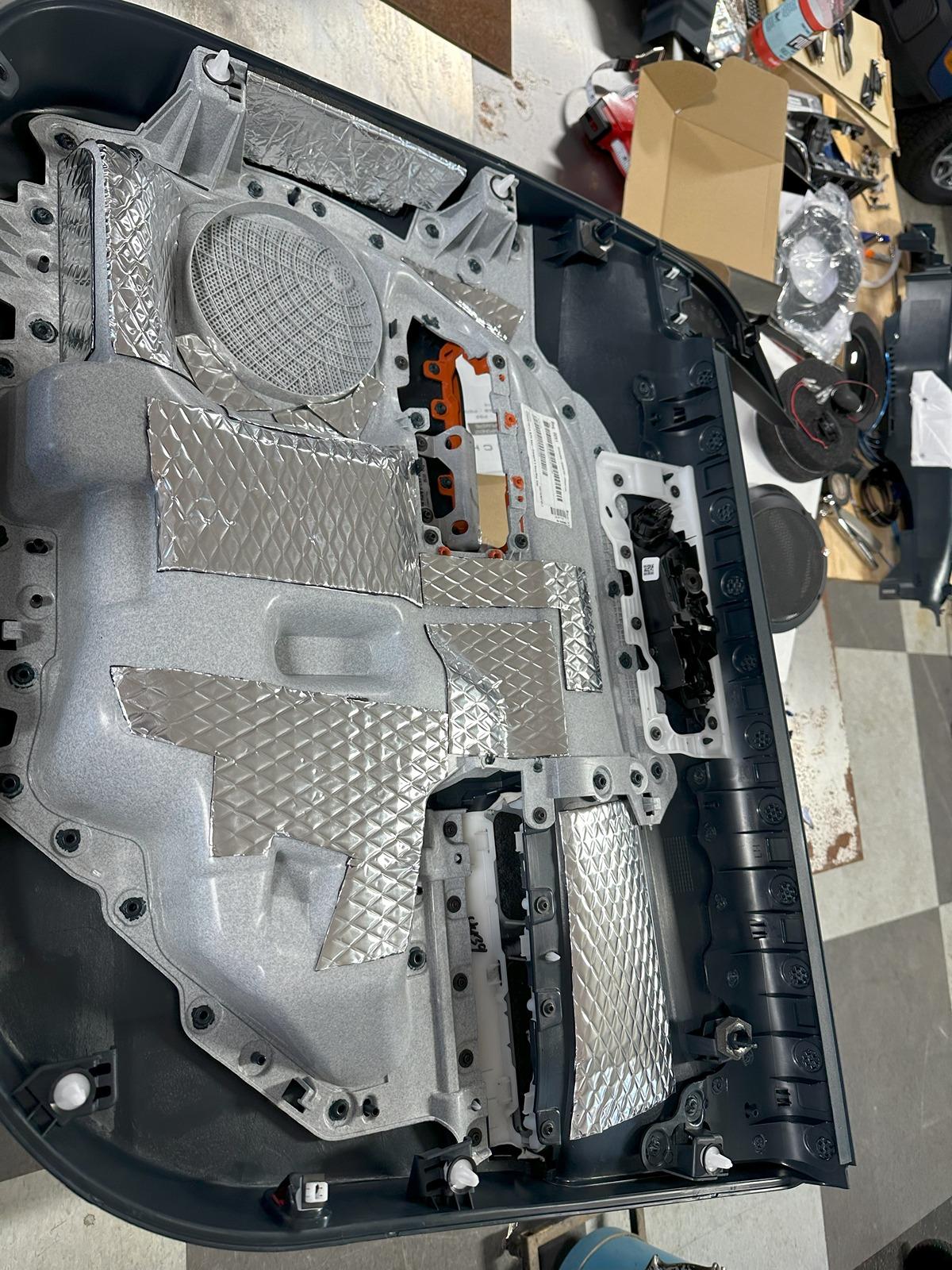

I did sound deadening on both the backside of the door panels and the interior door skins (work in progress pic; I added more than this overall).
Ford Maverick Another Stereo Upgrade Install: Front Speakers, Rear Speakers, Sub, Amp IMG_1887
After getting this done and putting everything back together, I've gotta say I was actually pretty impressed with how much better things sounded with just a speaker upgrade and no amp. Bass was MUCH tighter and louder, and extended noticably deeper. Would powering these with an external amp play louder? Sure. But I personally think they sound great even running off the factory head unit/amp.

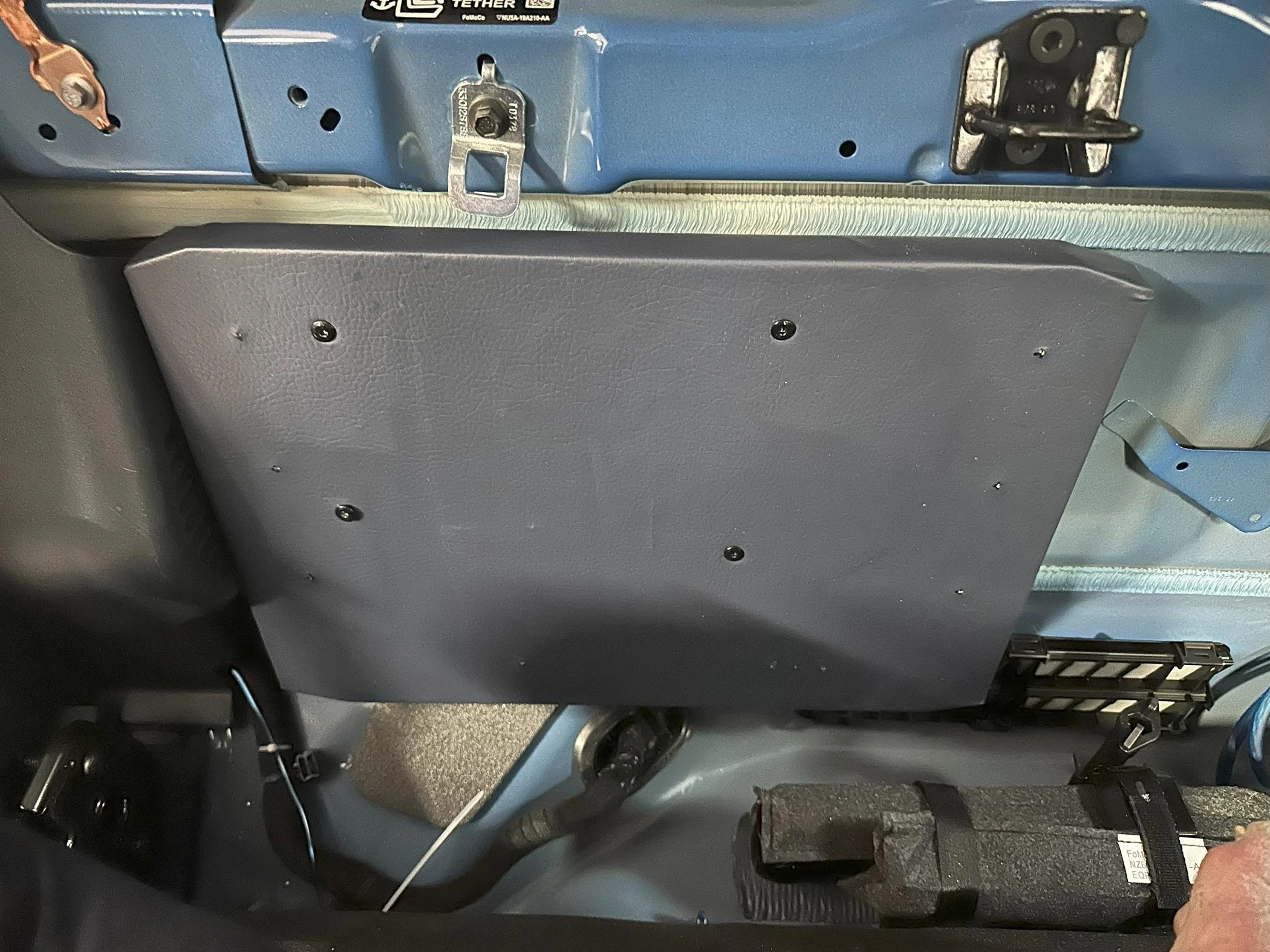

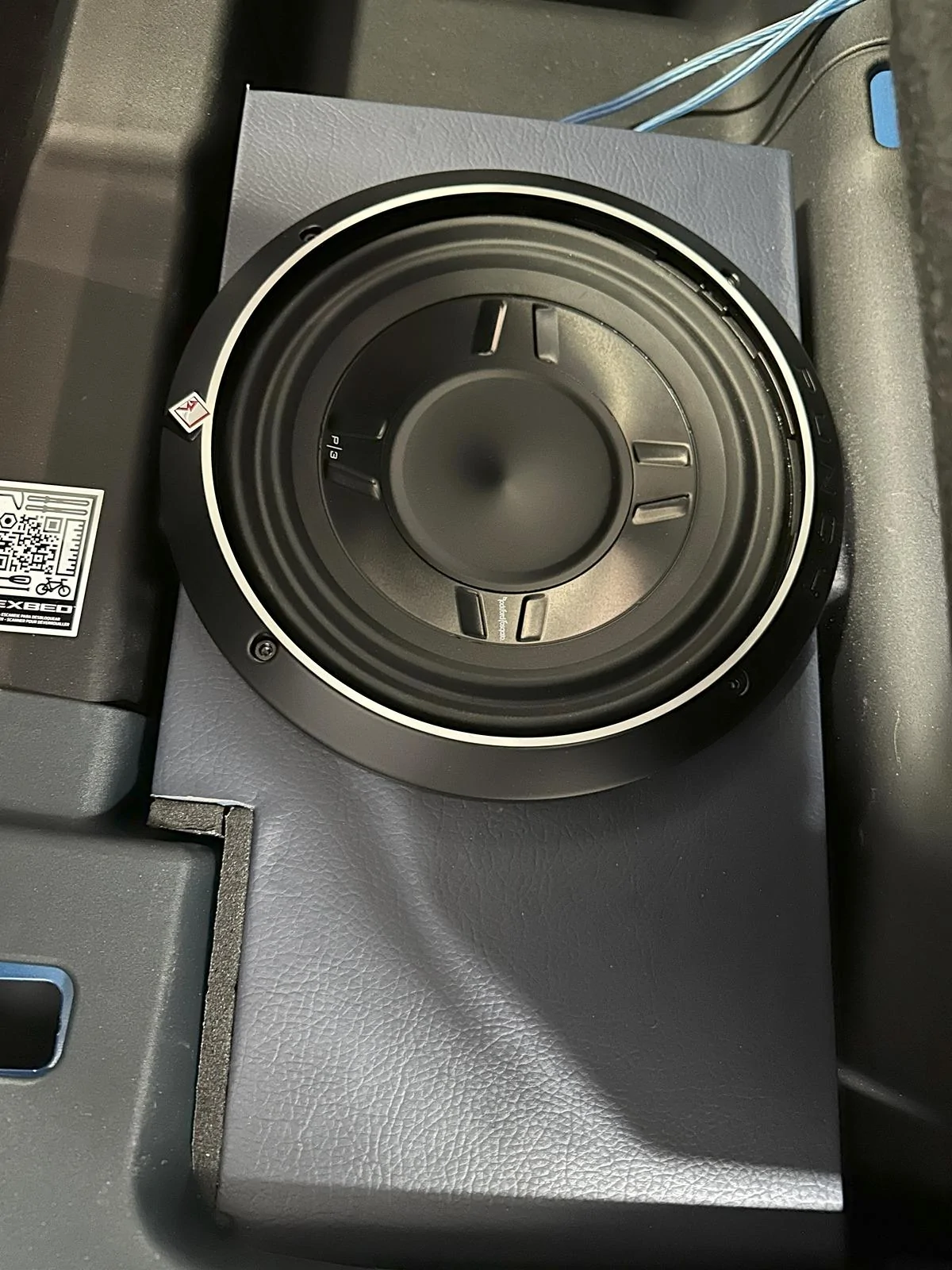

Next I moved on to the subwoofer. I used a Punch P3SD2-10 DVC shallow subwoofer. I built my own box, basically copying the Ground Shaker design for under the rear seat. I used 1/2" MDF (they use 5/8"), but doubled up the front baffle. I also made it just a bit taller and wider to squeeze out some more cubic feet (inches), and added an internal cross brace (probably unnecessary). I then used this blue vinyl from Amazon to wrap it : Amazon
This was perhaps to hardest part, and the wrapping job I did was not good. However, a lot of it isn't even visible when the box is in the truck, and the top looked pretty good, so a win overall (I know it looks like there's a big wrinkle in this pic but it's a trick of the light).

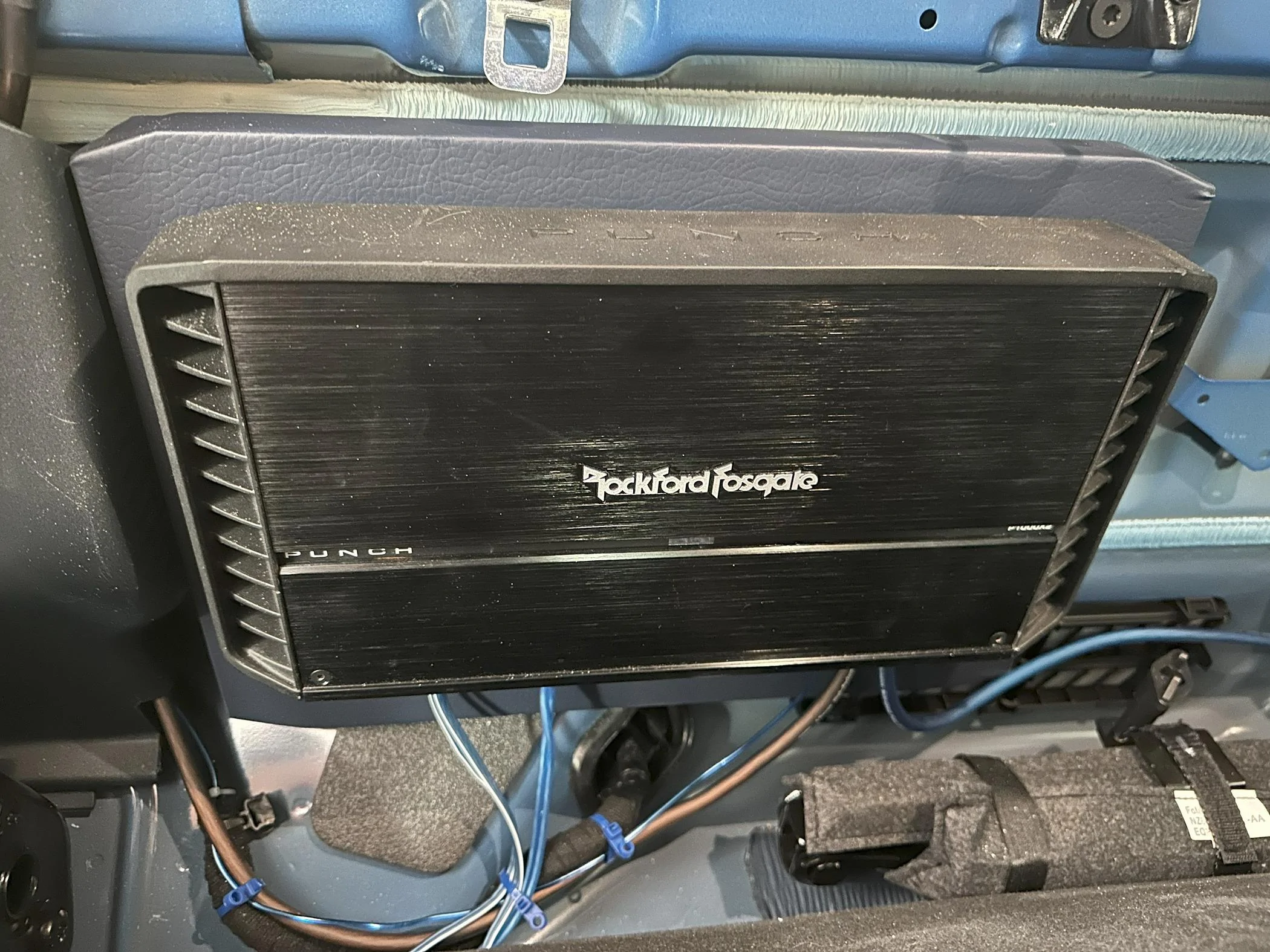

Next, I had to mount the amp, which is a Punch P1000X2. I'm running it with each of the two channels powering one 2 Ohm voicecoil on the sub. It isn't necessary to use the subwoofer in "stereo" as I am, but I got a great deal on this two-channel amp off Craigslist and this was the best way to wire it. I built a mounting plate for it using more MDF, and wrapped it using the same vinyl. I used the factory nutserts that hold the B&O amp on the Lariat trims (note: these are NOT actually threaded on the non-Lariat, so I threaded them using an M5 tap). I predrilled for the amp mounting screws and some mounting screws for some screw-mount zip ties to secure the wires to the amp mounting plate.
Ford Maverick Another Stereo Upgrade Install: Front Speakers, Rear Speakers, Sub, Amp IMG_1909
I then mounted the amp and ran the wiring. I used this amp wiring kit from Skar. Had everything I needed (except some extra zip ties).
Ford Maverick Another Stereo Upgrade Install: Front Speakers, Rear Speakers, Sub, Amp IMG_1929
I pulled the inputs for the amp by tapping the front speaker outputs of the ACM using some Posi-taps. I used these speaker-to-RCA adapters from the Posi-taps, and ran an RCA cable to the amp out back. Used this fuse tap and fuse #3 to get switched power for the remote turn-on.

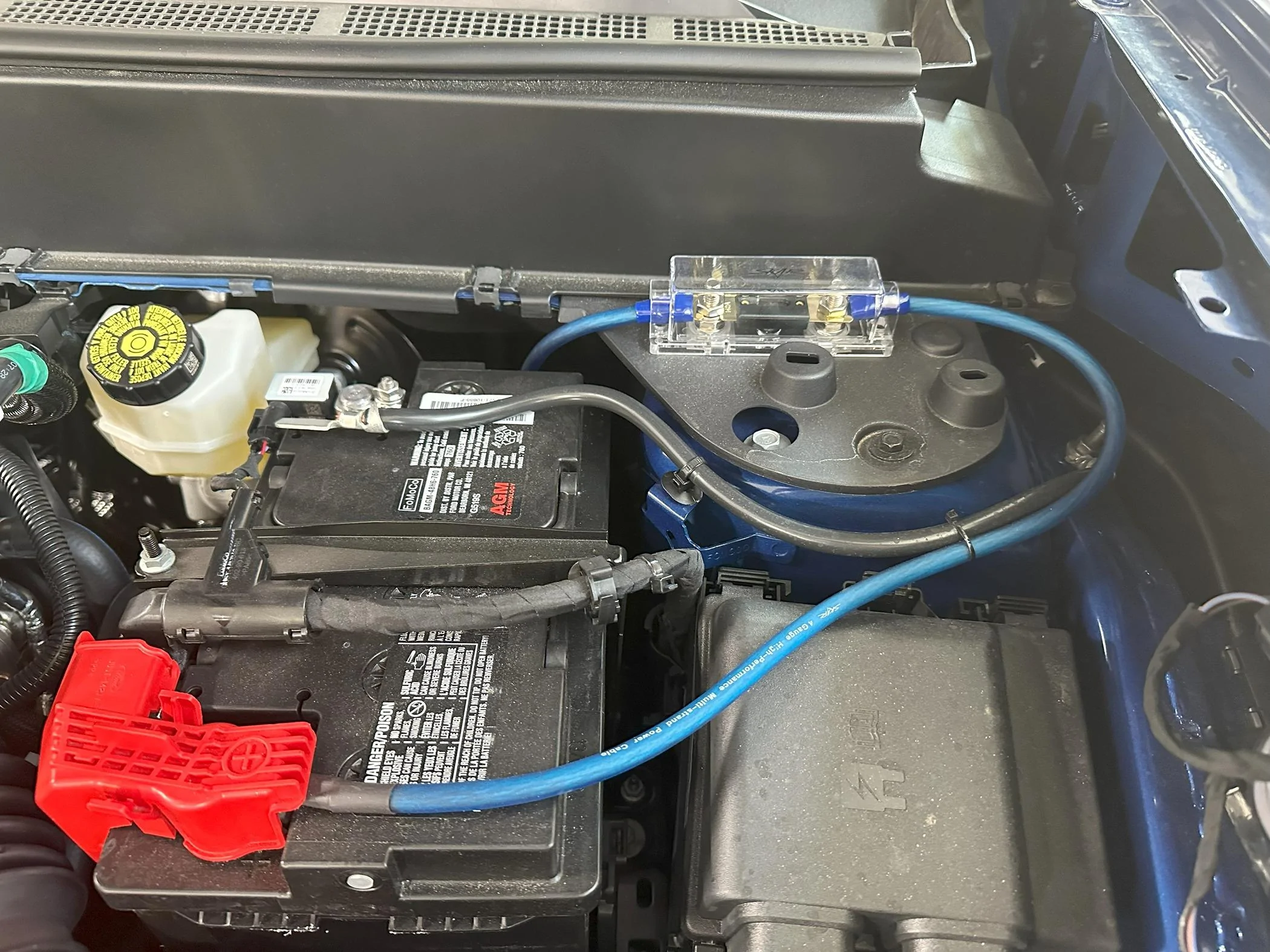

Finally, I added a fuse under the hood near the battery for the amp power. Marked and drilled two small pilot holes, then used two black sheetmetal screws to mount the fuseholder as seen below. I ran the power wire down the driver's side and through the factory grommet under the dash like most people did. Applied some black RTV after cutting it and running the wire to keep moisture out.

Next I moved on to the subwoofer. I used a Punch P3SD2-10 DVC shallow subwoofer. I built my own box, basically copying the Ground Shaker design for under the rear seat. I used 1/2" MDF (they use 5/8"), but doubled up the front baffle. I also made it just a bit taller and wider to squeeze out some more cubic feet, and added an internal cross brace (probably unnecessary). I then used this blue vinyl from Amazon to wrap it : Amazon
Finally, I had to mount the amp, which is a Punch P500X2. I built a mounting plate for it using more MDF, and wrapped it using the same vinyl. I used the factory nutserts that hold the B&O amp on the Lariat trims (note: these are NOT actually threaded on the non-Lariat, so I threaded them using an M5 tap).
I pulled the inputs for the amp by tapping the front speaker outputs of the ACM using some Posi-taps. I used these speaker-to-RCA adapters from the Posi-taps, and ran an RCA cable to the amp out back. Used a fuse tap and fuse #3 to get switched power. Finally, I added a fuse under the dash for the amp power. Marked and drilled two small pilot holes, then used two black sheetmetal screws to mount the fuseholder as seen below. I ran the power wire down the driver's side and through the factory grommet under the dash like most people did. Applied some black RTV after cutting it and running the wire to keep moisture out.

Thanks for including the part number for those clips. I lost three of them this weekend while replacing my speakers. Two of them I found with a borescope and retrieval tool. One is still in the dash somewhere.

Great write up and thanks for sharing! Haven't even gotten my truck and I'm spending money left and right on "upgrades"!!
I'm a bit confused by this part:
"Used a fuse tap and fuse #3 to get switched power." Is that for the remote turn-on?
"Finally, I added a fuse under the dash for the amp power. Marked and drilled two small pilot holes, then used two black sheetmetal screws to mount the fuseholder as seen below." - Did you mean under the hood, like the picture shows? If not, this would be a third power source:
1. "fuse #3 to get switched power"
2. "fuse under the dash for the amp power"
3. power from the battery as shown in the photo.
1. "fuse #3 tp get switched power"
3. "power from the battery as shown in the photo."
Good catch! This was a typo. The fuse tap under the dash is for remote turn-on only. Amp power comes from under the HOOD (what I meant to type). Edited!
