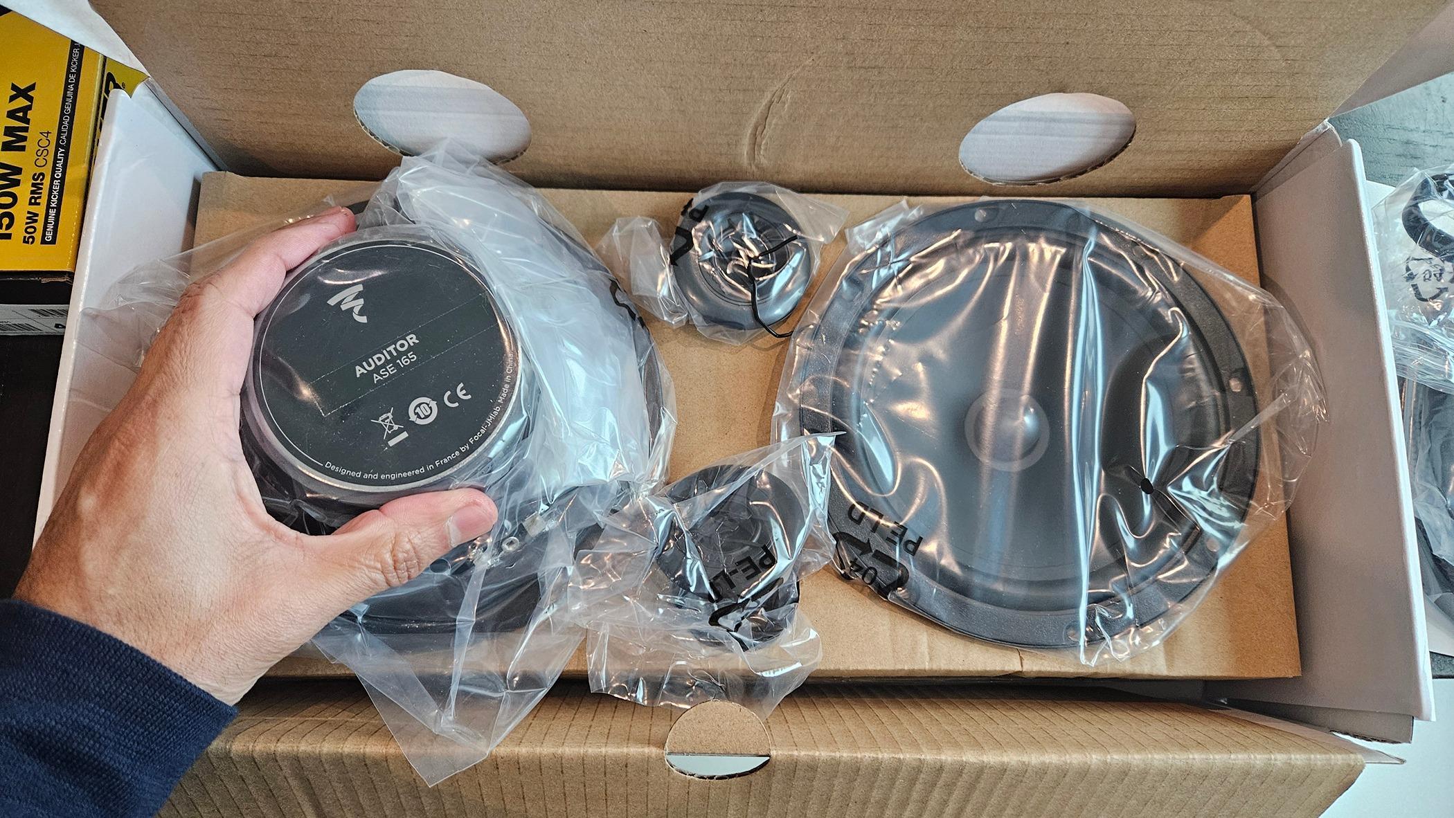

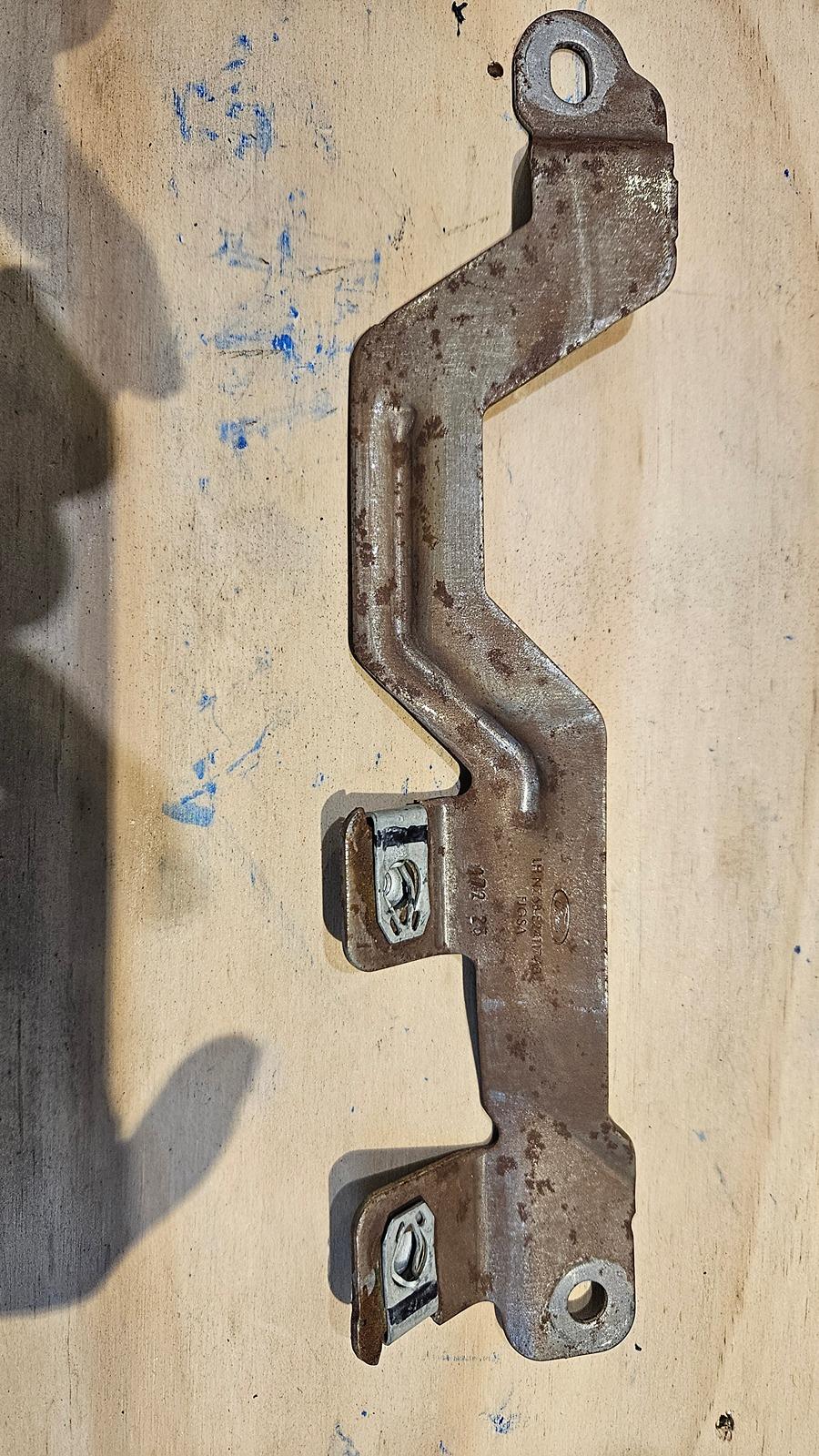

This time I was looking for better sound fidelity, crisp sound and powerful enough to please the passengers inside the cabin, also looking to get the most out of a sub sound w/o doing modifications to the truck. I was not looking to come up with a system that is loud to the outside of the cabin. I also wanted to keep this under a budget so after doing some research and also catching some good crutchfield discounts. I decided to go with a couple of Focal component Auditor series (ASE 165 new version at $200) for the front + Kicker CS series in the rear ( 46CSC44 at $70 ) + 10" groundshaker box ($220-230) w/10" SKAR sub ($80-85) + Infinity reference amp (6001A at $150). Used Metra harnesses on both front and rear to avoid cutting or biting the factory harness cables, the front mounting brackets too. Used foam rings on the speakers and added a few sound deadener layer on the front doors that I was able to paste and squeeze in by stretching my arm ... a little cumbersome but this I believe made a huge difference. When disassembling the front door panels I noticed a metal bracket was VERY rusty, so I decided to sand and used some antirust paint, this was just for fun. A watch out on the front doors is try to avoid using the rear foam circles that come with the speaker foam rings, that can interfere with the power window slider channel and harm the functionality.. I had to re-do the doors (open it all up again…) to spend time and figure out what the issue was with the windows... a painful 2-3 hour rework I had to do since the windows were not rolling freely anymore.

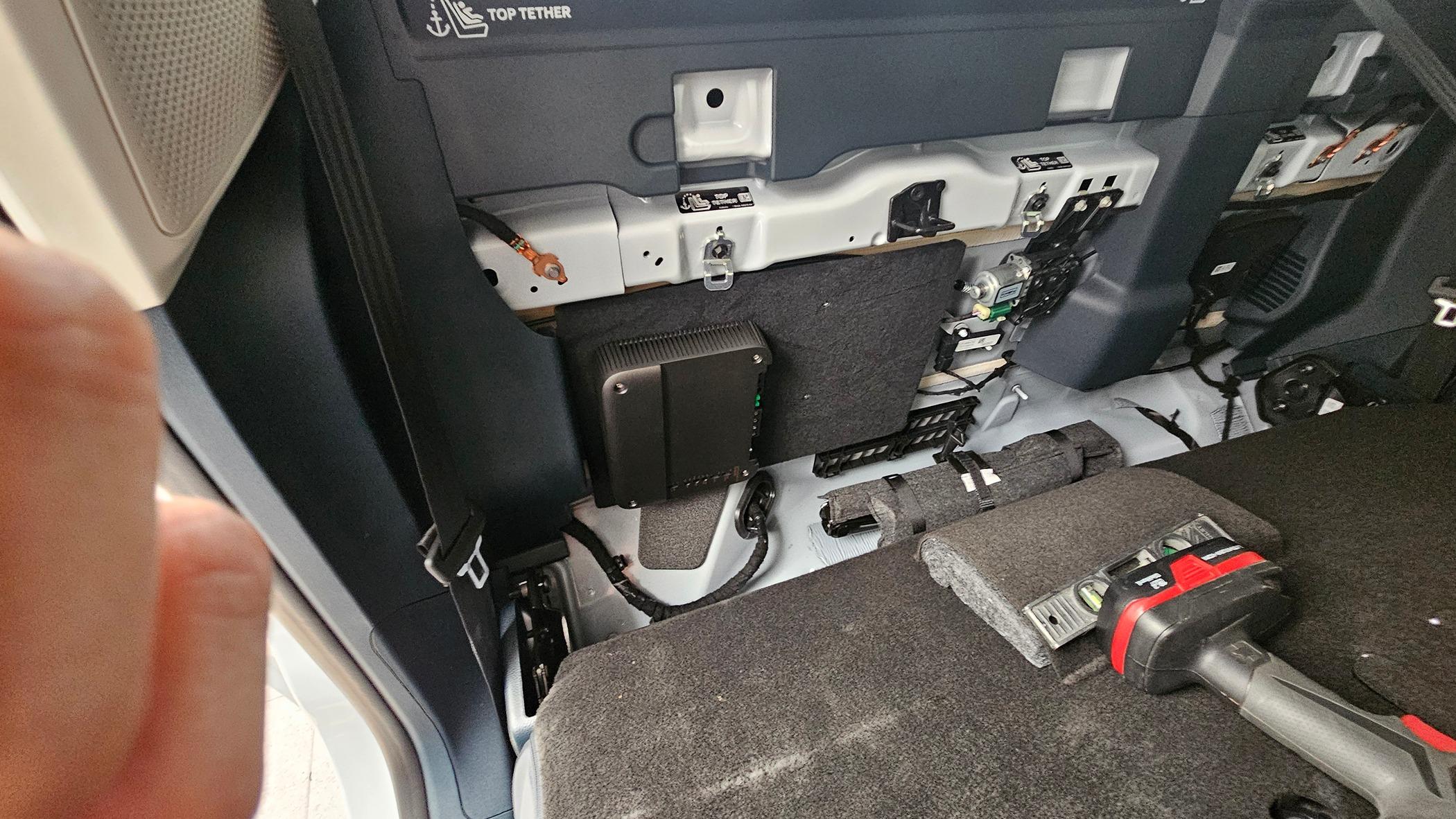

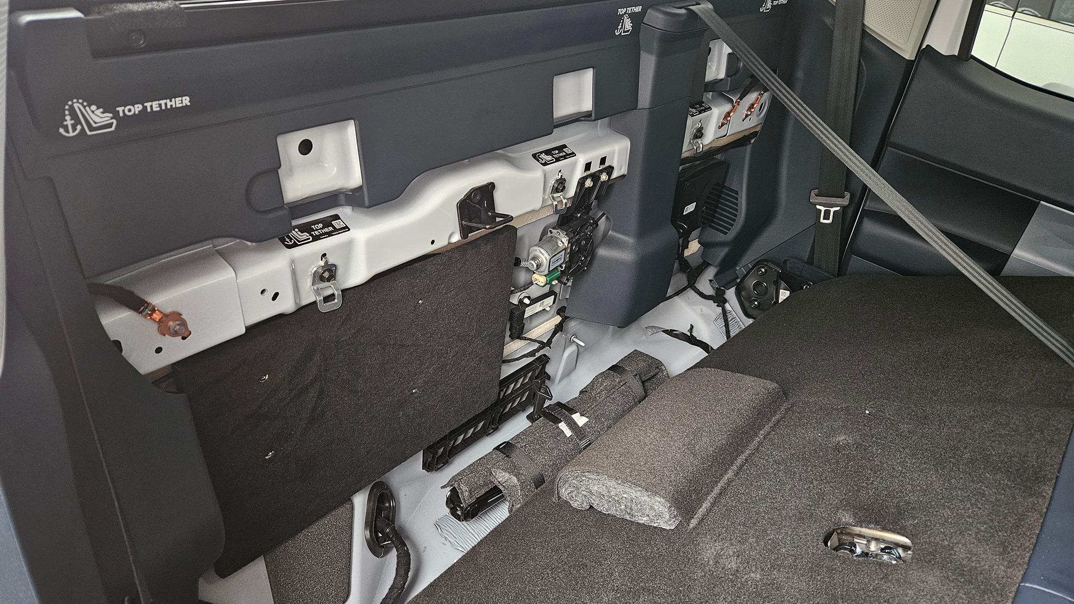

For mounting the amp on my first XLT project I made a custom wood mounting base to maximize mounting space and did similarly for this lariat. However I ended up with less mounting area on the lariat due to the space taken by the rear sliding window motor :) that was a slight change vs. the XLT. Still was able to maximize every inch to leave some free area in the case I wanted to do future upgrades, installing any extra equipment. This worked great in both projects the XLT and Lariat, just sanded and treated a 1/2" thick 5plywood with a water/humidity resistant anti mold/termite. Predrilled 3 mounting points premeasuring in the truck with a soft poster board I used as a template for pre-drilling the wood, did some countersink to make sure wood heads were flat when installed. Painted the screws with anti corrosion black matte paint I had. Glued and stapled black speaker carpet on it for it to look and feel good when mounted. The three mounting points available on that mavericks metal "butterfly" bracket are solid, you just have to bend the side flaps a little by hand to make it completely flat.

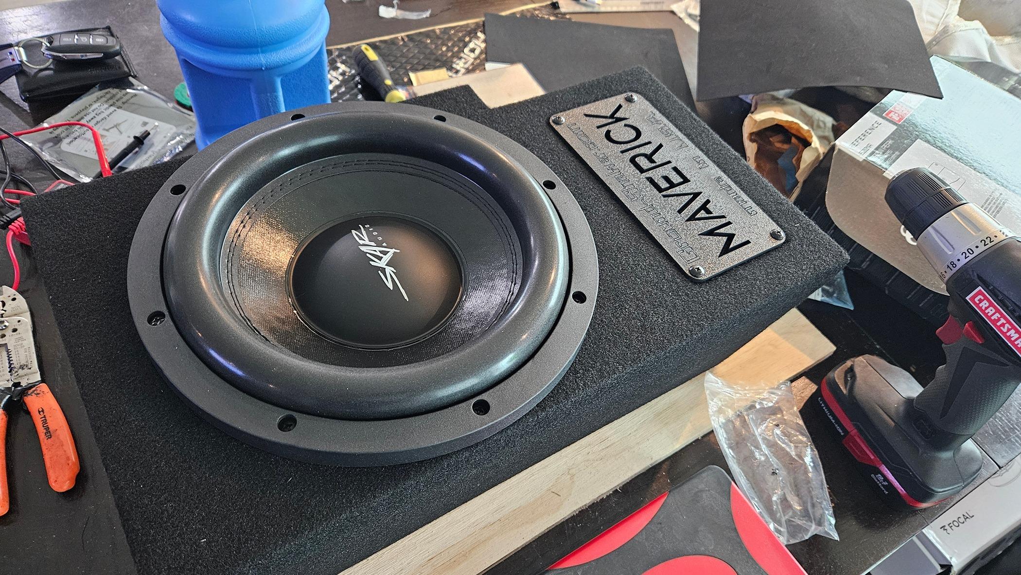

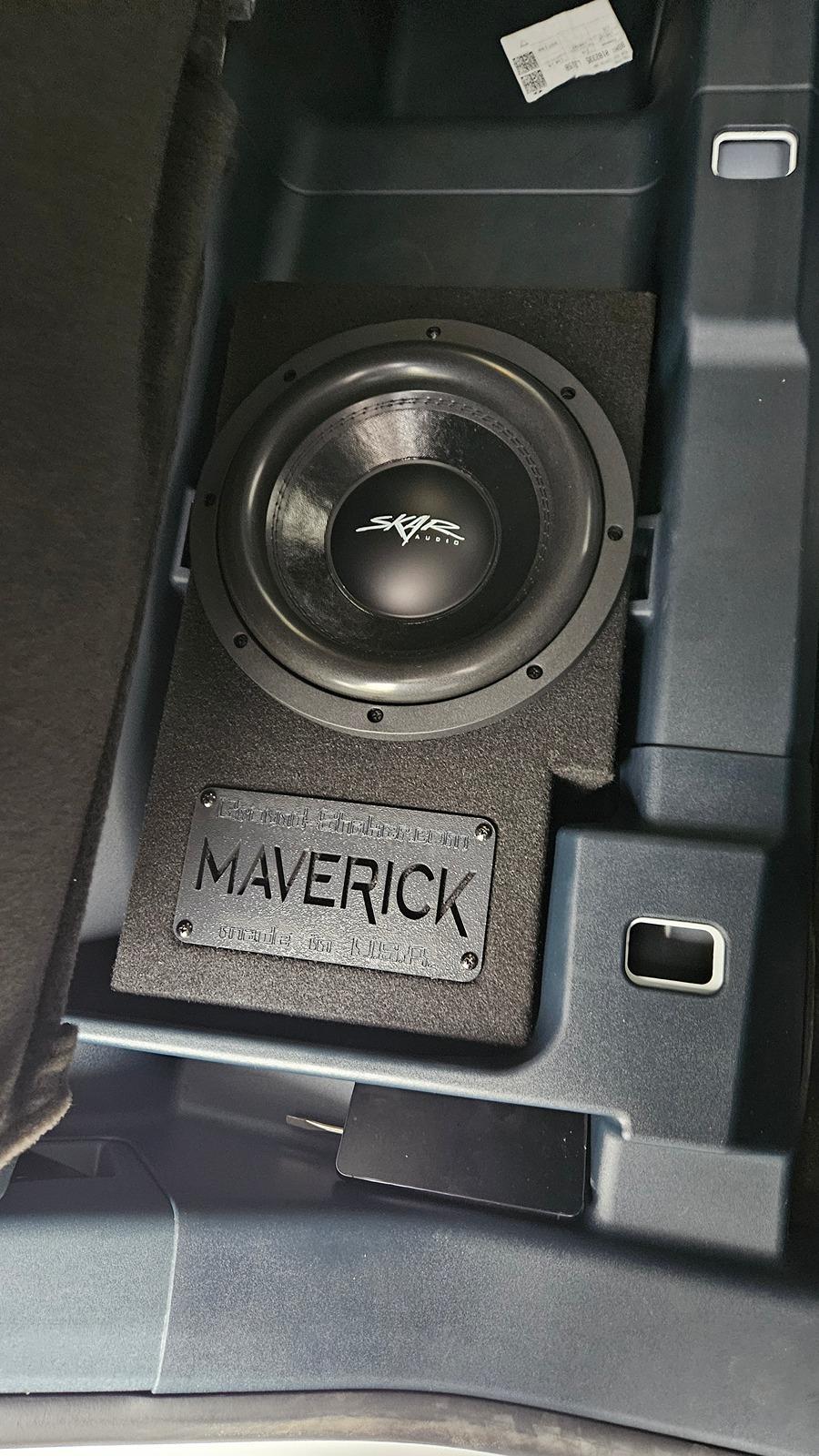

Given I wanted to make sure I got the most out of 1 rear seat mounted subwoofer, definitely investing $$$ on the custom made ground shaker 10" sealed enclosure was the best decision I could have made, it is worth every penny believe me. I paired this with a budget friendly but VERY powerful 10" 2 OHM DVC SKAR audio sub. Powered with that inifinity refence at 2 OHM, the sub sound is so good that makes you want to amp the 4 speakers and add a 2nd sub. Better sound than a powered sub I think.

1. Fabricated and mounted the ½” 5plywood mounting base, treated and carpeted
2. Mounted the amplifier on the base to define mounting area, cable lengths as well as amp orientation for cable inputs (oriented the input panel towards the drivers side)

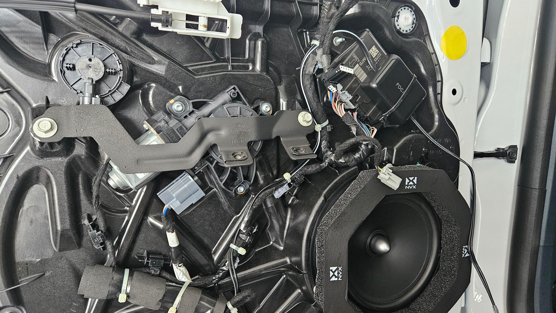

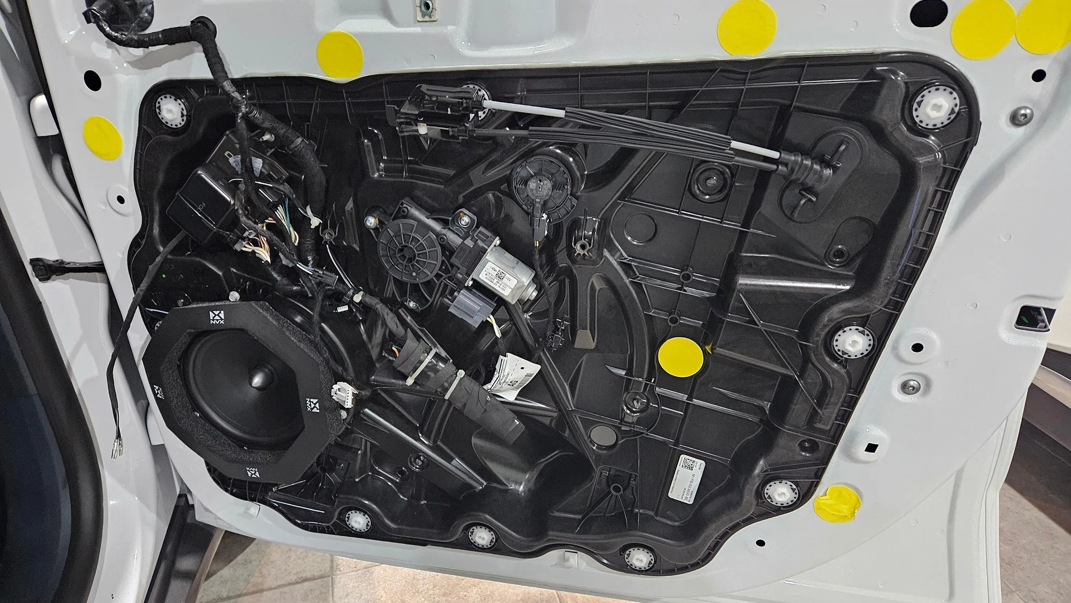

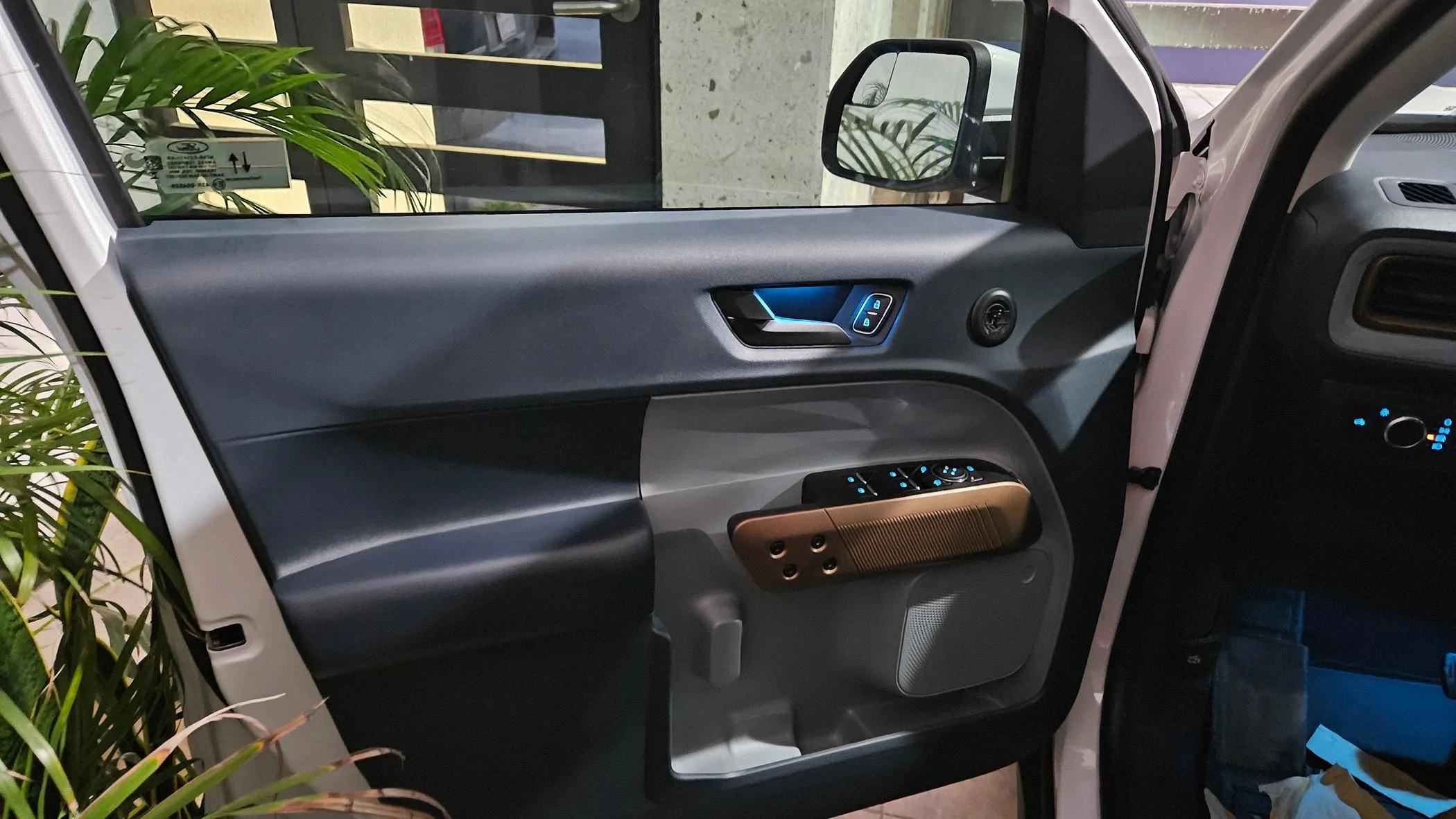

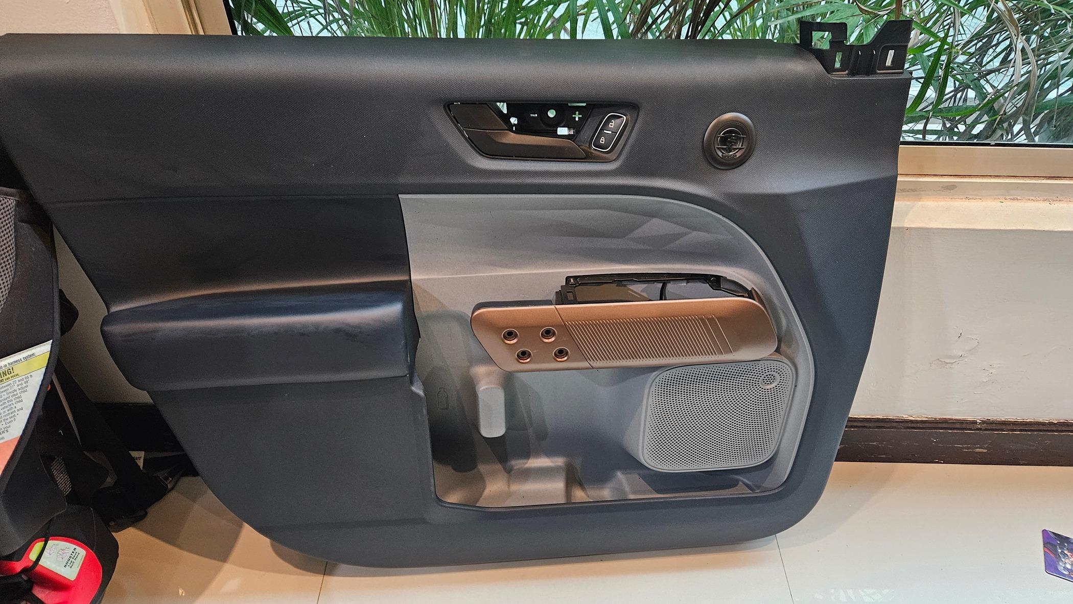

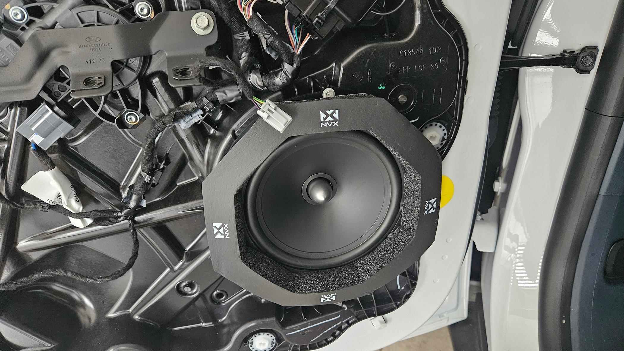

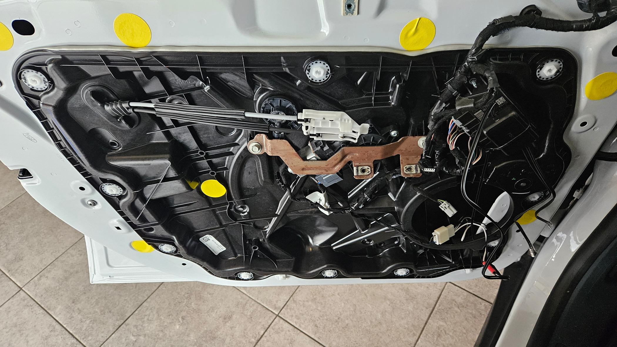

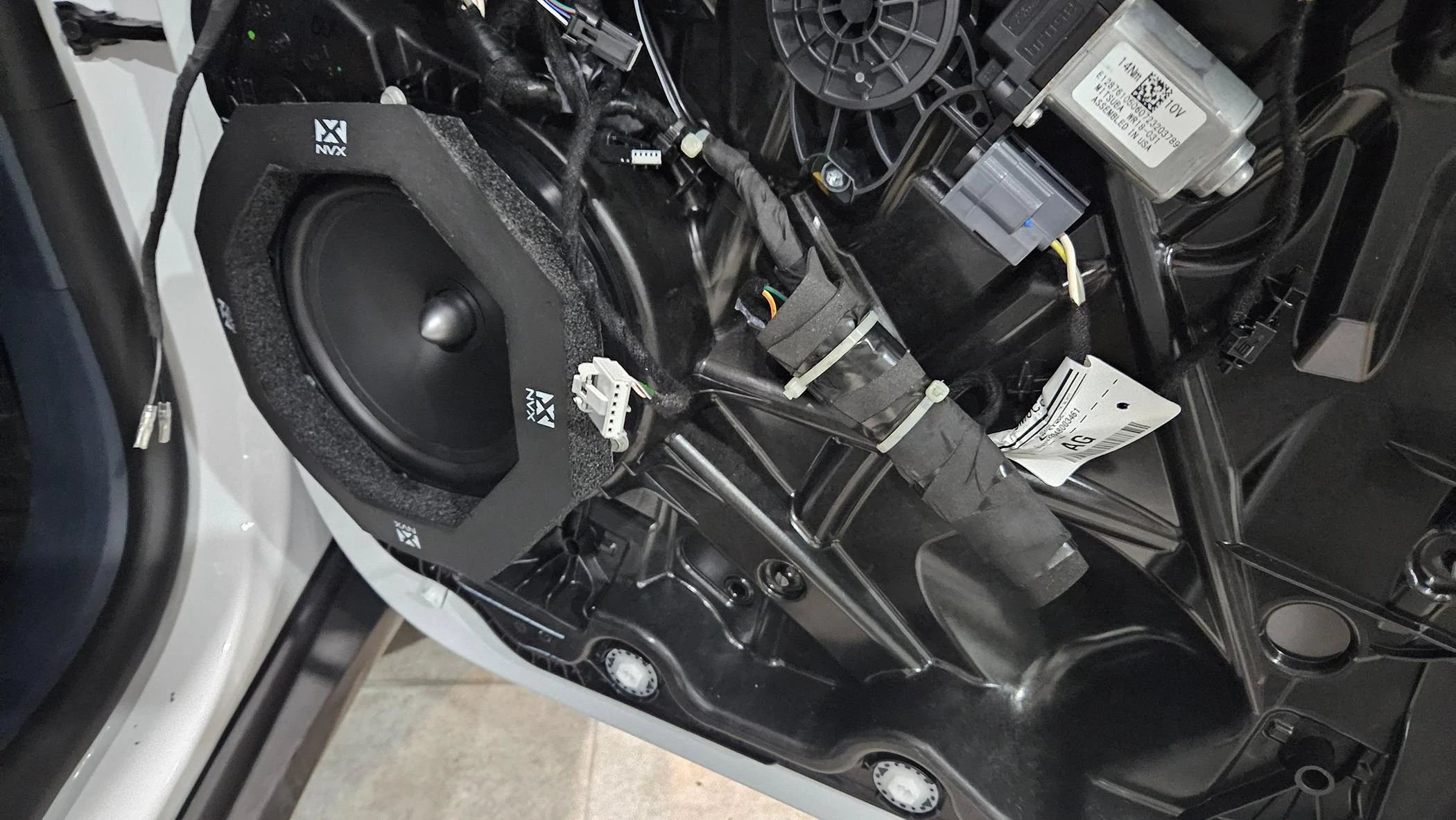

3. Installed front speakers on both doors, drilled a hole (drill&Dremel) besides the door handles to flat mount the provided focal tweeters by pressure, tested before wrapping up. Used front roam rings only , avoided rear ones. Installed some sound isolation layers inside the door panels. Used metra mounting brackerts and harnesses. The focals come with a prewired crossover (I loved this) and the crossover is very small in size

5. Picked SKARs 4 gauge OFC (oxygen free is preferred) amp kit. Identified the fuse mount location and mounted it. Prepared and ran the power cable (fuse to cabin only, w/o connecting fuse to the battery yet) by the passenger side using the trucks firewall entry point available. Prepared the hot power cable and the amp ground cable. Ran the amp remote control cable picking desired knob control location first. One thing to note here is I noticed that some water could get into the SKARs fuse enclosure, I did not like that. I have used the BOSS fuses in the past those close very tightly and even have some type of seal so that it almost can prevent any water from getting in… so I think SKAR could improve that.
6. Prep and mounted sub box enclosure and put it under the rear passenger seat, perfect fit

Noticed you put the tweets in the door panel .are you happy with them ? And did you put a capacitor on or do anything with factory dash speakers or put caps on the rears or doors for pulling bass?

hey man yes last time I mounted the component tweeters on the side door covers (A pillar covers) however the sound was kind of blocked by the car dash when the doors are closed. This time after giving it some thought I decided to mount them right besides the door levers assuming the fact that the surface is not 100% flat but is flat enough and the sounds is more close directed towards the passenger/driver ears.
The OEM dash tweeters are still functional and will actuallbe be replacing them with a couple of memphis inline crossovers tweeters I got from crutchfield too, I just need to get some type of endcap or something to hold the tweeters in place.
I did not do any other extra mod, just trying to keep it as simple as possible meeting my expectations so far in terms of sound.
