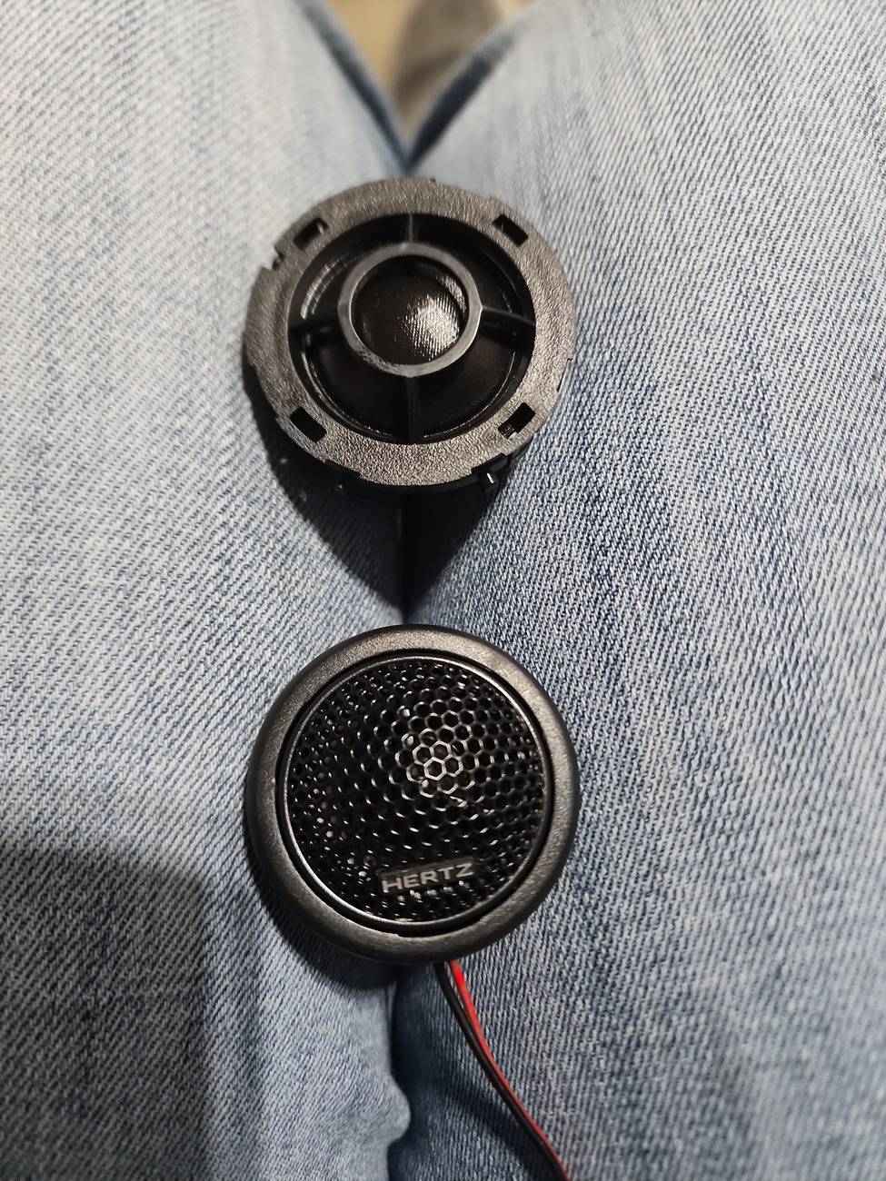

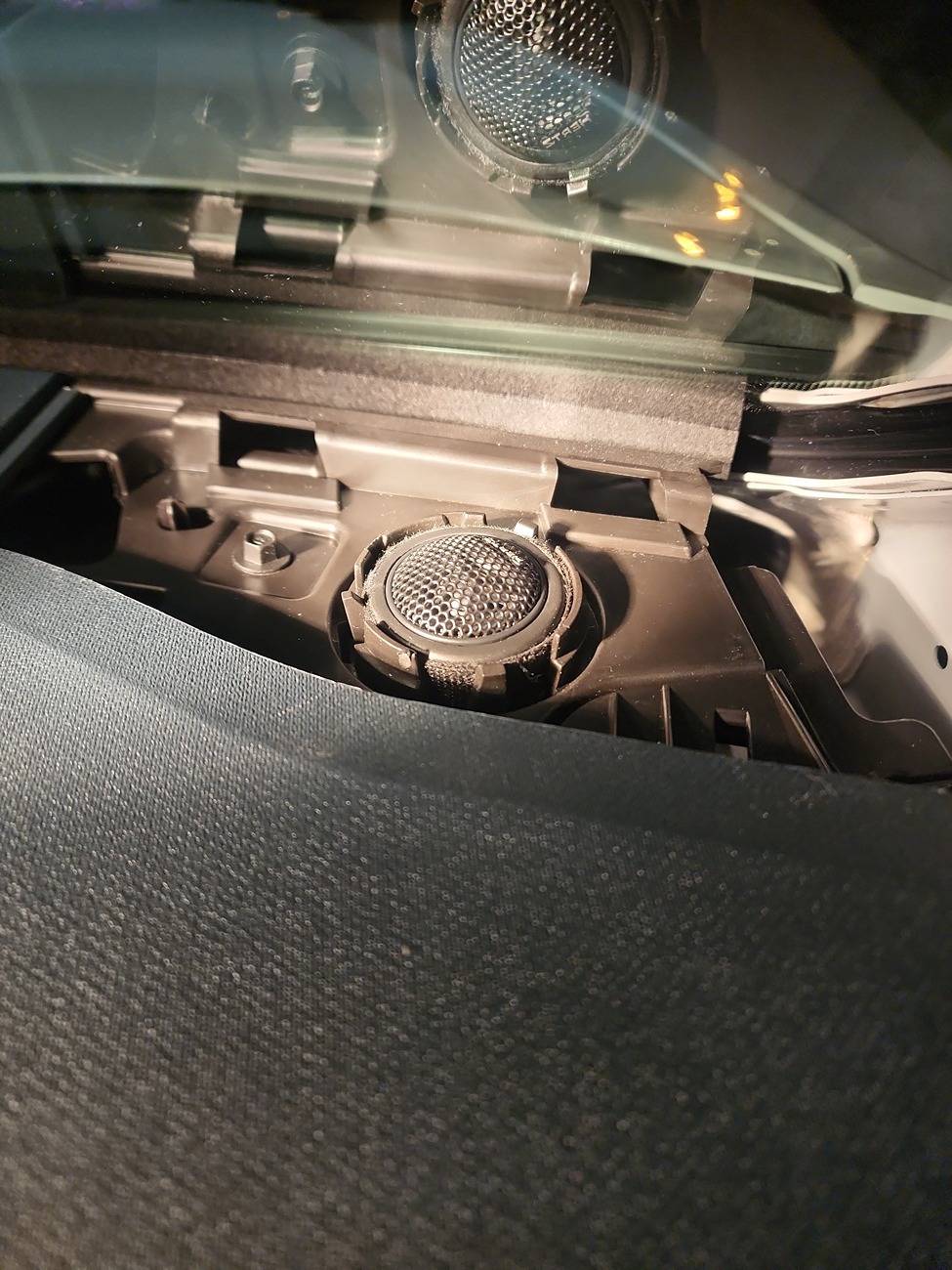

mine came with an adapter from Crutchfield but the tweeter has wire ends and the adapter has blades. So there still seems to be a need to cut and splice.
Also, did you play around with the adapters for the tweeters? There seems to be a bezel that will allow it to snap in place but it slides on and won’t hold the tweeter. Just use tessa tape to hold with friction?
Yeah if you look at my photo of the Twitter I have that flush mount bezel on it still doesn't make it wide enough to be just held in place like the OEM Twitter but that has its own style adapter made to fit the OEM opening. This is why without any major modifications I just used a bout 3/16 of cloth Tessa tape which to this day holds its snugly in place without falling through or popping out of the dash tweeter opening.
I originally tried to take the OEM tweeter out of the housing to utilize that but it's glued and plastic welded into place you destroy it trying to take it apart.

How did you get the tweeter grills off, did you break the stupid snaptabs? I know i did lol. Need to get replacements.
I didn't break any clips but I did have two of the white plastic snap tabs I call them fall off into the dash and somehow miraculously before I remembered to order them while driving they fell out onto the passenger and driver side floor mats.
Thankfully I was able to reinstall them with no harm done about 2 weeks later. 🙄🤣🤣🤣
