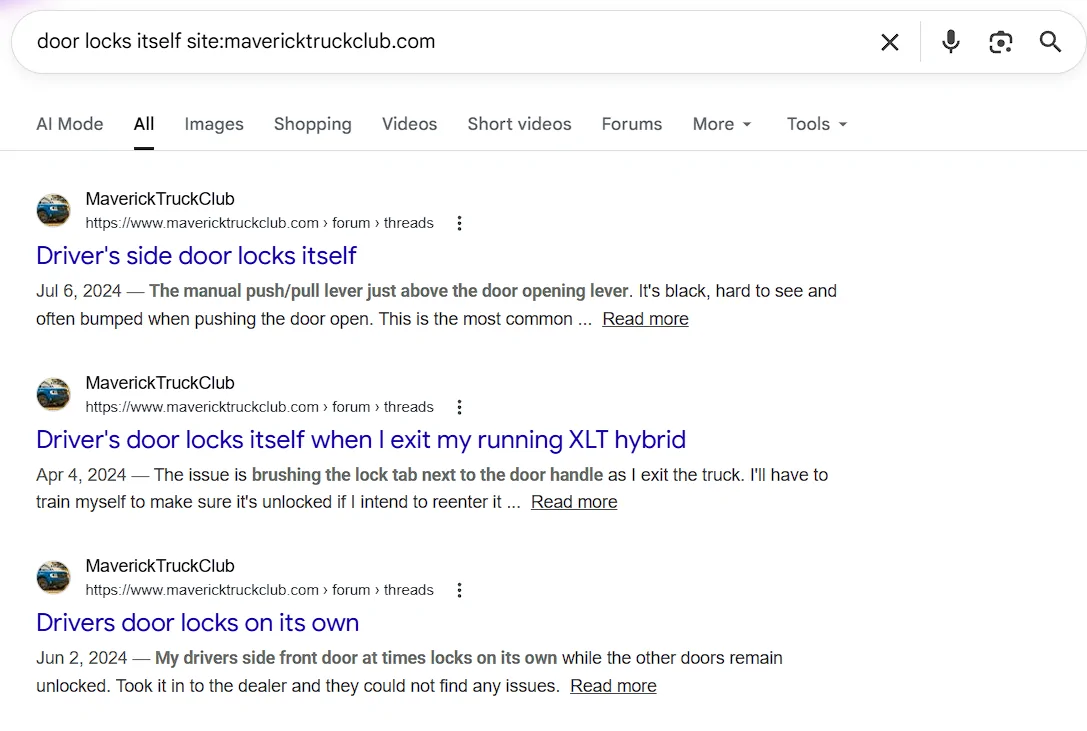

Jeff,
Refer to post #2
The Maverick does not have it in its programming to auto lock.
The picture in your post #2 finally made it clear to me how I locked myself out. I knew I was my “fault” - but I did not know what I did “wrong”. Thought I touched a button inappropriately…
