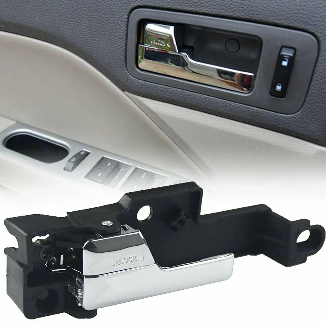

I traded in my 2007 Lincoln MKZ when I got my '25 Maverick. It had a very similar design for the interior door handle and lock (see picture). Pretty sure the Fusion and Milan were the same. Ford sold millions of these cars, they were some of the most popular and reliable models ever made. They also were produced at Hermosillo, Mexico, the same plant as the Maverick.
Although, I had my MKZ for 18 yrs, and two of these door handles did break so I needed to replace them. They were chrome plated plastic. I wondered if living in Arizona contributed to making them brittle. I was able to buy aftermarket zinc die cast replacement parts.

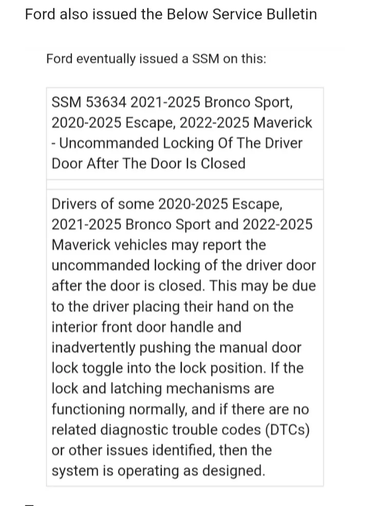

Good day
I think the only way that Ford will ever be able to start to sort out the "driver door locking by itself" complaint is to send a message out to every dealership.
The message would push them to instruct all vehicle sales to require the new buyer be informed AND shown that the trucks have a manual locking lever, where it is and how it works.
I can't believe I had to put this into words and put it here as a possible preventive measure (yes, that is a Flight Safety Preventive Measure right there!).

Wouldn't matter, owners would still fight them on it. I'm willing to bet owners have fought them even after reading the service bulletin.
Ford Maverick Door locking incident... 20260405_080655
You really think they're going to listen to directives from Salesperson? Telling them not to lock themselves out of the truck.🤭🤭🤣🤣🤣 Don't forget to add. That there could be three other doors that are still unlocked.🙄🙄
Don't eat yellow snow, don't run with scissors, turn on your wipers when it's raining.
I say put it in the manual. Starting it this way. Don't be a dumbass and lock yourself out of the truck
That way it's there.
There wouldn't be one complaint. We know how well everybody reads the manual.
Let Darwinism figure out the rest. 🤣🤣
