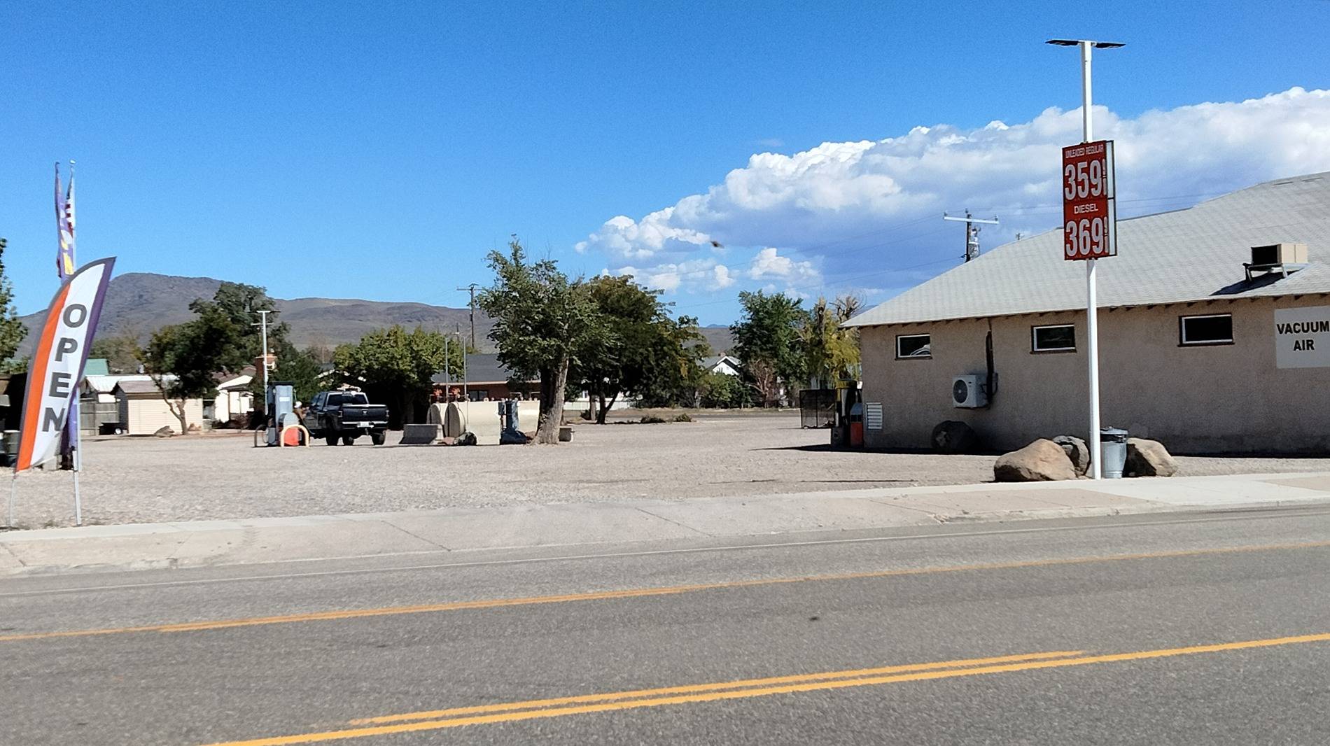

Glen Baker LLC
May 29, 2024
7,430
12,608
Central Nevada & Utah
Maverick XLT Hybrid
I think the major issue is the difference in what top off means.....
The extreme of pumping slowly at the end and going past click after click after click until fuel runs out
I've found top-tier gas usually has good pumps. Now that single gas station in outback where everything looks questionable and old - ya that may be another matter.
Questionable and old.
I know what your talking about.
But at least there's gas or Diesel....
Ford Maverick Do not overfill or top off while filling gas tank IMG20240922115930
No plug in charger in sight.
