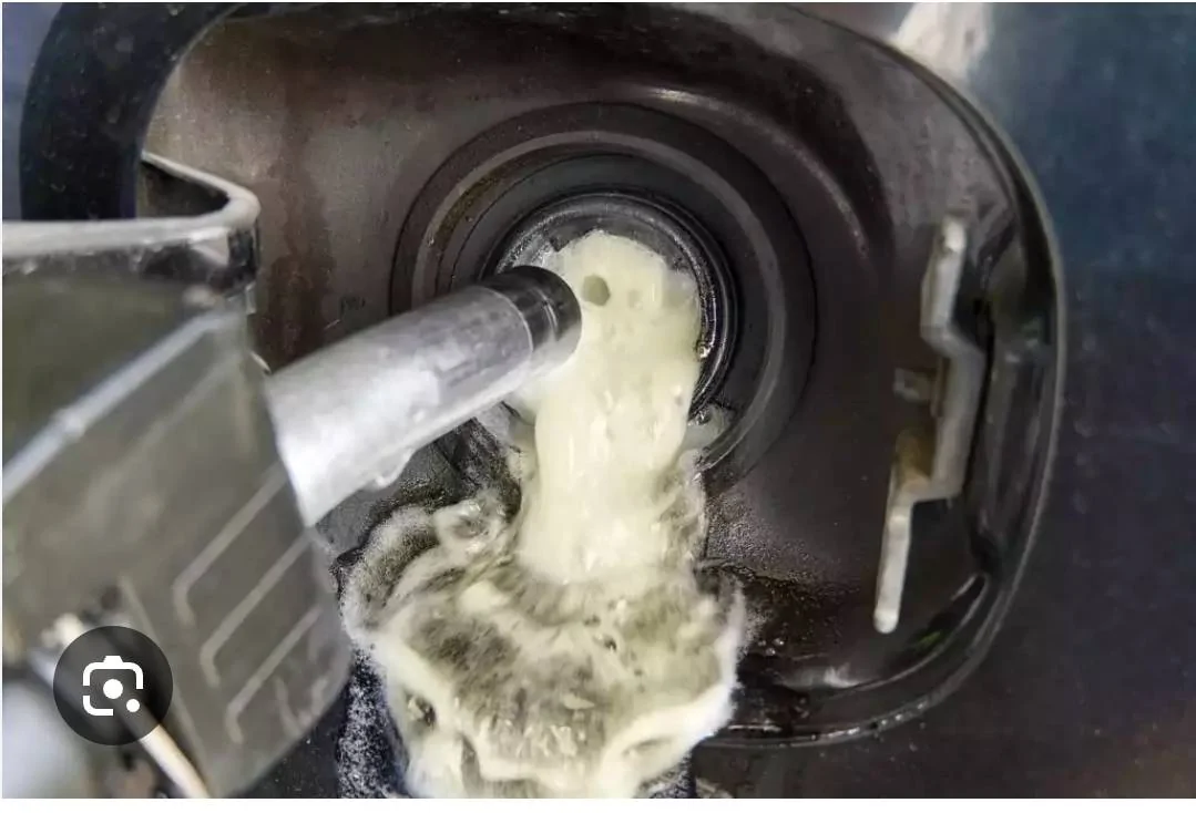

Do not overfill or top off while filling gas tank

They have similar warnings for the hybrid but below is the warnings from Ford on owners manual non hybrid.
https://www.fordservicecontent.com/...A&div=f&vFilteringEnabled=False&buildtype=web
FYI the way I read this is the damage and possible fire or explosion from it. Just wondered in 50 years you picked up a gas can and went to open it and it spurted fuel because the gas in the can expanded and pressurized. I'm wondering if this is what or why the warnings. Fumes are explosive, where gas is combustible. Then again what do I know, besides the warnings Ford put in the owners manual.
Plenty of warning but specifically look for this one on refueling
▲ WARNING: Stop refueling when the fuel pump nozzle automatically shuts off for the first time. Failure to follow this will fill the expansion space in the fuel tank and could lead to fuel overflowing.

There is a more serious filler top lock than the external panel.
Gas isn't sloshing out on the road.
You also need to realize most of the people you are talking to have said not topping off like the article is talking about, from their own descriptions.
They aren't waiting until they see gas at the top. Which could only happen if you have a bad pump handle.
Doing a few clicks to make up for variability of shut-off mech's is very different than 20 clicks that eventually by-passes that safety mech.
As to the fact there is a warning in the manual about it - there are all kinds of warnings in there that sane people don't really need, but they have to be included now because of idiots.

You might want to research that info
Yes, if you overfill a car's gas tank, the excess fuel can simply "weep out" due to the tank reaching its capacity, effectively relieving pressure by spilling onto the ground; most modern cars have a fuel pump shutoff mechanism to prevent major overfilling, but it's still important not to "top off" your tank past the first click to avoid potential issues with the evaporative emission system.
If the 1st click was accurate and not a bad mech - then the 2nd click is going to add mere ounces of fuel.
(if 1st wasn't accurate due to fast flow sloshing - then 2nd click after a pause of 30 seconds and using slow flow rate may had more than a bit, proving out the 1st was early)
If you think a few ounces is the difference between happy EVAP system and expansion tank working as designed - or explosions and weeping due to filling up expansion tank and killing charcoal canister and purge valve - your vehicle has serious design flaws.
How would the modern car's fuel pump prevent major overfilling?
If you got that idea from TikTok - don't listen to that person anymore.

At least in hybrid the tank is pressurized to help reduce venting of lighter more easily evaporating ozone depleting components in gasoline. There needs to have room for them to evaporate into as well as for the pressure to keep rate of evaporation down.
