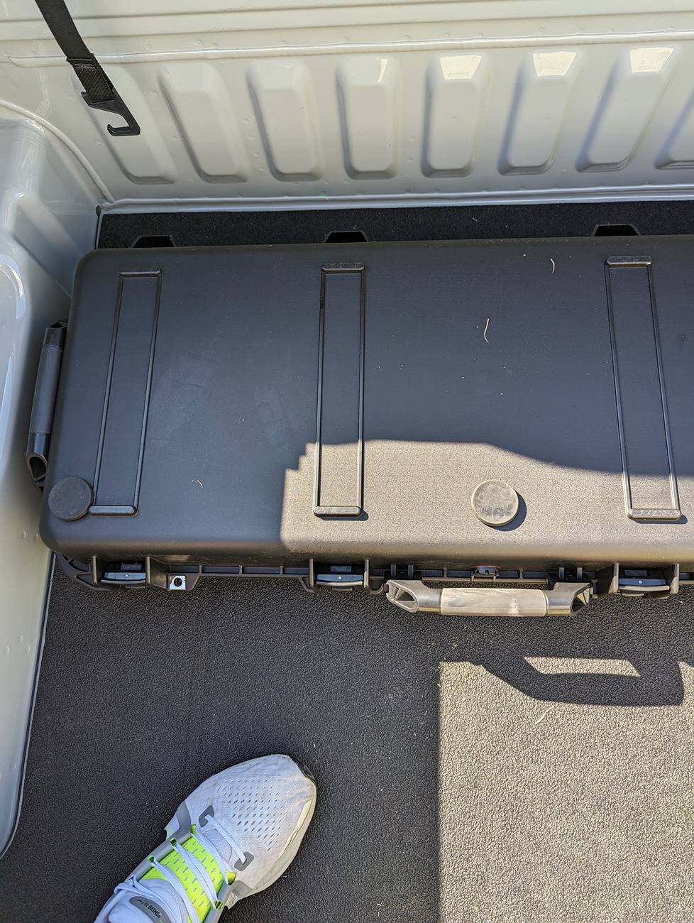

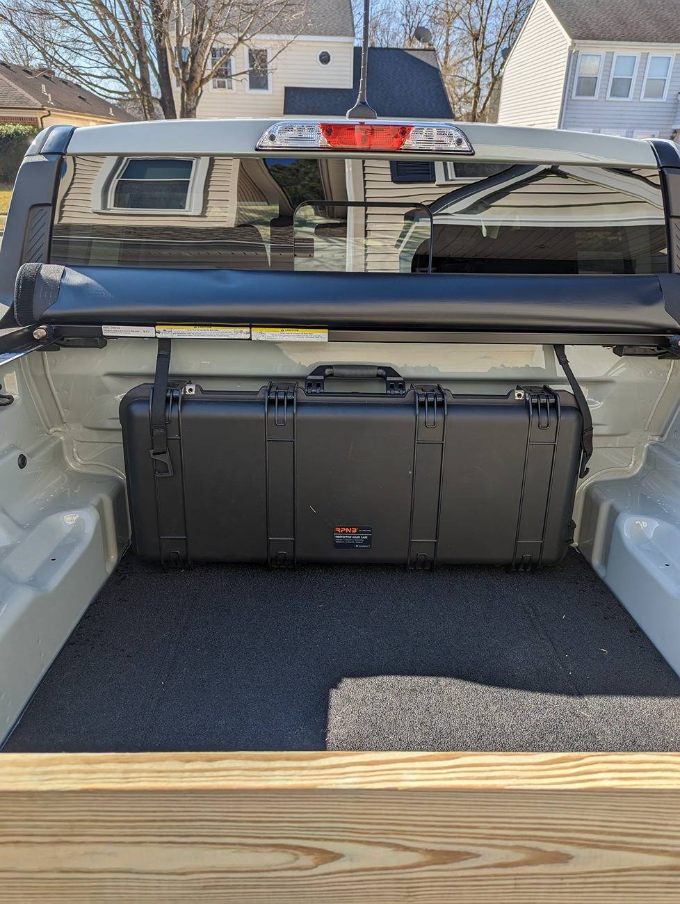

A two year old project, but figured I'd throw it out there for others if interested.
Purchased a "pelican" style rifle case off Amazon and some magnets with integrated bolts. Simply measured where the magnets would line up with some one of the horizontal ribs in the front of the bed. Drilled holes and installed the magnets. Plucked the foam to fit my needs. Less than an hour of work and I had a weather tight box for my tool kit, battery jump pack, battery air inflator, and small first aid kit.
The magnets held strong and let me quickly remove the box
Ford Maverick DIY Magnetic Toolbox 1000001608
Ford Maverick DIY Magnetic Toolbox 1000001606
Ford Maverick DIY Magnetic Toolbox 1000001607
if I ever needed it. The only time the magnets didn't hold was when the maverick was sadly totaled by a moving truck rear ending me at an intersection.

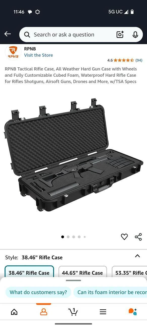

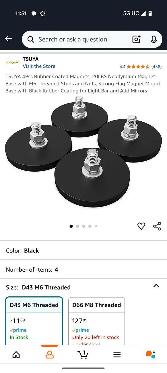

Here you go, at least this is what Amazon says I ordered. I forgot that the case had wheels, I pulled those out. Pretty sure these are the same magnets, I've used them for multiple projects, but these were ordered the same date as the case.
RPNB Tactical Rifle Case, All Weather Hard Gun Case with Wheels and Fully Customizable Cubed Foam, Waterproof Hard Rifle Case for Rifles Shotguns, Airsoft Guns, Drones and More, w/TSA Specs

TSUYA 4Pcs Rubber Coated Magnets, 20LBS Neodymium Magnet Base with M6 Threaded Studs and Nuts, Strong Flag Magnet Mount Base with Black Rubber Coating for Light Bar and Add Mirrors
