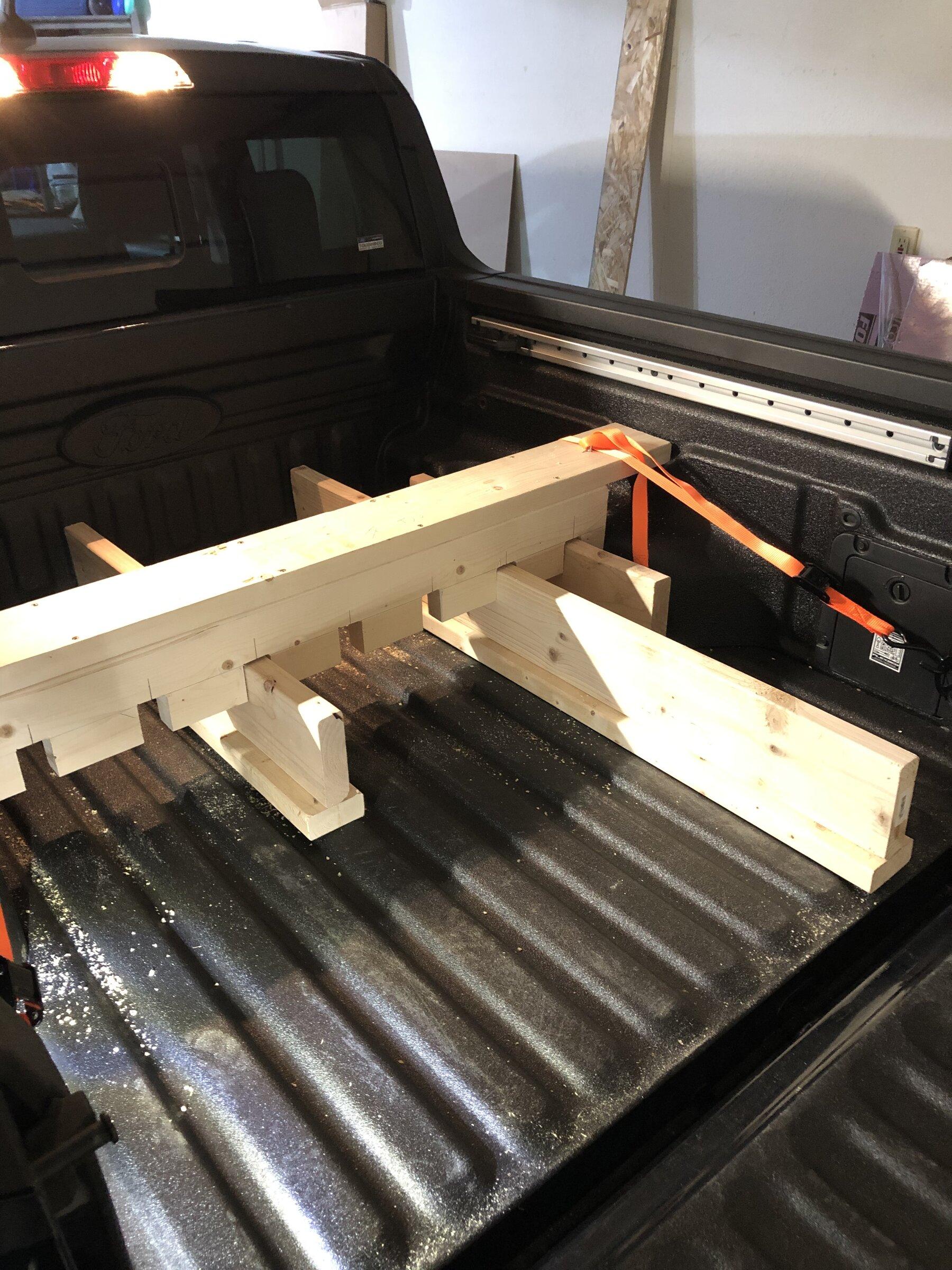

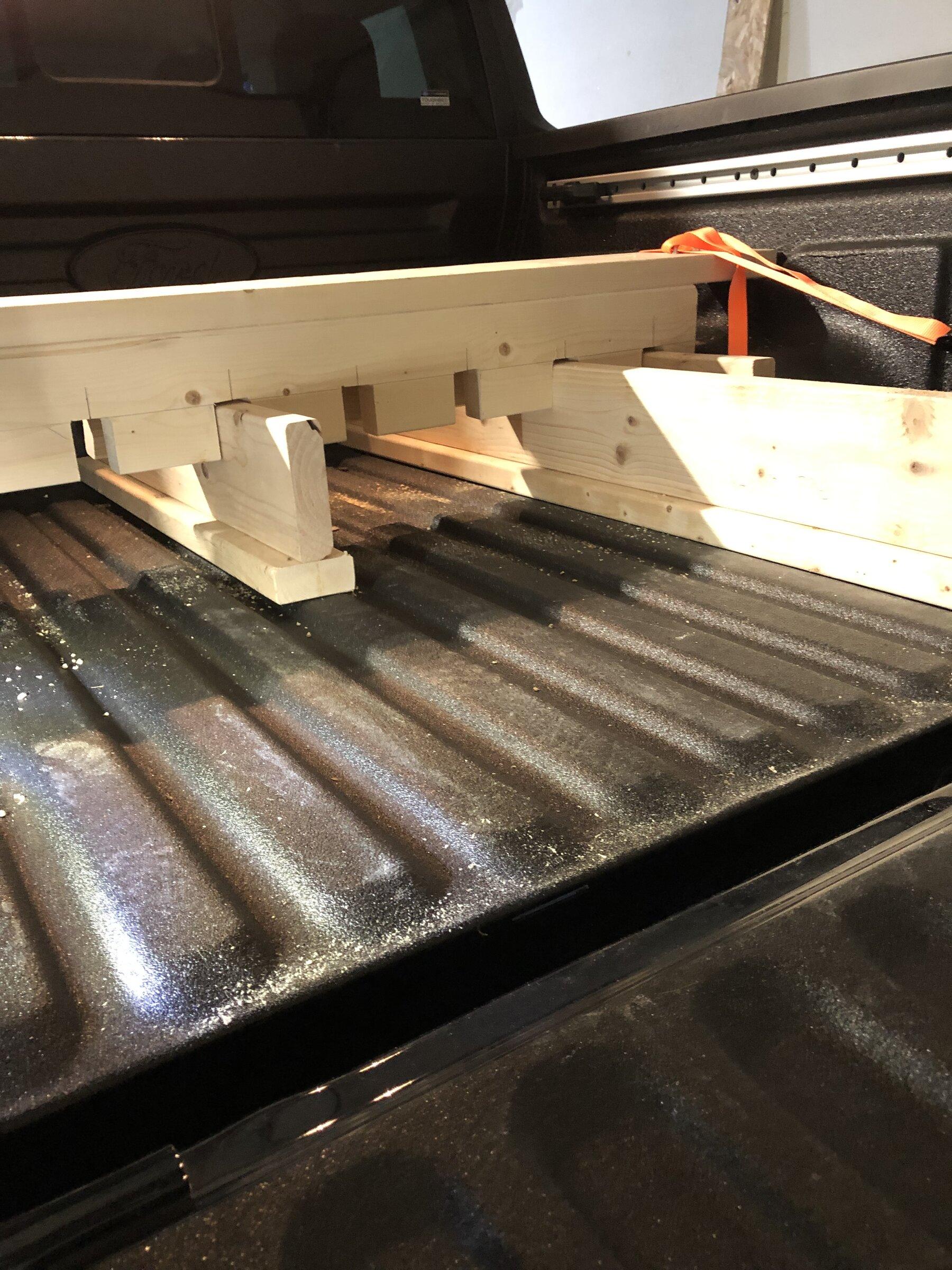

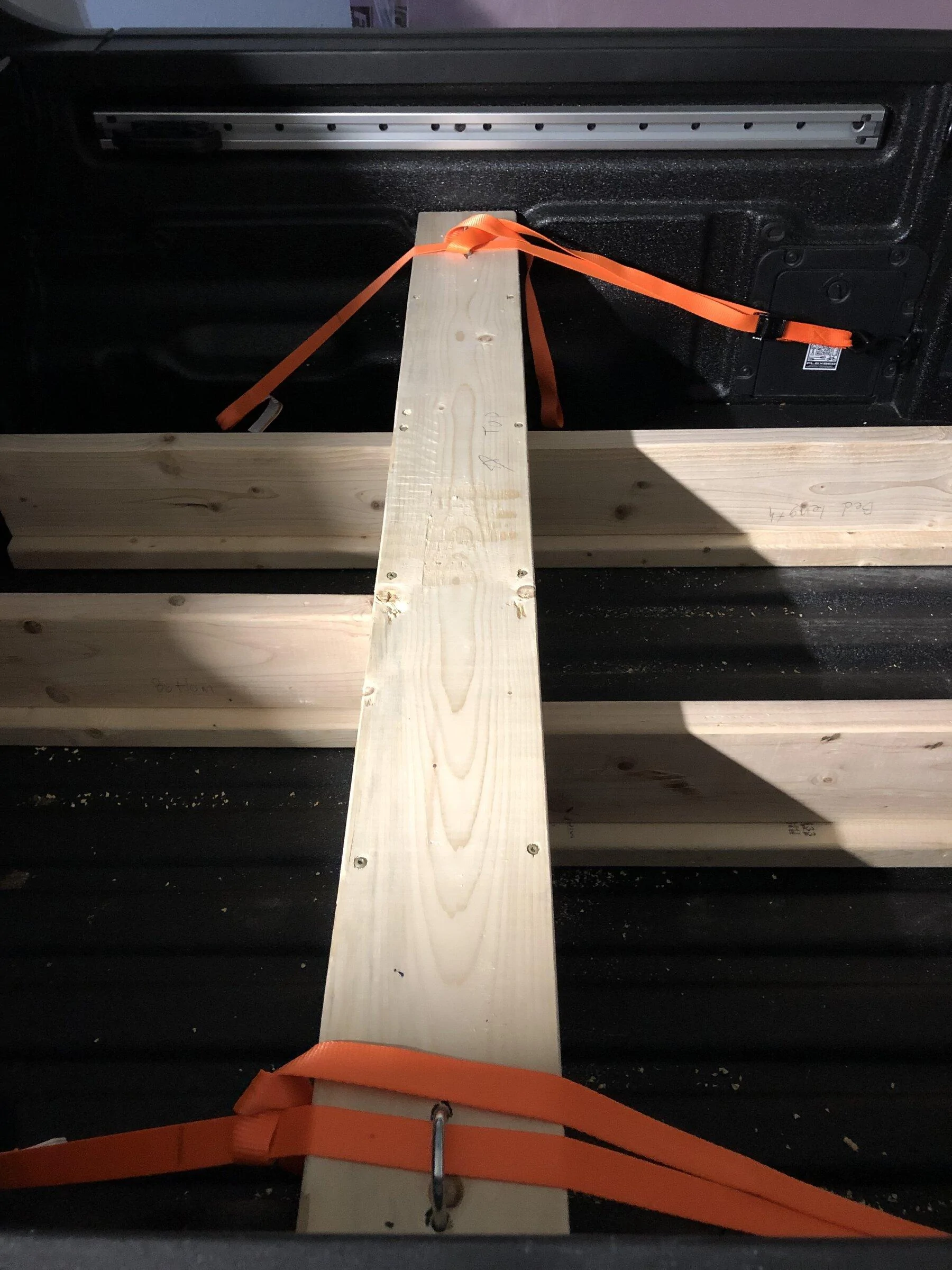

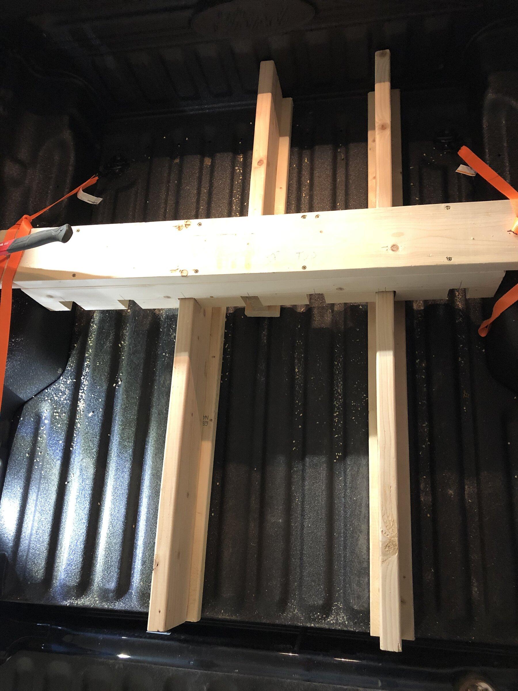

Decided a couple weeks ago I wanted to make a bed divider for my Maverick. I decided to make it with customizable sections. I screwed two pieces of 2x6 to the cross bed 2x6 then notched the vertical pieces every 6 inches from the center. I then attached other 2x6 pieces to same length 2x4s to make the dividers. I made 3 dividers, one that’s bed length, and two others that fit the length of either side of cross bed 2x6. I’m not an experienced wood worker so I need to work on the notches to have the dividers go in smoothly but that’s easy enough. Photos included to help my description.

Very interesting. Im curious why you didnt use the natural floor grooves?

If I’m honest, I didn’t think about it. If want to sound like I knew what I was doing, I wanted them elevated to keep them out of any water that would be in the grooves if they weren’t draining for some reason. Lol

What are the lengths of the 2x6 going across? cant seem to find that measurement anywhere.

I read some thread on here that said it was 54 1/4 inches which is what I cut it to and it works, but if I were cutting it again I’d leave it a tiny bit longer then maybe do a trim cut.

What do you plan to do with these dividers/divisions?

I’m going to use them to help keep stuff from bouncing around in the bed that isn’t big enough to strap down. I also put D-rings on the dividers to use bungee cords to hold stuff down.

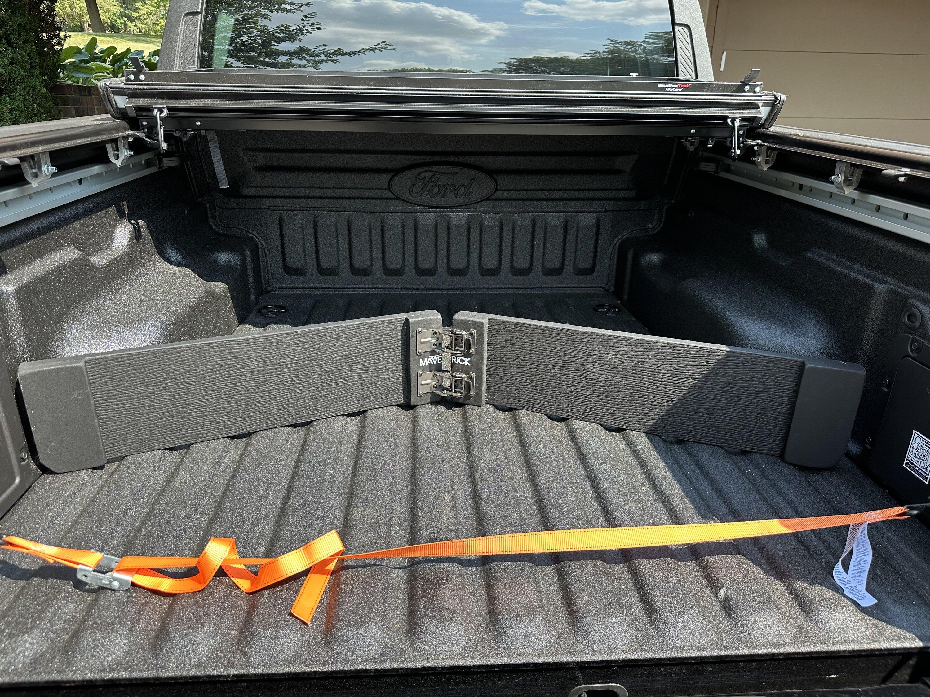

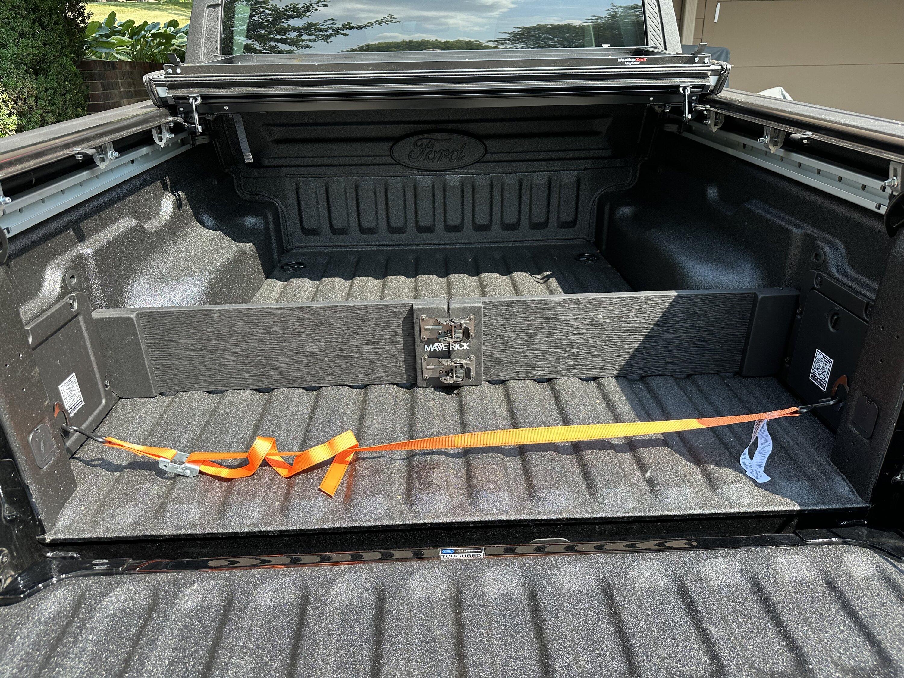

I did this DIY divider in 3/4” PVC and two hinge latches. I painted it with SIBL from a rattle can. 54 1/4 “ is right on with a SIBL in place.
