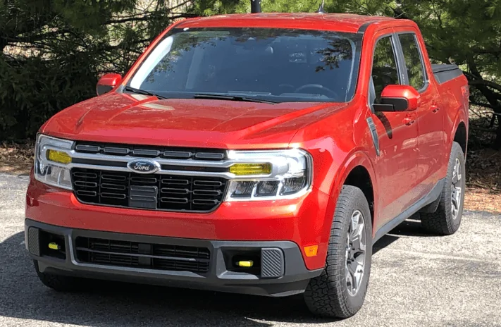

I received my @Diode Dynamics fog lights last weekend but just barely had time to install them.
Install was a piece of cake and took me about 4 hours. The video instructions are exceptional.
HIGHLY recommend this upgrade for all Maverick owners. Light output is fantastic. It took a little creativity to get the light where I wanted it because I'm so low, but man does it light up my street!
Definitely phone a friend to help you hold the bumper. I thought, "I'm a bad ass, I can do it." The bumper promptly got away from me and this lip tore. Auto body grade exopy to the rescue.
My multi-tool worked GREAT for making straight cuts and tight corners.
Headlights and fogs lights on.
Headlights on, fog lights off. Fogs have a neat ambient marker light built in when they're switched off.

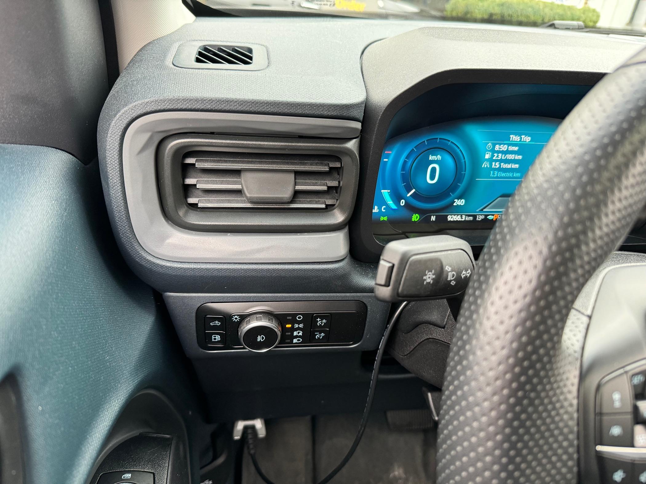

I'd like to see how people are setting it up inside for switching on/off.
The kit comes with a roughly 5/8" on/off switch with an LED. I mounted mine directly below my headlight switch.

Nice job OP, your Mav looks great!
Have you considered yellow tint film for your front turn signals? I think it would look sharp with your current setup.
https://www.mavericktruckclub.com/f...ellow-tint-for-front-turn-signal-light.44532/
The yellow fogs were a pretty big stretch for me.

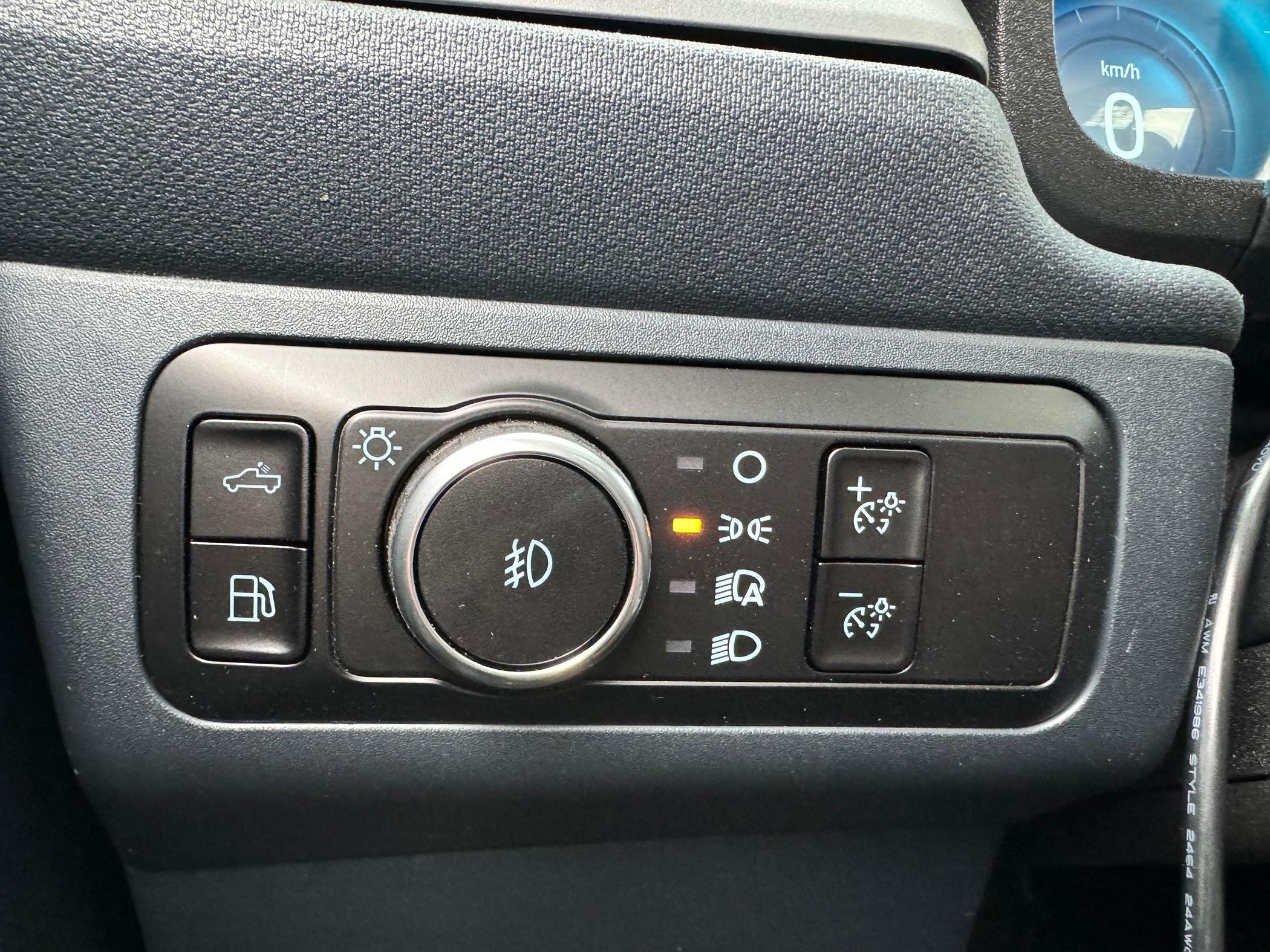

I used @Vtec87pr1 (Antonio’s) write up. He’s been able to make the factory F150 switch work with the Diode Dynamic fog light harness. If you have a hybrid there is a switch for you as well.
https://www.mavericktruckclub.com/f...wire-harness-installed-in-maverick-diy.26541/
I wish I had remembered his work before I cut my dash. Oh well, I can always buy a switch and replace the panel.
