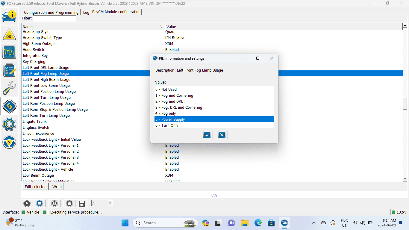

Had it all wired up but the switch using included wiring but it wasn’t working. 🤔
Changed front fog (#6 BMC terminal) to fog from power supply works amazingly
Ford Maverick Diode Dynamics fog lights installed! IMG_2052
