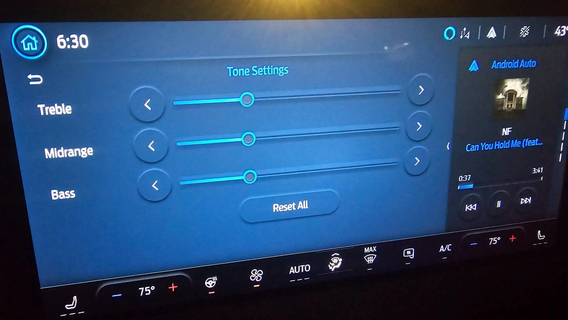

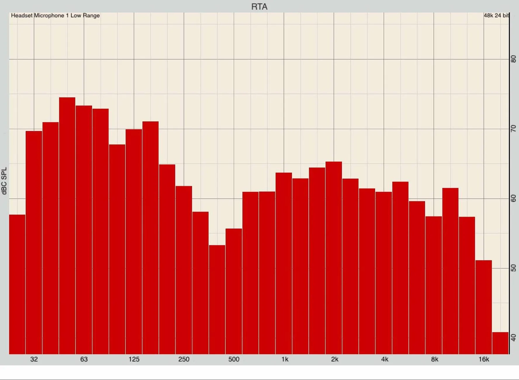

RTA via Dayton imm6 mic and audio tools on iPad. Pink noise played via Bluetooth from Samsung s23 ultra. Volume around 15.

looks like same 35hz high pass on the 6x9 sub which is not surprising.
big hole in the mid-range looks like 300 to 600hz

I think that midrange hole is a vehicle and speaker placement issue. I have a similar dip with an Audison tuned DSP setup in my 23 with Hertz cento pro components up front.

What does this show? And why do you not use wire, Bluetooth is bad for audio correct

The RTA curve shows the frequency response of the audio in the vehicle. This shows that B&O got it pretty close to the standard harman audio listening curve (minus that dip at 300-600hz).
I actually tied using a USB stick with the file, but the sync system would not show it as a source. If I plug the phone via USB, it automatically goes to Android Auto, and Bluetooth and Android Auto are fairly similar (both worse than wired).

Is that a good thing? Is Harmon a brand or a standard in audio tuning or something

looks like a typo that should've been 'human'.
The "Harman Curve" is the product of research by Harman Kardon audio company on the preferred frequency response curve of average listeners.
