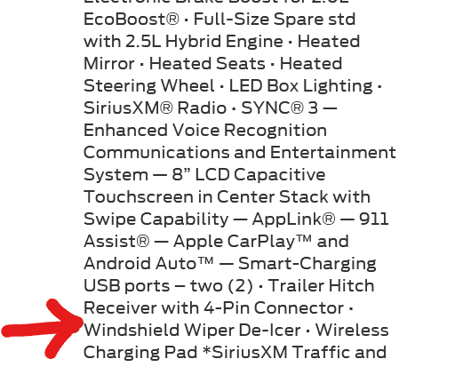

I know there was talk of it being removed, along with the keypad, but my tracker still shows the Lariat Luxury Package as including the following:

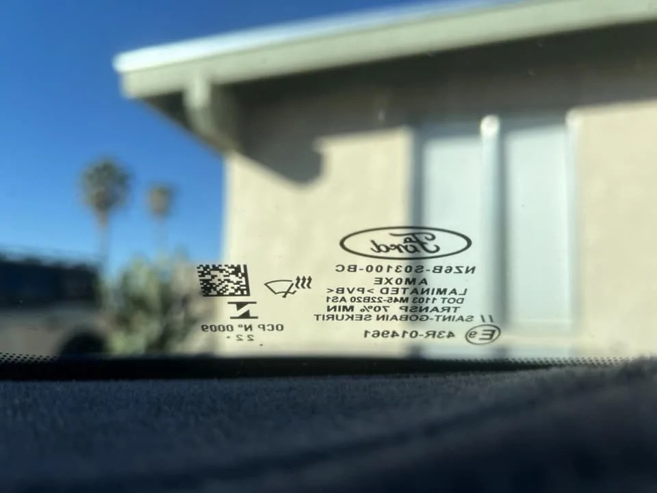

Does anyone have a 2024 Lariat that can determine if it is still there or not? Someone in a FB group posted the picture of their windshield showing that it was heated, but I think they had a 2023. Looks like it will be clear on the windshield label.
They did remove Windshield Wiper DeIcer from the Luxury Packages. Windshield has nothing to do with the Wiper DeIcers. The windshield in the picture is for the Laminated Glass not heated windshield.
Now I'm confused. Tim is my go-to source. BUT, my 2023 Lariat Lux has the sympol that looks like heat on its laminated windshield, but my 2024 Lariat (Lux) has a laminated windshield but does not have the symbol. I assumed that icon WAS the heated stripe.
Hot Runr Guy
Terry
Apr 27, 2021
101
4,258
7,907
West Chicago, IL
I respectfully disagree with Tim. This IS the symbol for the heated windshield, also not present on my MY24 Lariat (w/lux).
